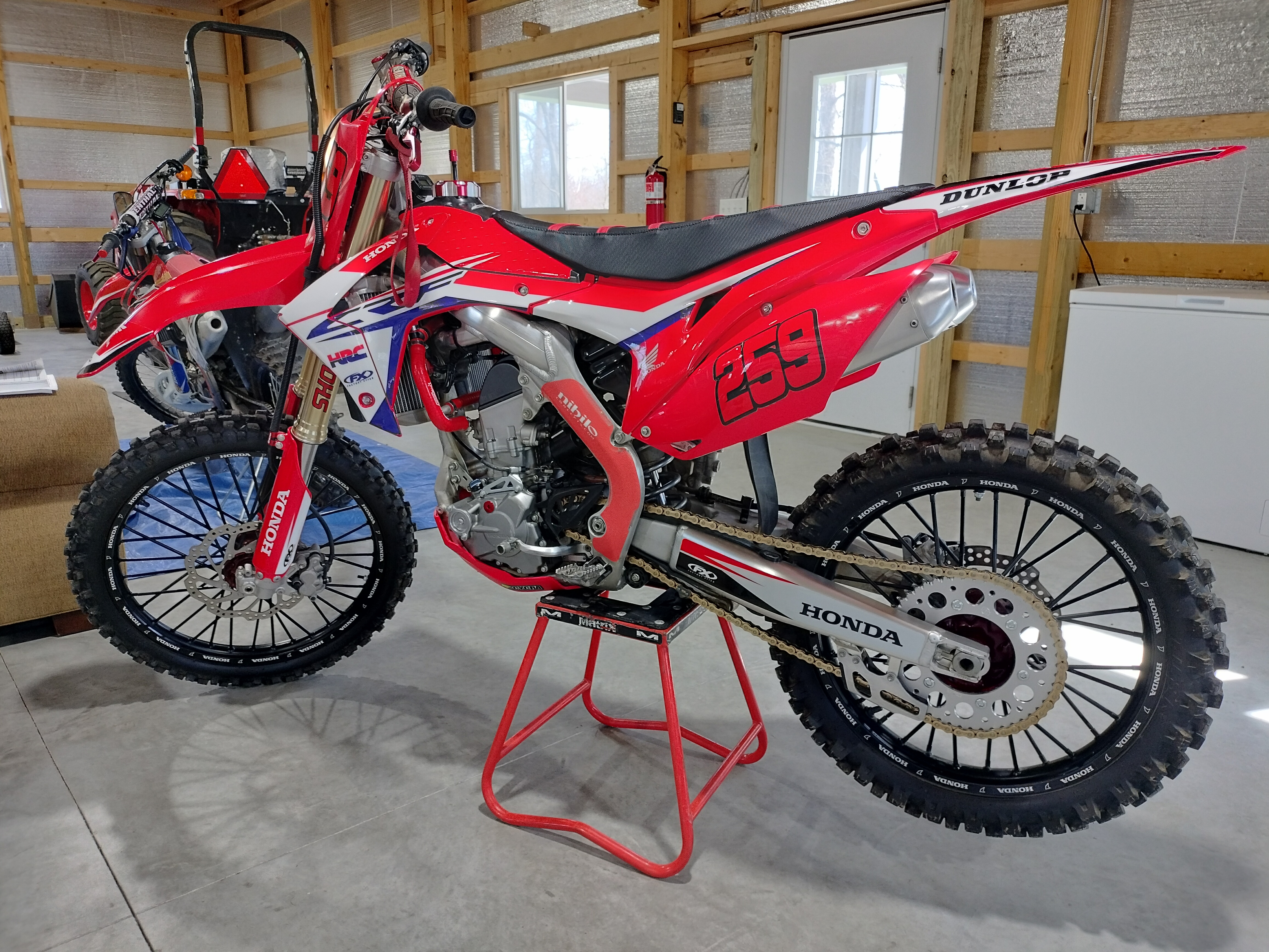

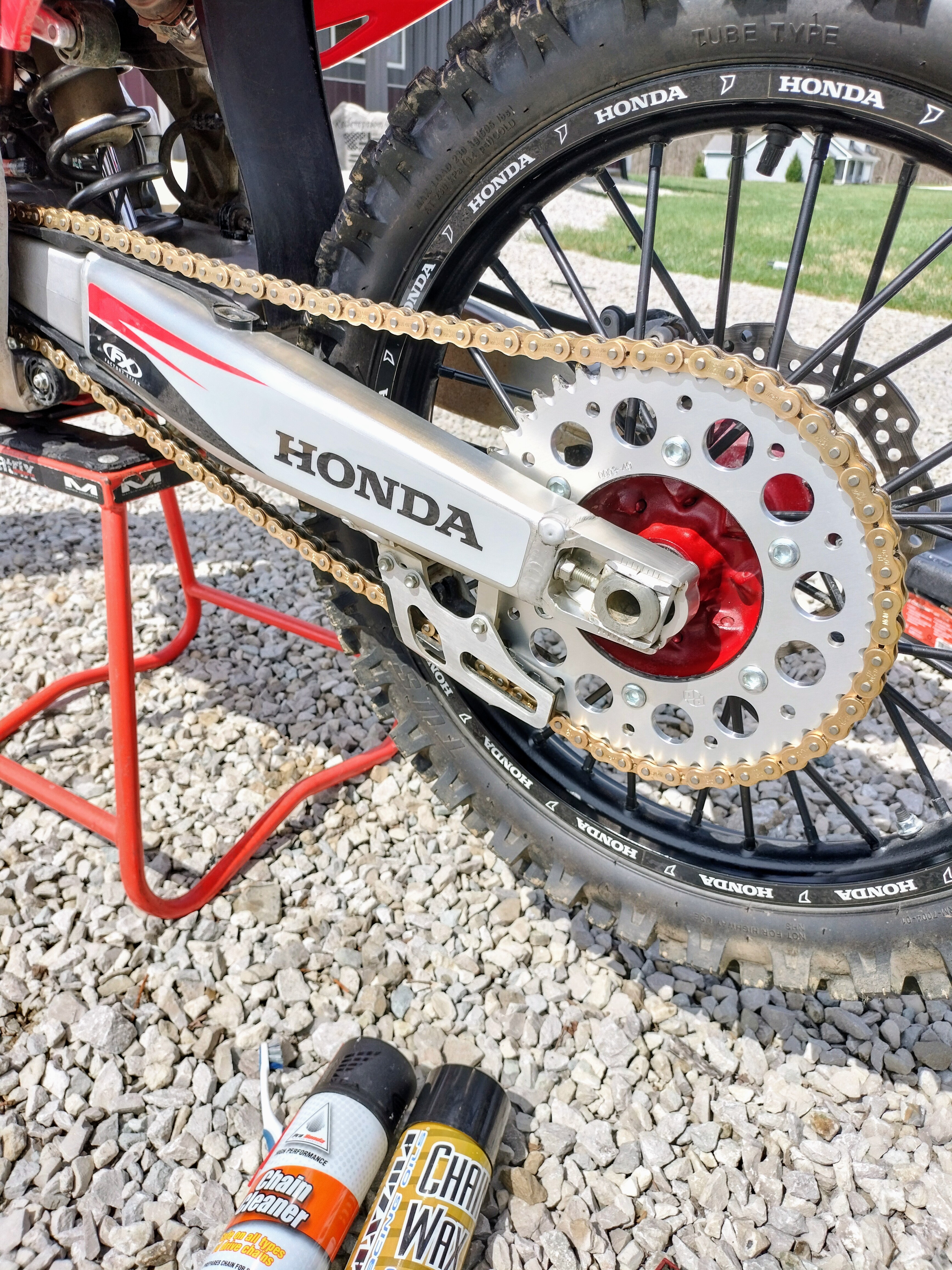

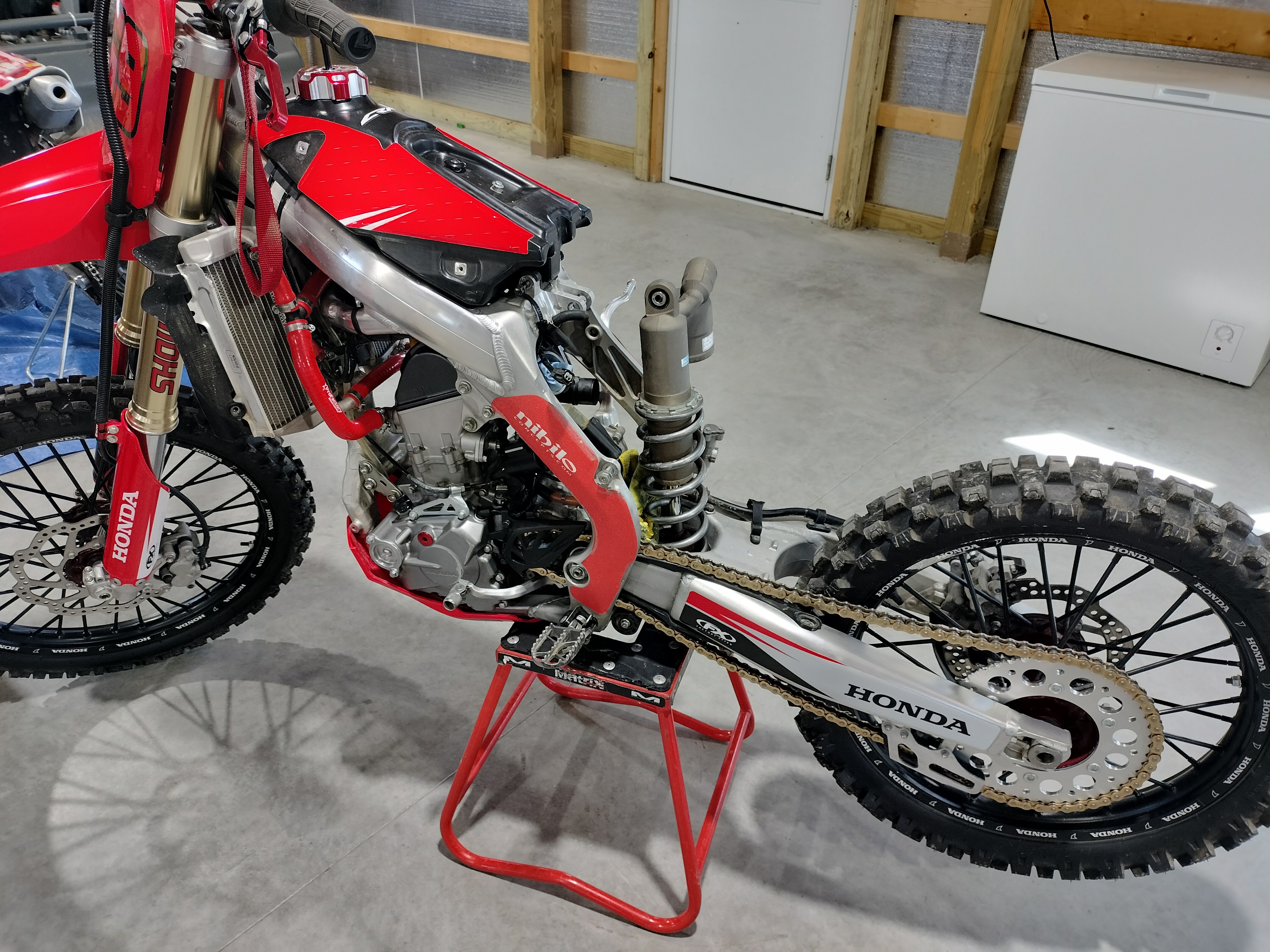

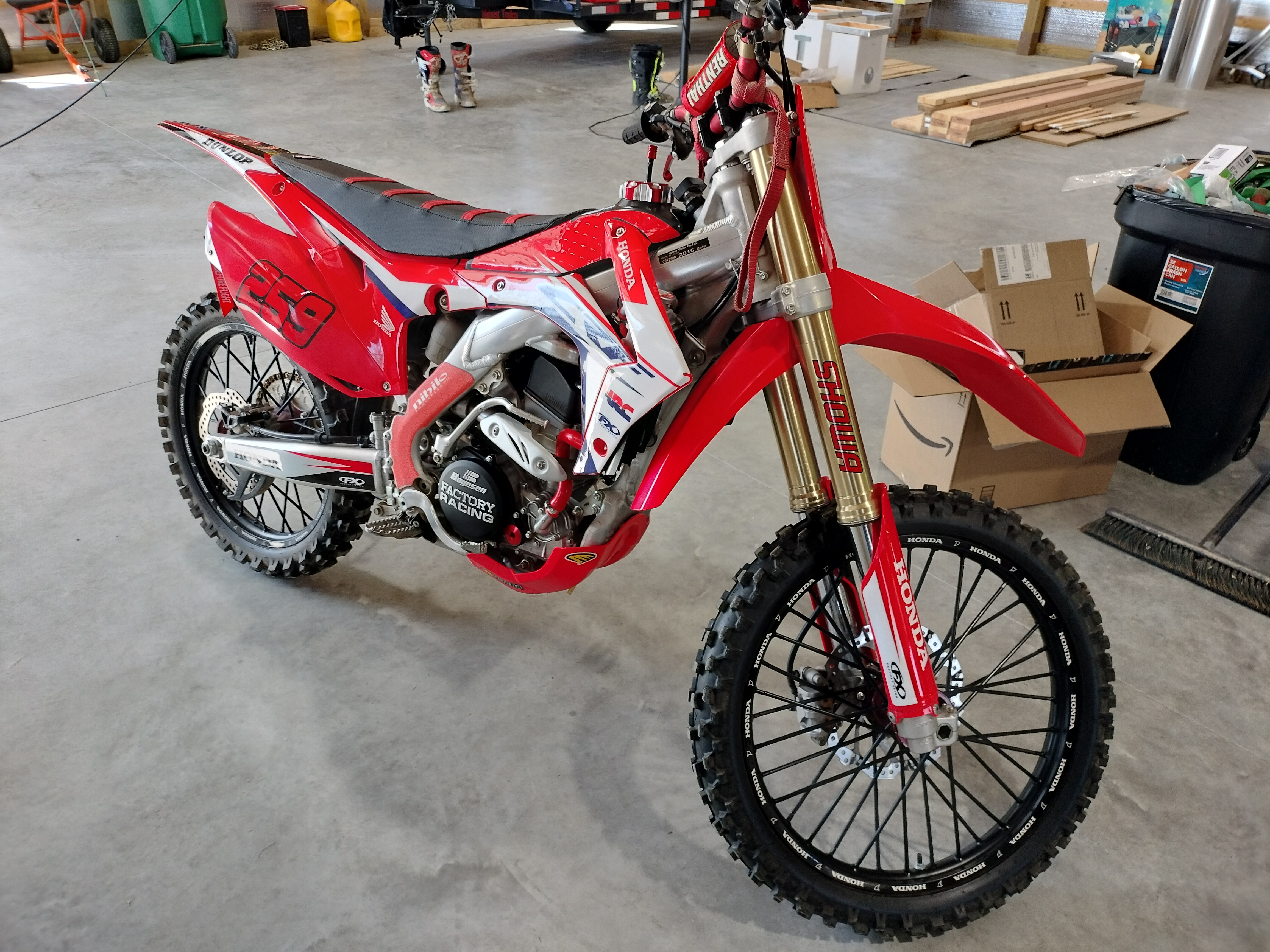

Oil changes, air filter cleaning, chain cleaning and lube... Can't wait for the next run to the park.

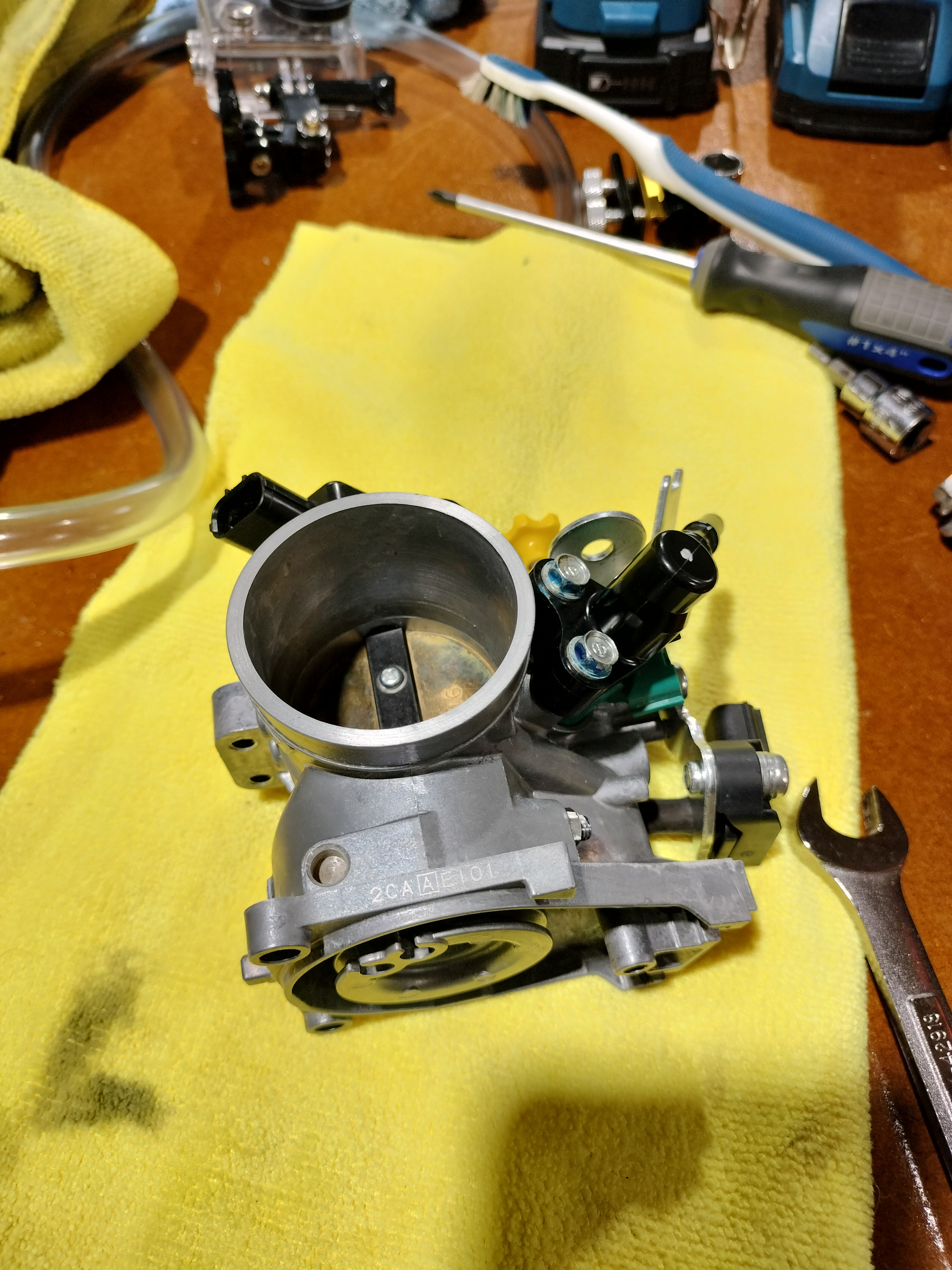

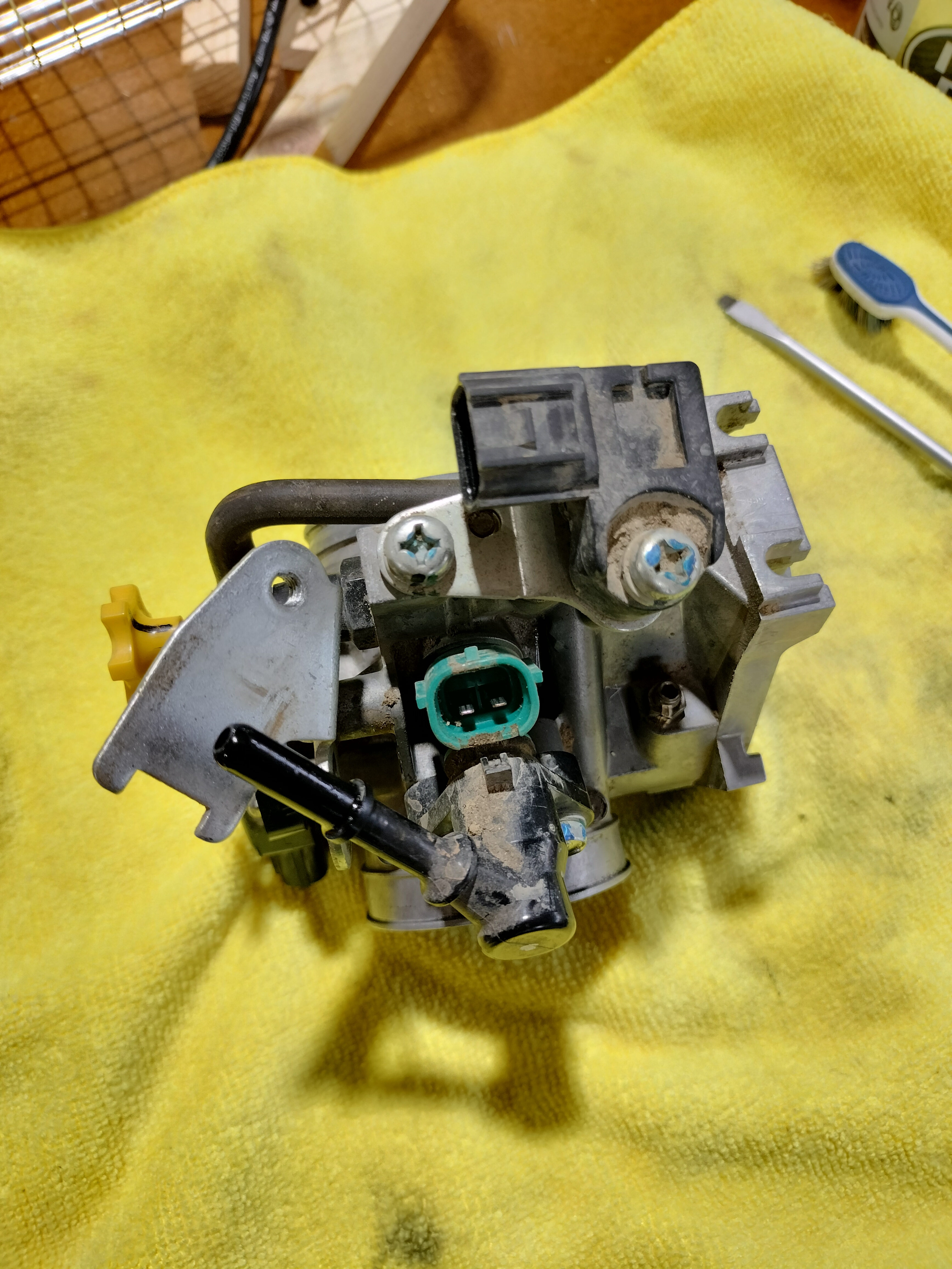

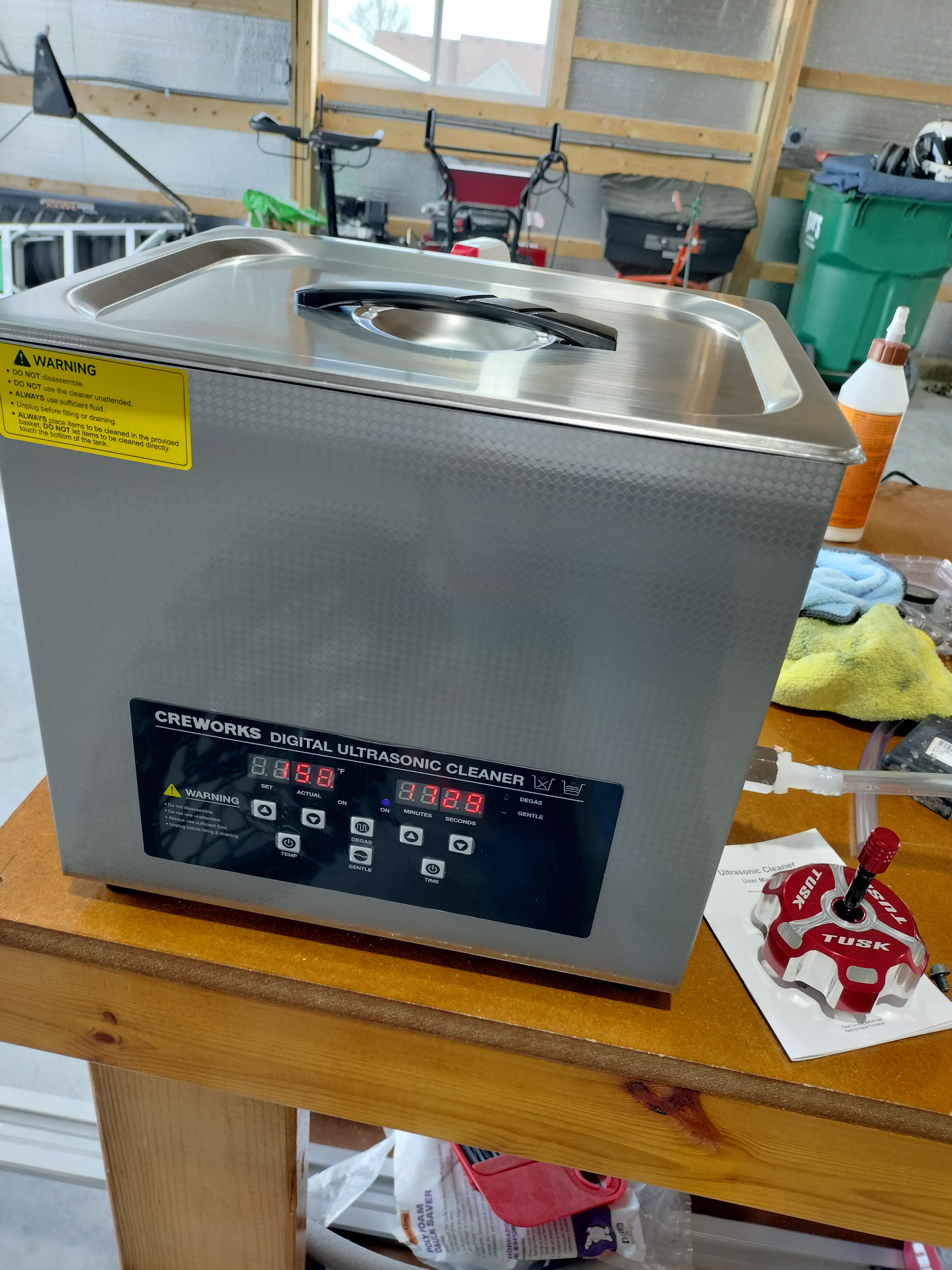

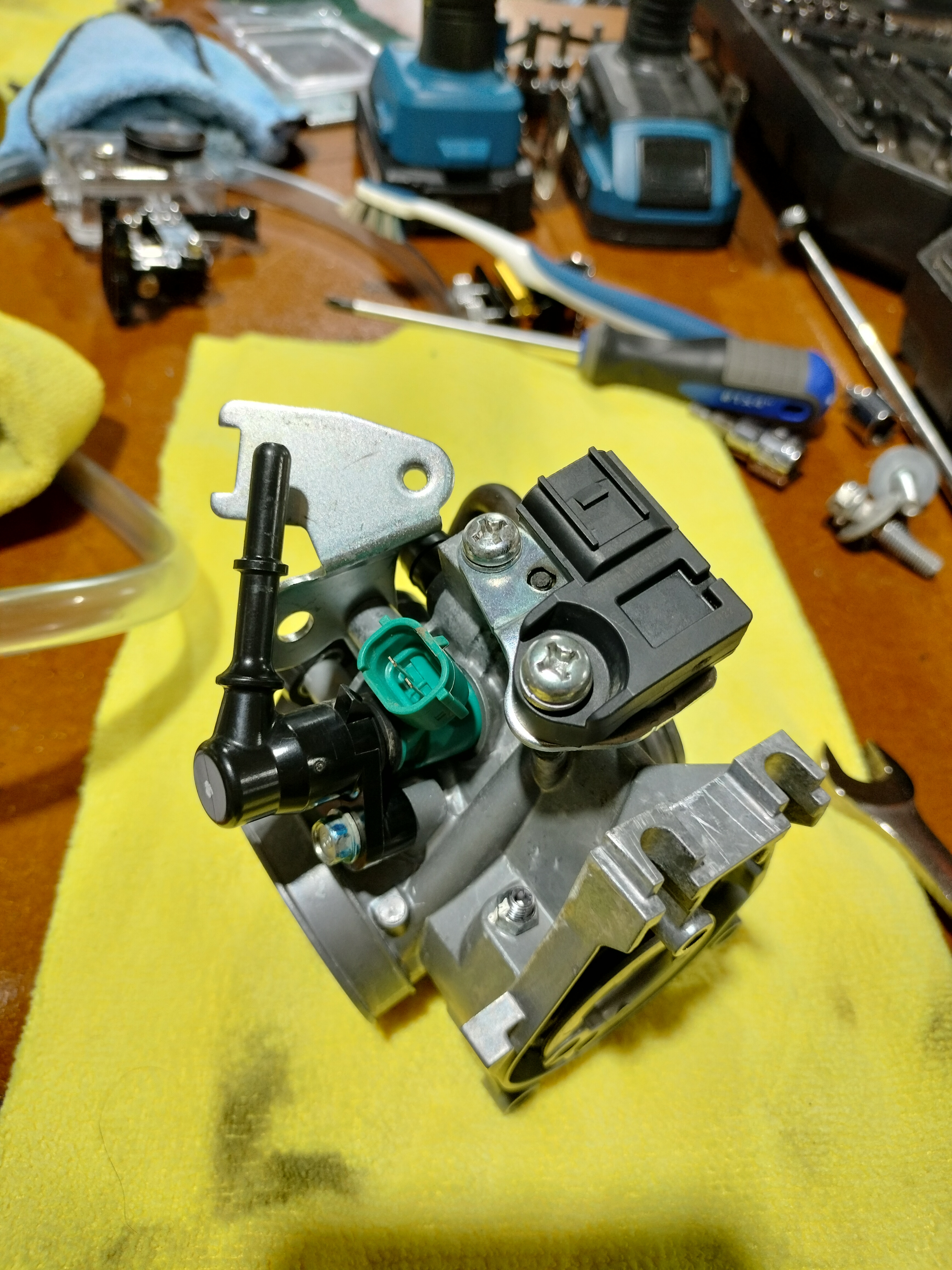

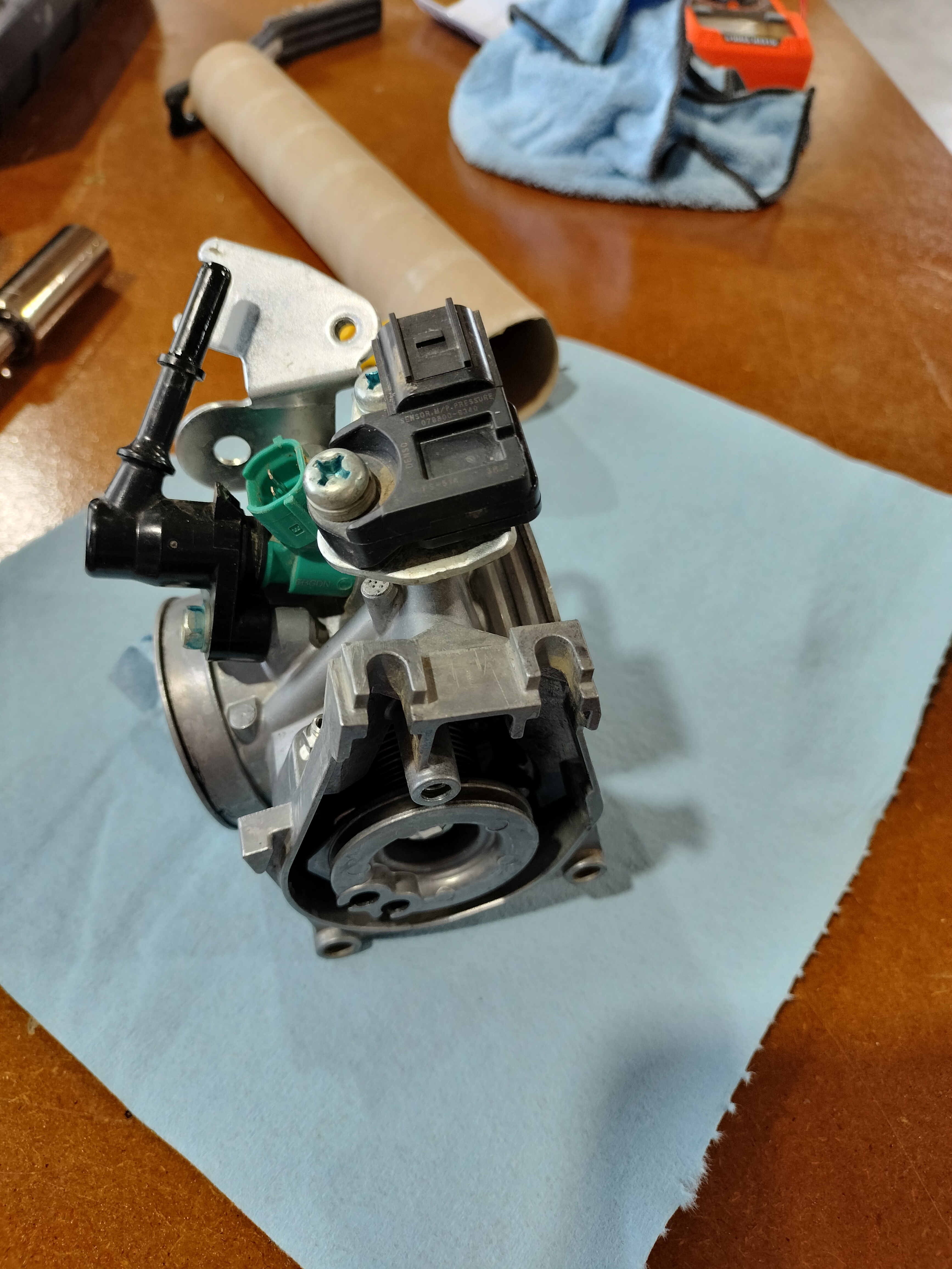

This bike has never started easy. Had issues with it not wanting to set an idle between 1200-1800... And if you did see the idle higher, it would hang when you closed the throttle. The high idle circuit also never worked right. Well, I fixed that. I've tried throttle body cleaner, compressed air... But an hour in the ultrasonic at 165F did the trick. Starts second kick, I can set any idle I want with 50rpm increments and the high idle circuit works!
