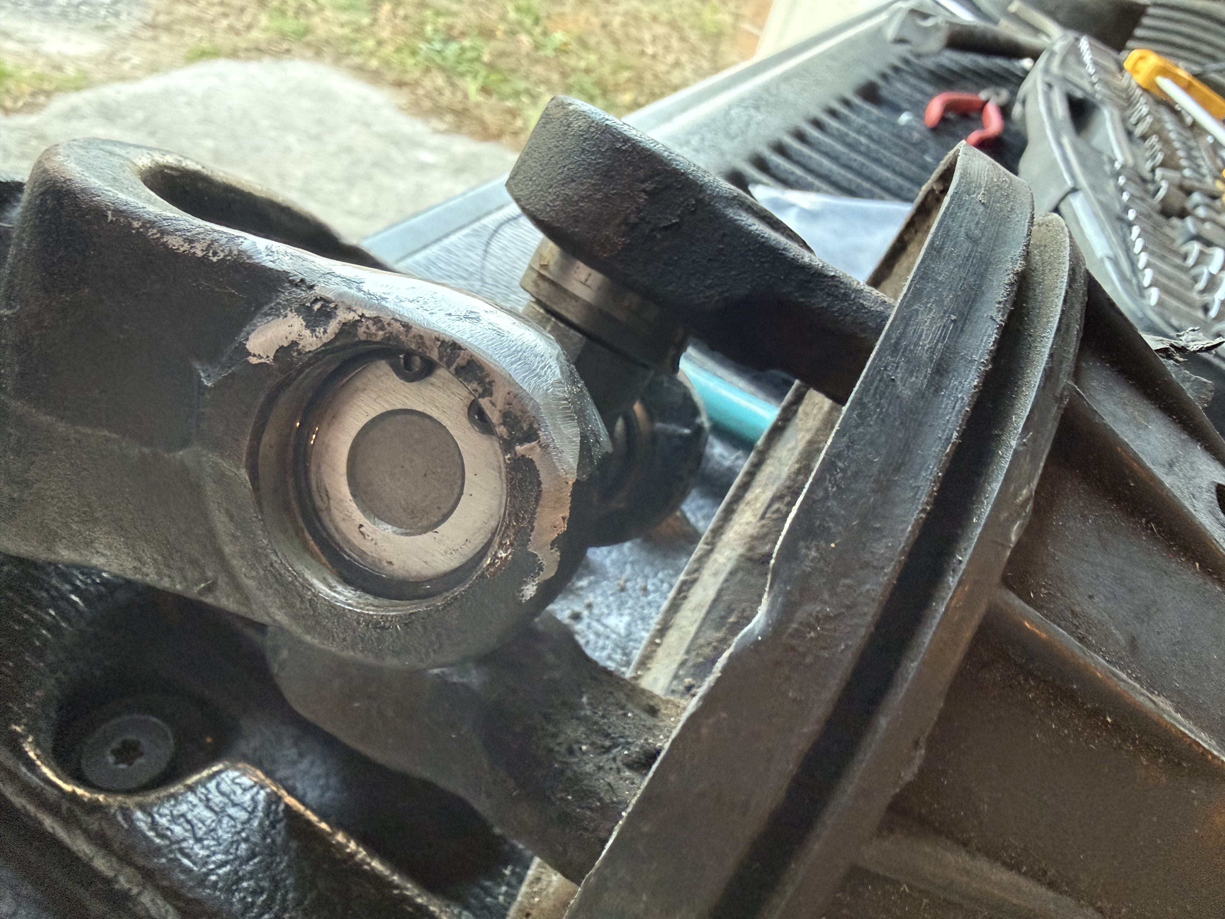

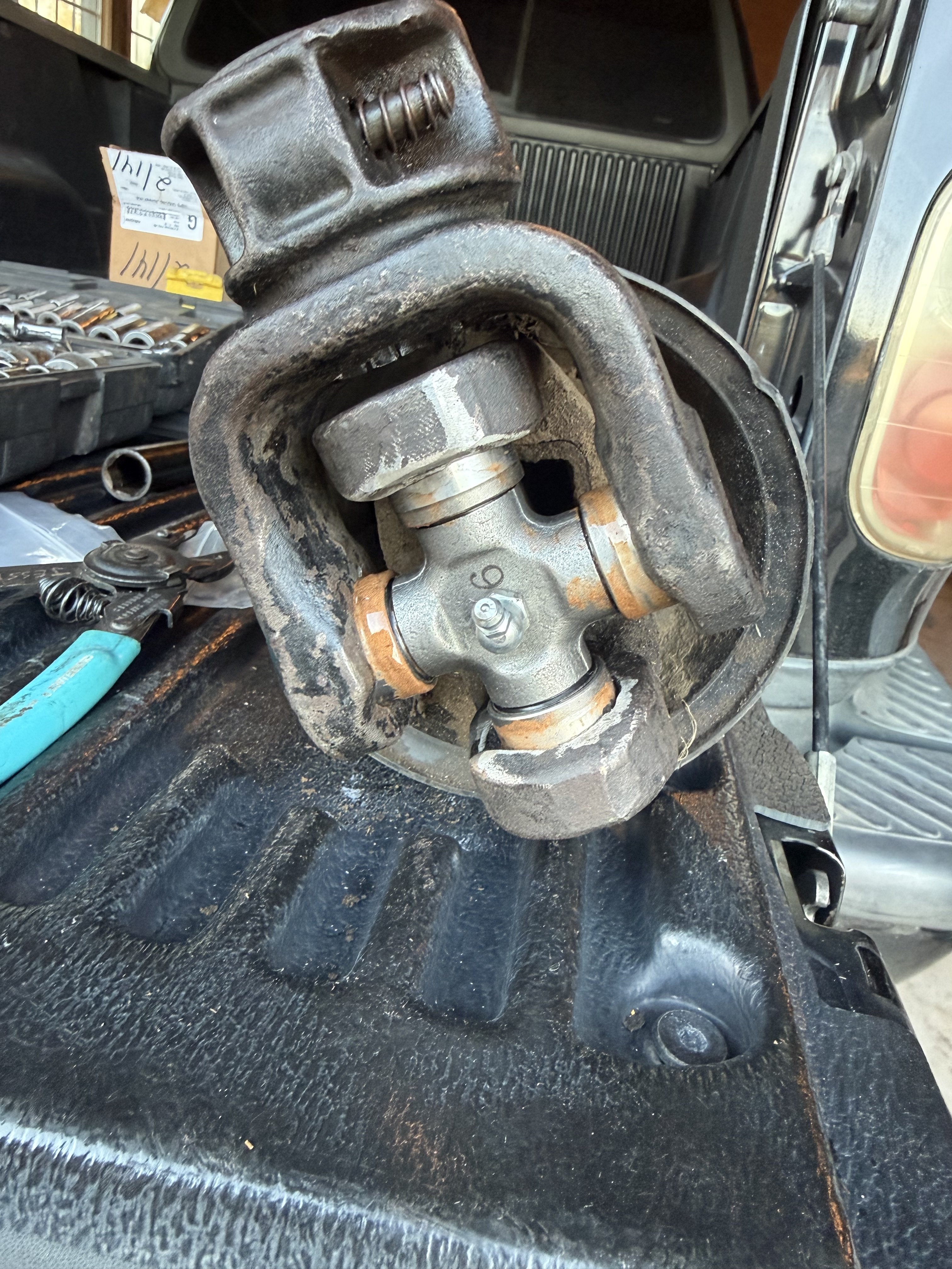

The cross joint on my bush hog came apart the other day. I noticed the vibration, but before I could hit the PTO Kill switch, it came apart on me. I’ve never built one of these before, but I knew that they had kids to do so. I cleaned up the sleeves for the bearings in the yoke and on the driveshaft and when I replaced them, I realized how how little material was contacting the bearings. I’ve never noticed this before, but rebuilding the thing I noticed it now. Looking at other examples it seems common for the yoke and driveshaft connection point that connects to the PTO on the tractor to have these thin of walls on the castings l, and I’m wondering why they need these thin walls on the castings, and why they use bearings that are mostly unsupported? You would think they'd invent a cross joint that doesn't have so much bearing material exposed. There are spots that are likely only contacting the bearings for a 1/4 inch or so when you account for the snap rings.

Wrong cross-too small I bet
Let’s see the outside, where the snap ring is.

It very much looks like this. See how thin this is up top.?

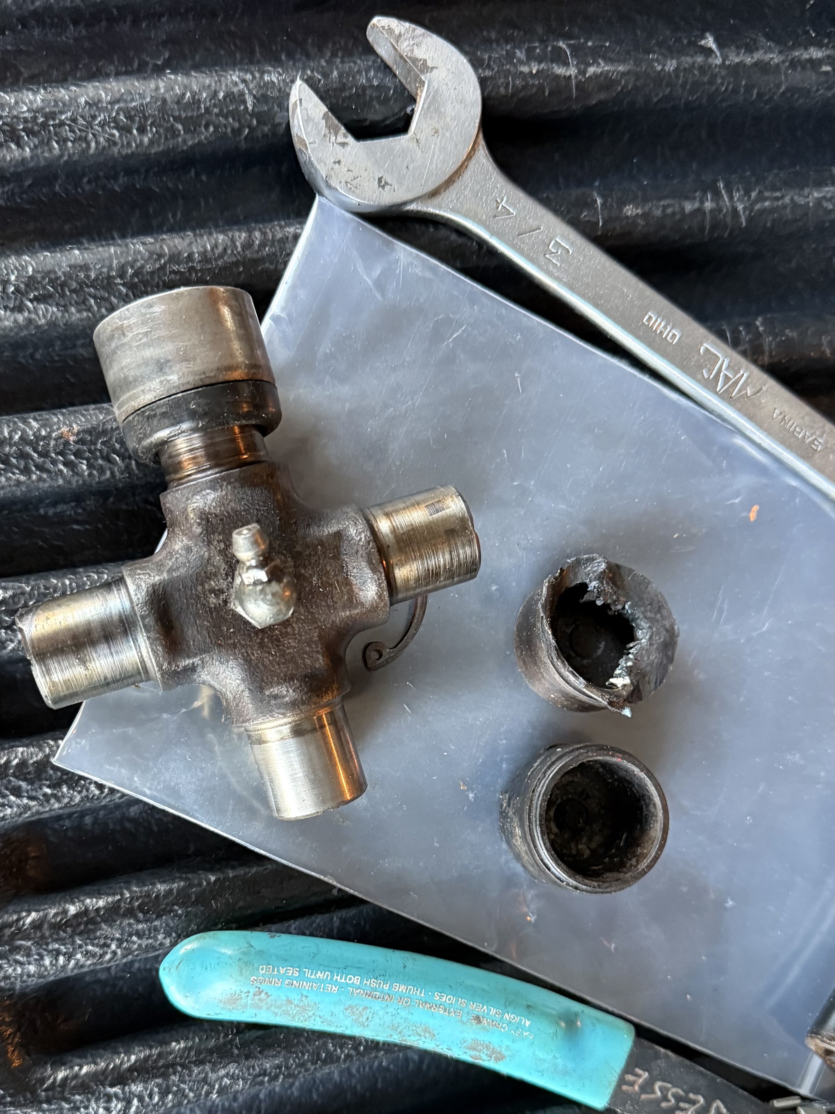

Also going off the lists of availability Cross joints it's the only one that will fit. This is a Series #6. 30.2MM bearing diameter, and 92MM overall length. IDK the new joint looks the same as the old OE joint other than the seals are a little different designs.
Here's a picture of a snap ring, and what I have of the old cross joint that came apart.

Way too recessed, IMO. Do all 4 caps have the same recessed depth?
Is the yoke “splayed” open?
Do you cut a lot of excessively (edit) steep angles , like where you can here the yokes slappin?
Somethings not right.
I’d call Maugansville AG and send them a couple pics of what you have.
If they can’t fix it, nobody can.
If that’s the way it was built from factory, I’d be thinking about a whole new assembly of yokes and U-joints on your driveshaft

Yes it is fairly recessed, but I think it looks recessed more in the picture than it does in person. No it's not splayed. It's just casted this way. If it was even possible for this thing to work at a 90* angle it looks like it would have the clearance for it. My dad bought this cutter new probably 20 years ago, and this is the factory yoke and driveshaft. It's a 7' Howse.

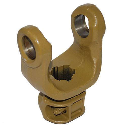

This yoke is the same series 6 as the one I have and could be used in it's place.

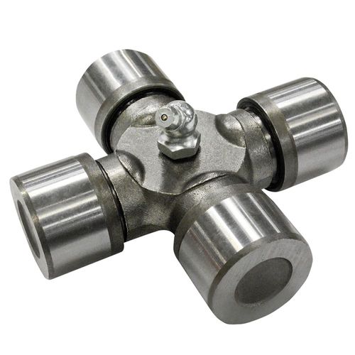

Here's a cross joint to fit it that looks very similar to the one I bought.

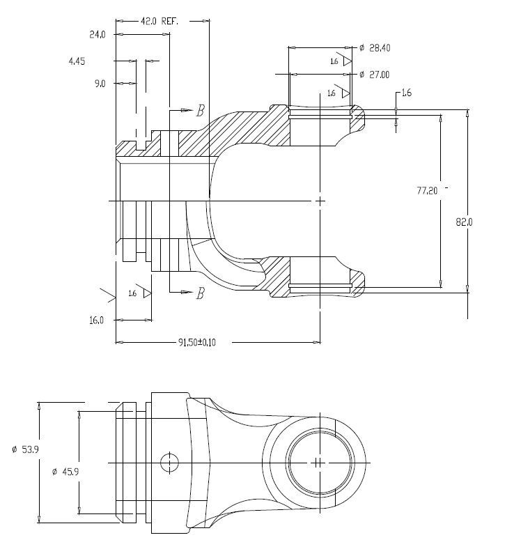

This picture is of a Series 4 yoke, where mine is a Series 6, so the size is different, but the basic shape is the same, and it gives you an idea of what it looks like from a section view.
I'm wondering if I had lost a snap ring and it took a will for the bearing to come out. It looked like it hadn't had anything in it for a while based off buildup and corrosion, but IDK for sure.
I don't use it at any weird angles.
BTW the other end with the clutch that mounts to the gearbox has a bigger/beefier looking cross joint, but I haven't taken it apart to check for sure.

I wonder if you got a series 5 mismarked as series 6? They both share the same ID of cap (30.2mm), however a series 5 is 79.4 mm cap to cap and a series 6 is 92mm cap to cap.

The cross joint is in there with little slop or side movement. It's not tight, but not sloppy loose either. I just don't understand why there's so much bearing surface not being used. We've cut 3.5"+ trees with this cutter, and it's just surprising that a bush hog would use a yoke and driveshaft with such little bearing contact, on implements that take such a heavy load as a bush hog has to handle. It's like this much clearance to achieve more articulation seems unnecessary for the angles the joint should experience, and that just wastes a bunch of surface area (overall strength in the joint) on the bearing surfaces and material thickness on the yoke and driveshaft. IDK, just seems oddly minimalistic for a HD PTO implement.

Don't know for sure but you stated the joint next to the gearbox appears larger than the one you are having issues with, is it possible someone gave you the wrong half of the drive shaft?
By the pictures you have posted it appears the cross is the wrong one for the yokes.

The yokes are not castings - they are steel forgings. Not to say they did not mix up forgings at the supplier. Think it through - everything assembled with proper clearances. The cross does not slop back and forth an excessive amount once assembled. The bearing cup is the real support for the needle bearing. I've attached a photo of an exemplar u-joint. The bearing cups are the hardened cases for the needles and provide the support. If the cross ws designed with more width so not as much bearing cup would be exposed, the needles would be shorter - higher load per needle. In short, the bearing cups are the real load carrying parts. The cross needs to be open to provide clearance. Your cutter is designd by a company that selects an off the shelf driveline rated for the load the cutter is designed. I don't see a proble with what you have realizing the bearing cup is the main load transfer. The machined cross is the shaft for the needles. The yoke is there to transfer load and if forged from the proper steel, is not really significant in how much of the bearing cup is supported as the bearing cup is the prime element - provided they don't get unreasonable.

Then the U joint does not properly fit the yoke. Change one or the other to correct the problem.
You either get another yoke so they both fit correctly or measure both and find the proper conversion u joint.

I respect your conclusions, but the amount of exposed cup on the inside of the yoke did look “unreasonable”, at least to me it did. In my memory, I have never seen a driveshaft with that little support on any of the 100+ machines with PTO shafts I have owned.
I’d be a lot more confident in a cross where the cups were a lot more immersed in the yoke.
My guess is Howse got a good deal on a large quantity of those driveshafts as long as they passed the specs they needed to operate their mowers.
