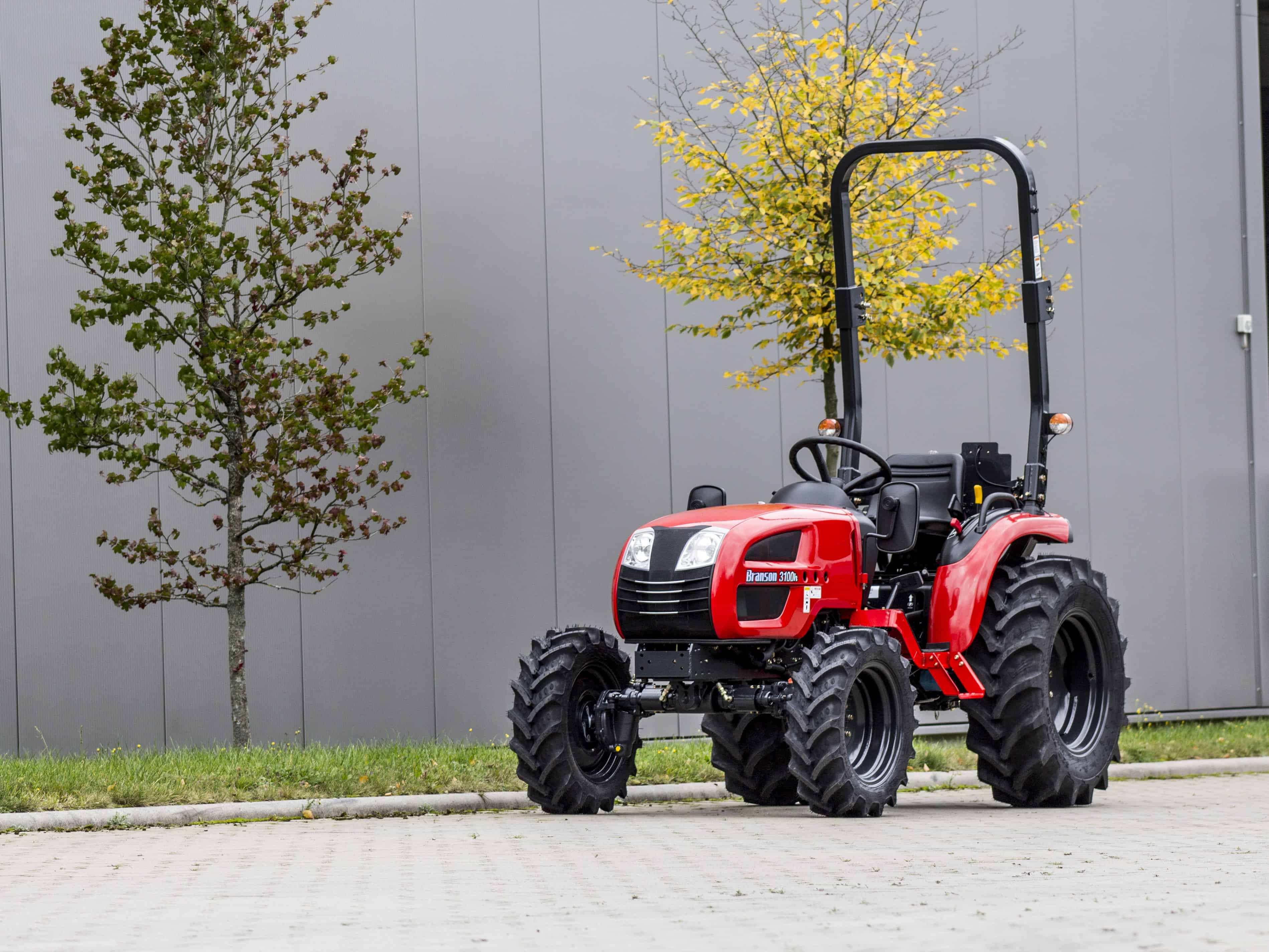

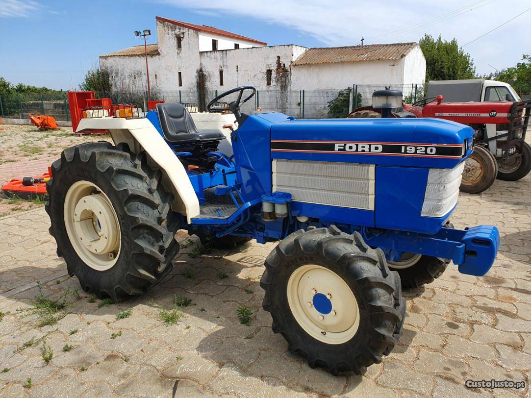

Yeah, all the way from SCUT to big Ag tractors:
4139894511-trator-kubota-b2650.jpgIMG_3735_1.jpg68315796_2377392749023026_5410897784884690944_o.jpg20374526_1438643492897961_6447293920238238525_n.jpg
   / Wider wheels/radials for M7040/M7060 Kubota now easier. FYI #49
The pic of the three Kubotas. That's what I'm talking about. Why the Heck don't ours come equipped like that?? What exactly would be the reason they don't???
   / Wider wheels/radials for M7040/M7060 Kubota now easier. FYI #50
I can't really answer that either but here is one for you:
