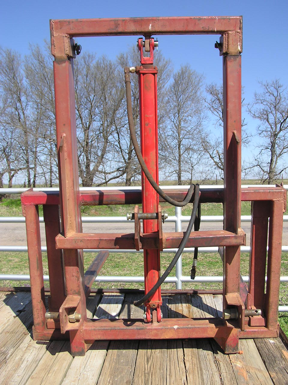

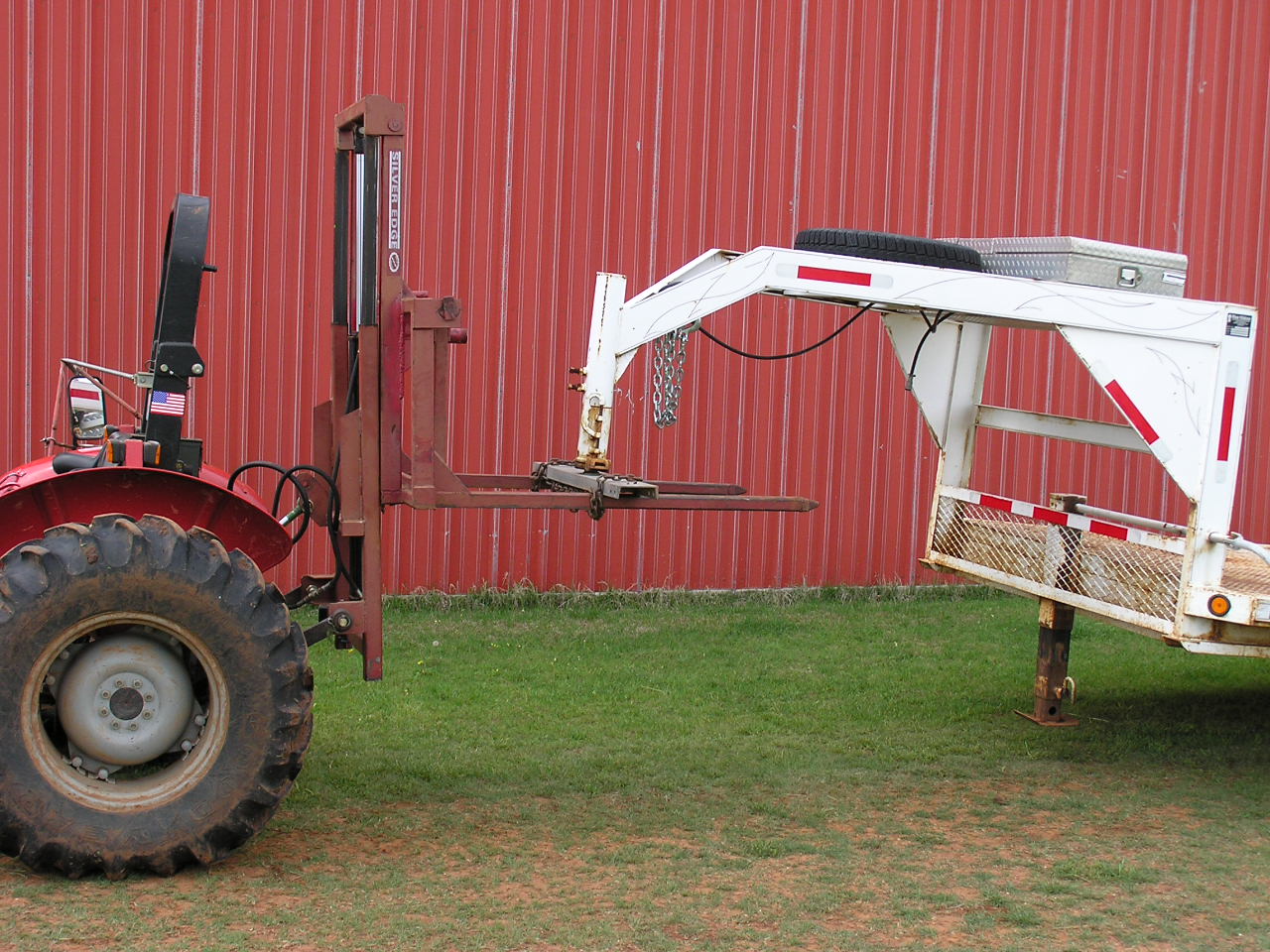

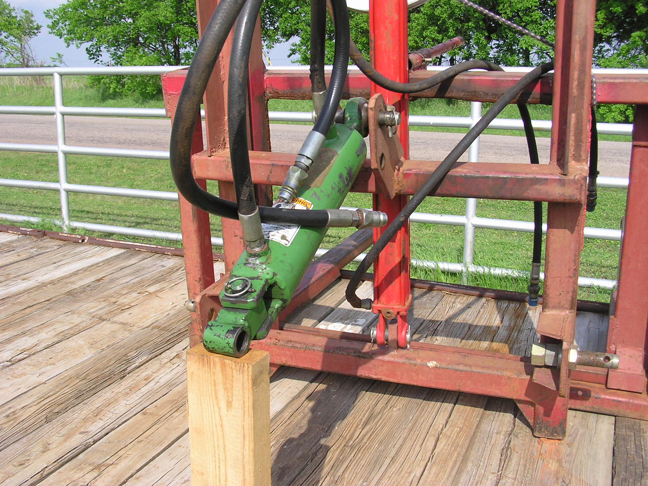

Many years ago I had a MF 240D with no loader. I found a 3 point fork lift attachment with a hydraulic top link.
It has to have the hydraulic top link to load or unload hay bales from a trailer.

You might also look into a 3 point forklift mast like xfaxman suggested for the M. That will be easier to move around on muddy ground with a heavy bale on board.
