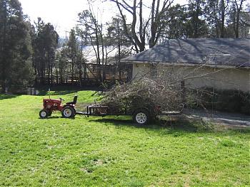

I've got somewhere between a 10 to 15 degree drop from my front to my back and I've not only handled it fine w/the BX hauling a 6 x12 trailer but also w/ my little ole 8hp gear drive Wheel Horse. I don't have a pic of my BX23 w/the trailer but heres a pic of my 856 Wheel Horse hauling a 900 lb 6 x12 trailer loaded w/ a couple hundred lbs of brush. That little ole thing hardly grunted :D and neither did the BX23 in low

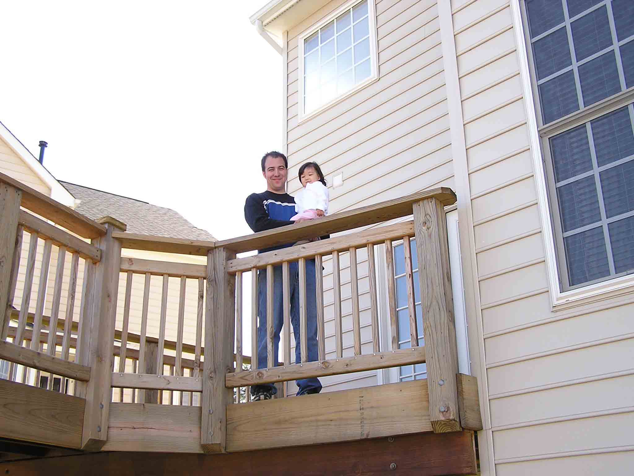

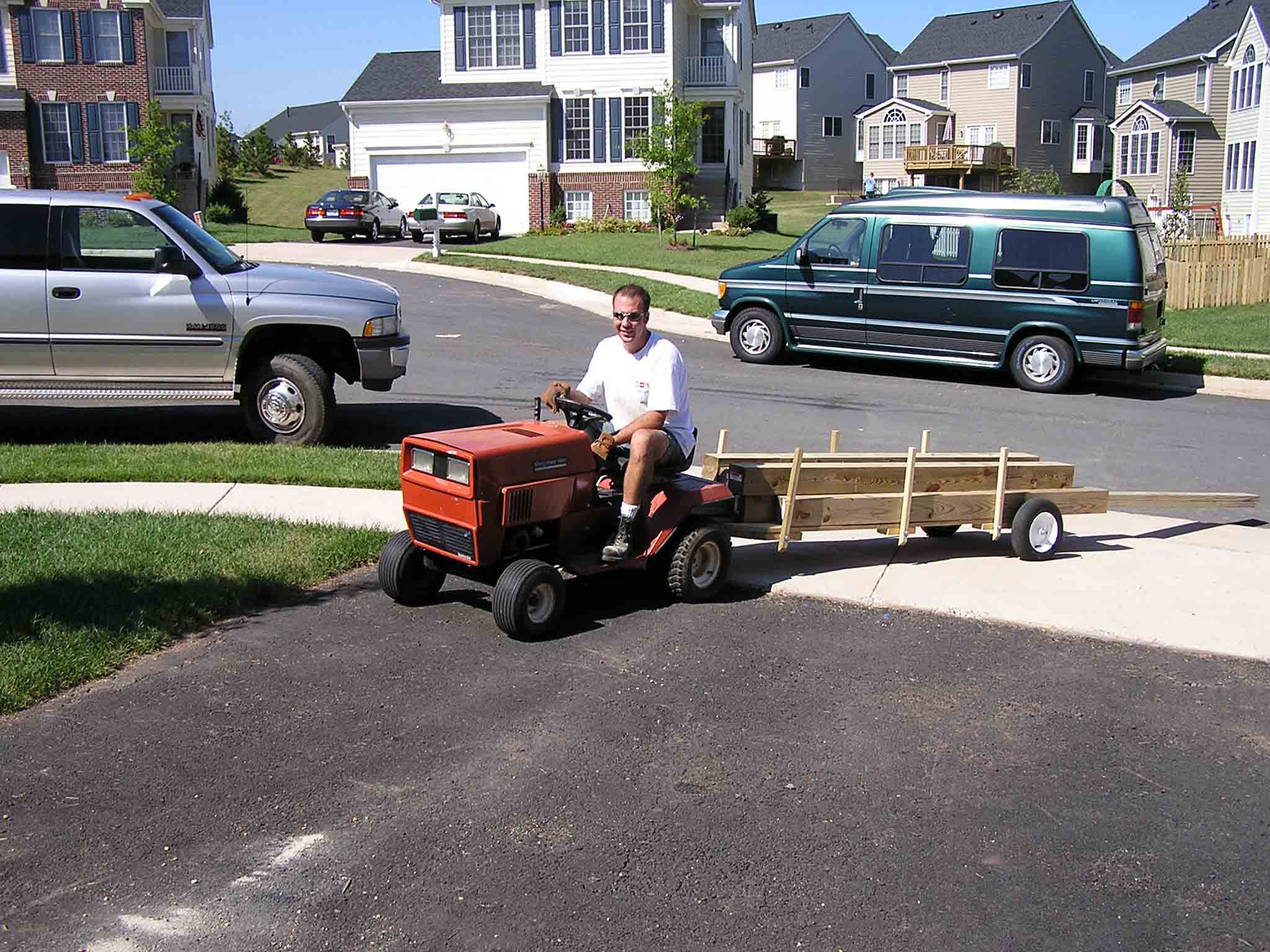

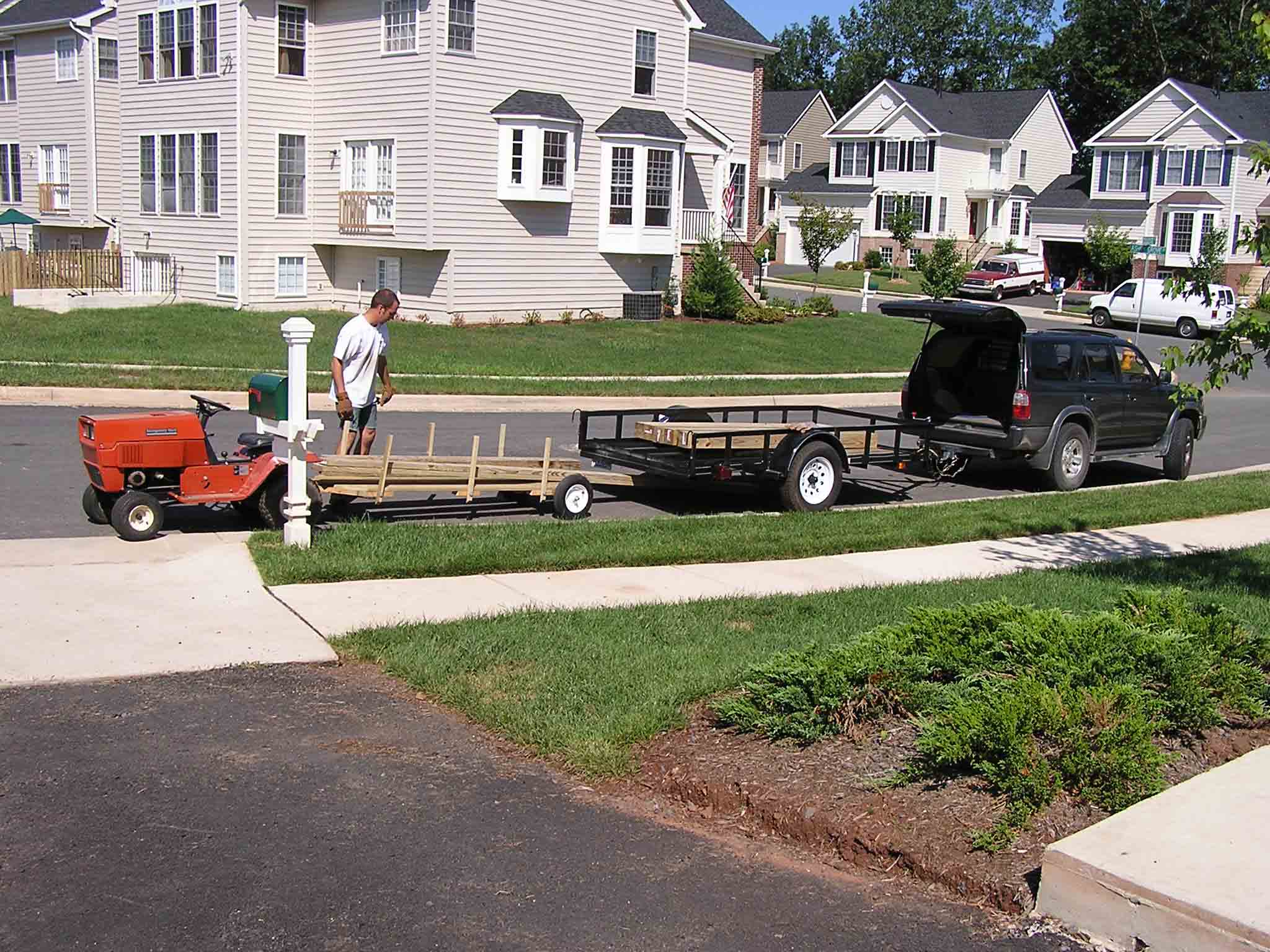

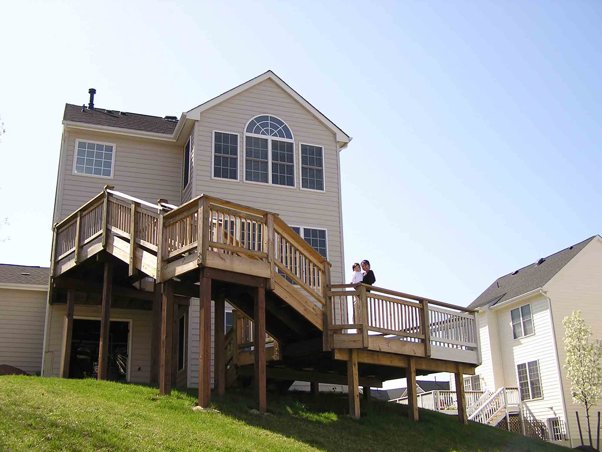

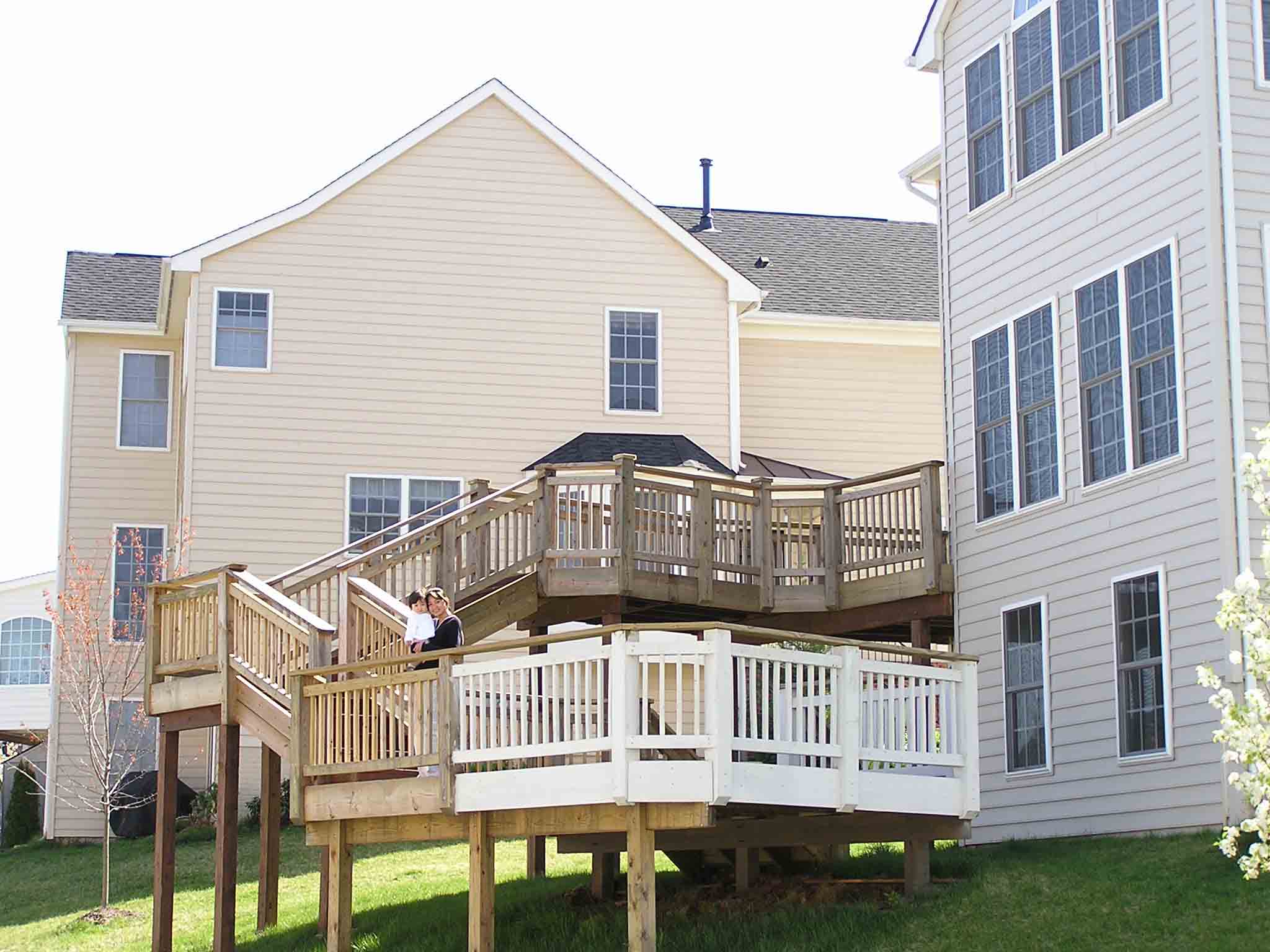

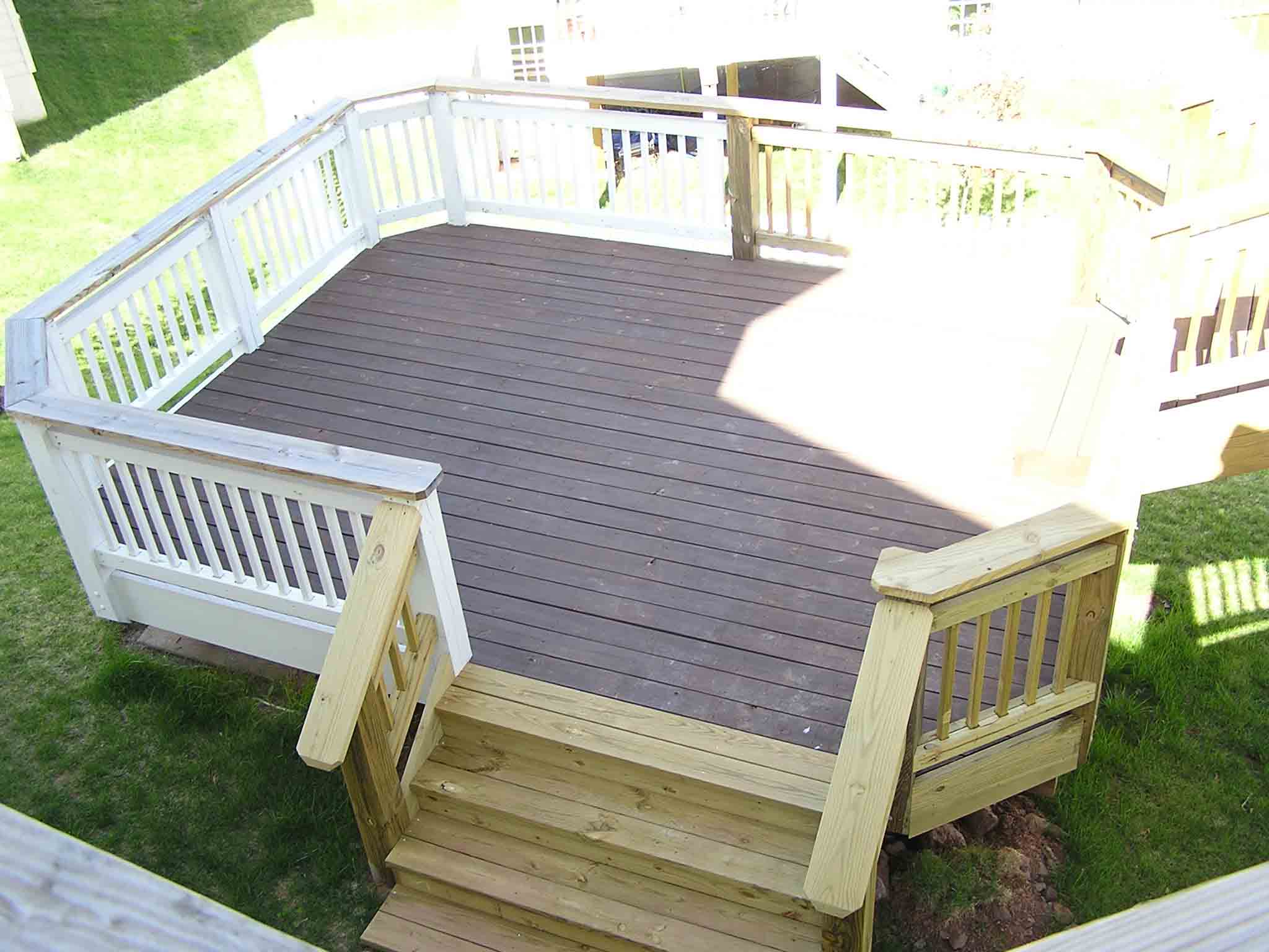

Though not nearly as nice as Mr. Volfandt's Wheel Horse, I built my first deck on a HECK of a slope using an old Monkey Ward lawn tractor and some home grown trailers to haul the tons of lumber from the street to the back yard.
Worked great until I got on a slope...the rear wheels broke free and no amount of brake would help.
BE SURE to use the 4WD when towing, loading, or whatevering a load on a slope. There's no saving you if she gets away from you and it is only the rear wheels clamoring for grip. Others have said it, just wanted to give you another example.
And show off pictures of that huge deck I built. Alone. Took a whole summer...wife was pregnant, so she slept through the whole thing, leaving entire weekends for me to work. It was GREAT. Pictures of new deck, old tractor, old trailer, old 4Runner, and slightly younger me. I'd put 1,000# of lumber on that little skid trailer and tote it around the back of the house. Worked perfect.
The day I finished the deck, we moved out of the house. Bummer. Oh well...I have my REAL tractor now...well...a BX anyway...
