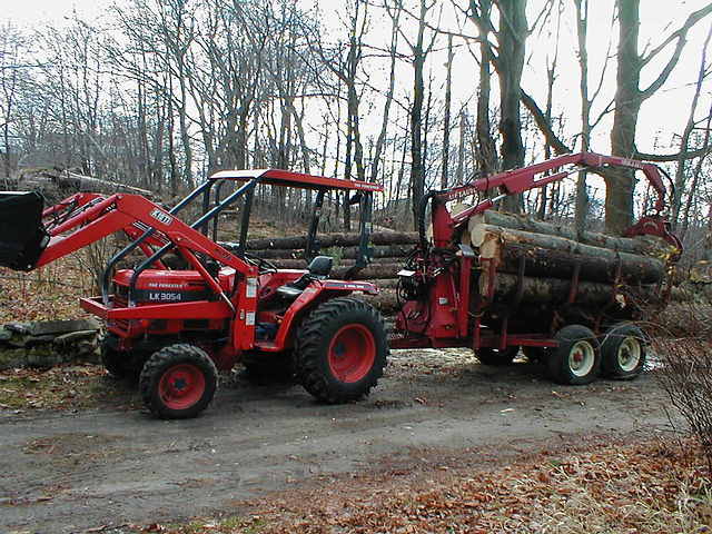

here is a shot of my lk3054 with a load of logs that it had no trouble with. by the way I also pull a 6 foot brush hog that will whack down 3 inch trees, also with no problem.

Wow, that was the picure I was making reference too in an earlier post.
There sure are a lot of uses for the FEL. Make sure you put something under the explorer incase the hydros give out!! /forums/images/graemlins/smile.gif It looks like the 3054 will be my chioice. Chris
