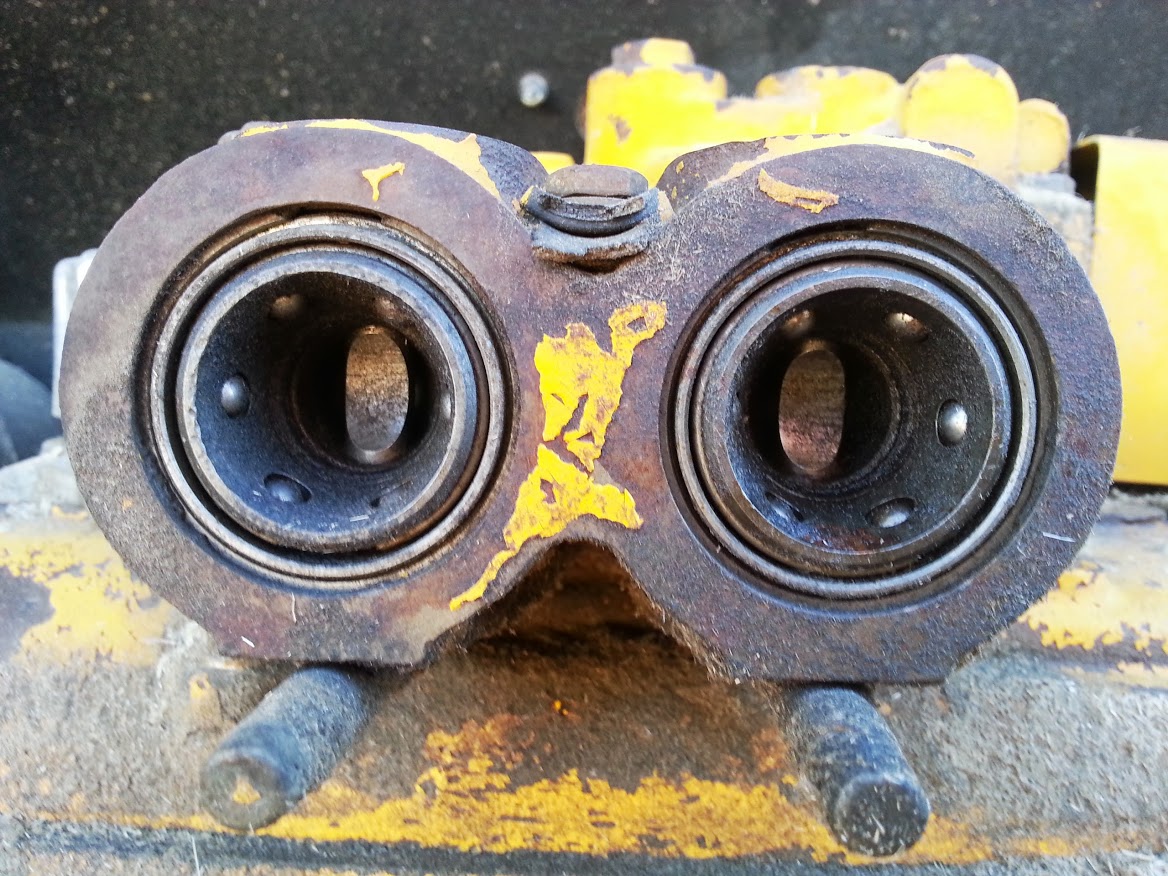

I have a question in regards to the hydraulic ports on the rear of the tractor.
This is what the ports look like:

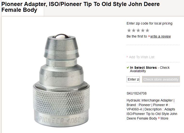

Can someone tell me if these adapters will fit these pictured ports:
John Deere Tractor Hydraulic Coupler Adapters Old Style Deere to Female Pioneer | eBay
From what I understand the type of port I have is a "John Deere Old Style" port, is that correct?

I don't know anything about a Chamberlain 3380B but the breakaway barrels resemble JD New Generation scv's so I think these adapter would work.
/ Will these adapters fit these remotes #3
I agree.
