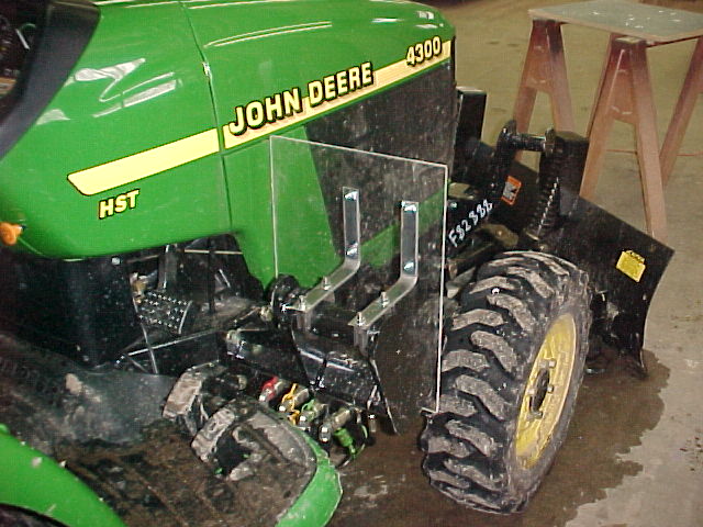

I get cold feet because the front tires throw snow on the platform then with the wind chill, BRRRRRRRRRR
I had some 1/4" plexiglass and under $10 in metal and bolts I think I have fixed my problem short of a cab.

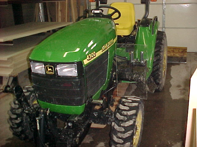

pic #2

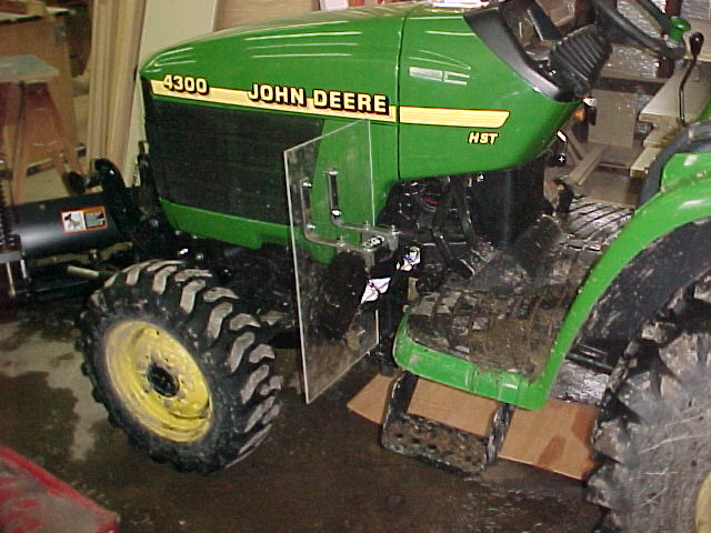

pic #3

I got 2 1/4" muffler clamps and mounted them to the GB loader bracket. It takes about 3 min to remove of put on.
