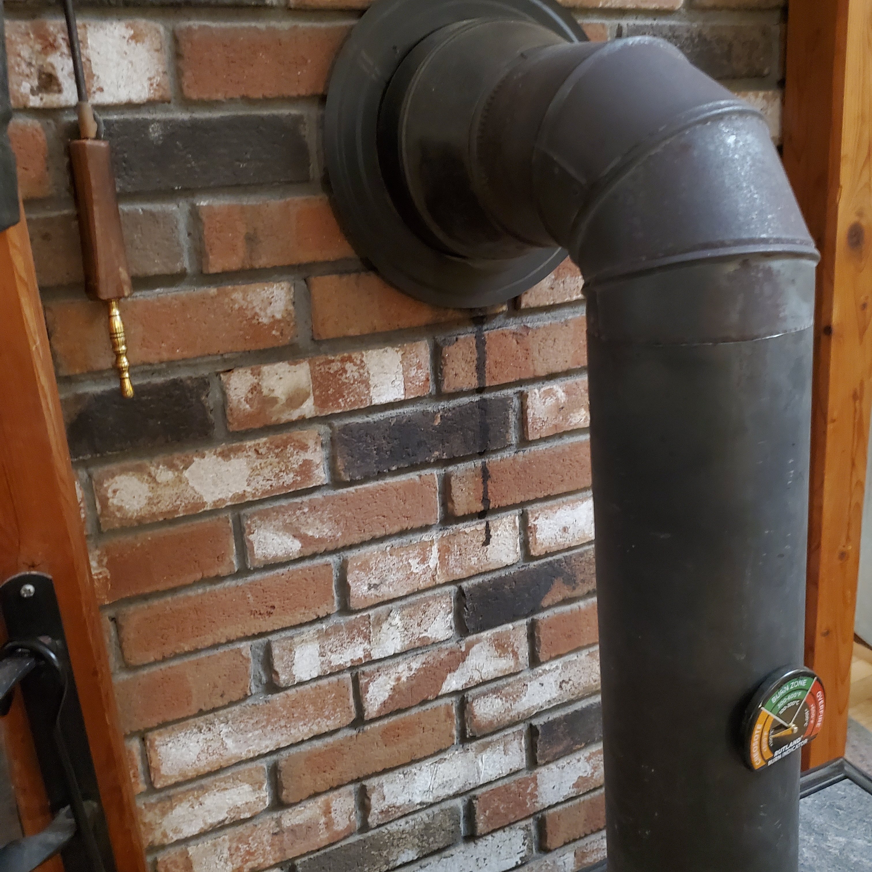

Tell me about that "wrongness" when it's 30 below, and the stove is running with all it's got just to keep the wife happy.
This was from two winters past, a cold snap...
   / Wood stove pipe size VS draft #38
Ouch!
Do you feel like your wood was seasoned adequate? Also maybe it has something with the horizontal section of pipe. The creosote that does accumulate runs to the bottom. Not sure.

Ouch!
There is seldom need to fire the stove hard enough to get the creosote running. But there is always "some" deposits in any flu pipe.
