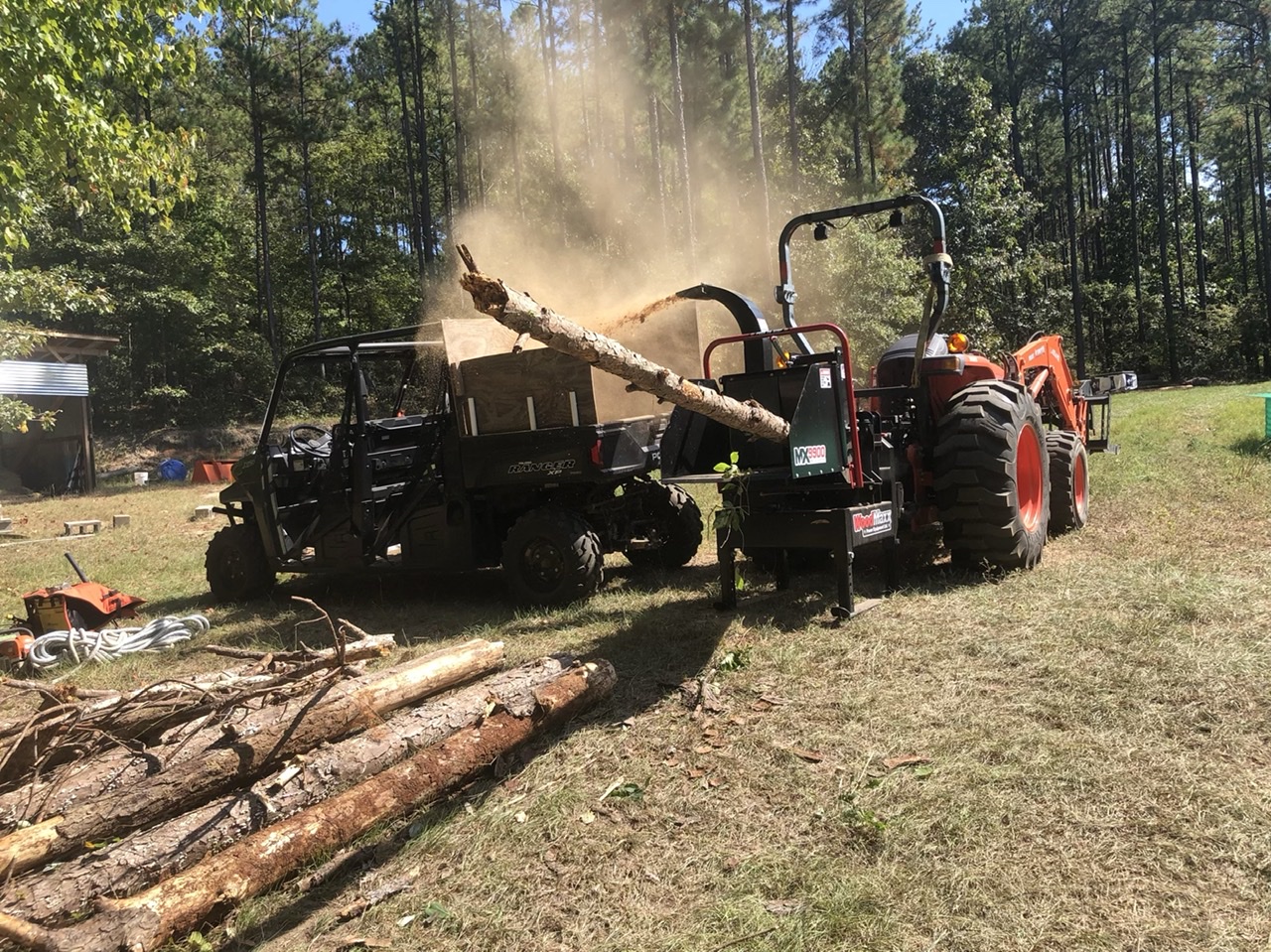

I have been scouring the Internet looking for the "right" chipper to use on my 80 acres of wooded property. I have all sorts of downed or dead fir, oak, pine and various other nuisance brush that I need to get rid of. I've been waffling between large commercial machines like a Vermeer or Bandit or scaling down a bit to a pto-driven machine that can handle up to 6" but I can't get a large unit or a tractor back into most parts of my property. To make a long story short, for many reasons (cost, form, fit, function) I'm now considering some smaller stand-alone models that I could pull with an ATV or SxS like the Jansen GTS1500 (or GTS-2000) and the Woodmaxx DC-1260. The Jansen appears to be of German design and many videos show it eating away most vegetation thrown at it but after calling Jansen USA I found out the machines are designed in Germany but made in China. As for the Woodmaxx, I was unable to get ahold of a rep today but upon looking at their website, there are glimpses of "made in the USA" but I'm unsure of how far that extends (i.e. the entire machine or just some parts. At any rate . . . does anyone have any feedback on either of these machines? Thanks in advance!

Only a few of the Woodmaxx attachments are made in USA. Most are made in China, to Woodmaxx's design and specs. For example their WM-8H chipper is their design, not a generic one. The MX line of PTO chippers are made in the US. They make that really obvious on the pages for those implements. The page for the DC 1260 shows made in the US knives like the 8H has but nothing else about made in USA. So except those parts, it's probably made in China.
I've been pretty happy with the 8H. I can't get to many parts of my 20 acres. Sometimes I have to drag stuff to where I can get the tractor to it. After having a 4.5" self feeding PTO chipper I'm very happy to have an 8" hydraulic feed. It's so much more effective. I don't have to cut stuff down to tiny pieces to get it in the chipper. I'm only limited by what I can drag to the chipper and get into the chute. My tractor's got 32hp at the PTO and there's times that I could use more. A 14hp gas engine wouldn't do it for me.
The 8H isn't quite to the build quality that I'd expect for a made in the US implement but it's perfectly suitable. I have some 65 hours on mine and it's been totally reliable. I did replace the hydraulic speed control for a US made valve of a more appropriate size for the small flow system on the chipper, in order to get better control over the feed speed. But most people are ok with the one that comes on the unit.
If you have enough big stuff to justify a commercial style trailer mounted chipper, they make some with built in winches.

I've got the WoodMaxx MX-9900 on 28 acres and I've been using it hard for almost a year now and have about 15 acres I haven't even scratched yet. I don't find it efficient to have the chipper running while I collect material because even though it feeds 90% of the stuff by itself you need to watch it and keep it fed. Typically I'll pile a bunch of material one weekend and chip it the next. I'd be surprised if you could collect enough material to keep even the smaller chippers chipping by yourself if you don't pile up the material.
FWIW I staged material starting before I ordered my 9900 and it was backordered about four months so I had what I thought would be a year worth of material and I chewed through it in the first five weekends or about 15 hrs on the chipper.
