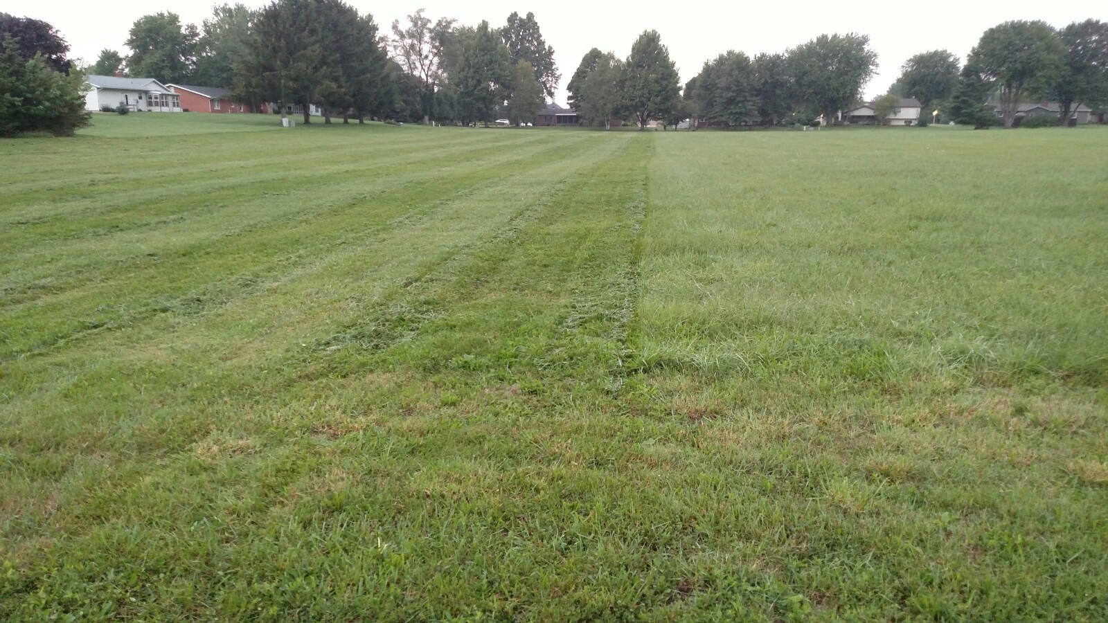

This mower cuts phenomenal and very fast on my regular jobs. The ones that get done monthly or every other month. The 12" tall stuff. And when I say fast....that's 7mph.
Here is part of the 9 acre job I just did this morning. Full speed, medium range...7.3 more iirc

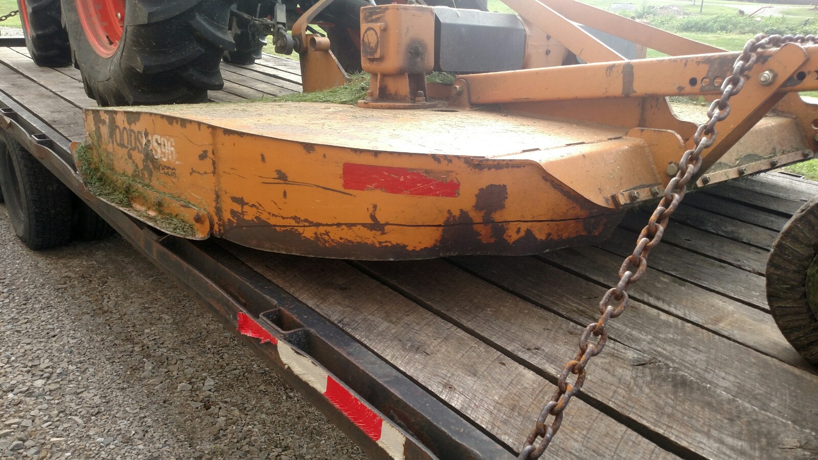

But the thing don't do so well in 3' high stuff. Not that it's lacking power cause I don't think 100pto hp would do any different. The deck just plugs up. The small opening in the back is not large enough to discharge to discharge the volume required. Not to mention the way the back is angled down where the tailwheel supports are. That eats up 3-4" of vertical open area.
I am considering cutting a little out. What do you guys think? I can always weld it back on....but really want to make this cutter more efficient in taller thicker stuff. Any other ds96 owners experience similar?
Here is where I am thinking about cutting on both sides. (Along the black line)

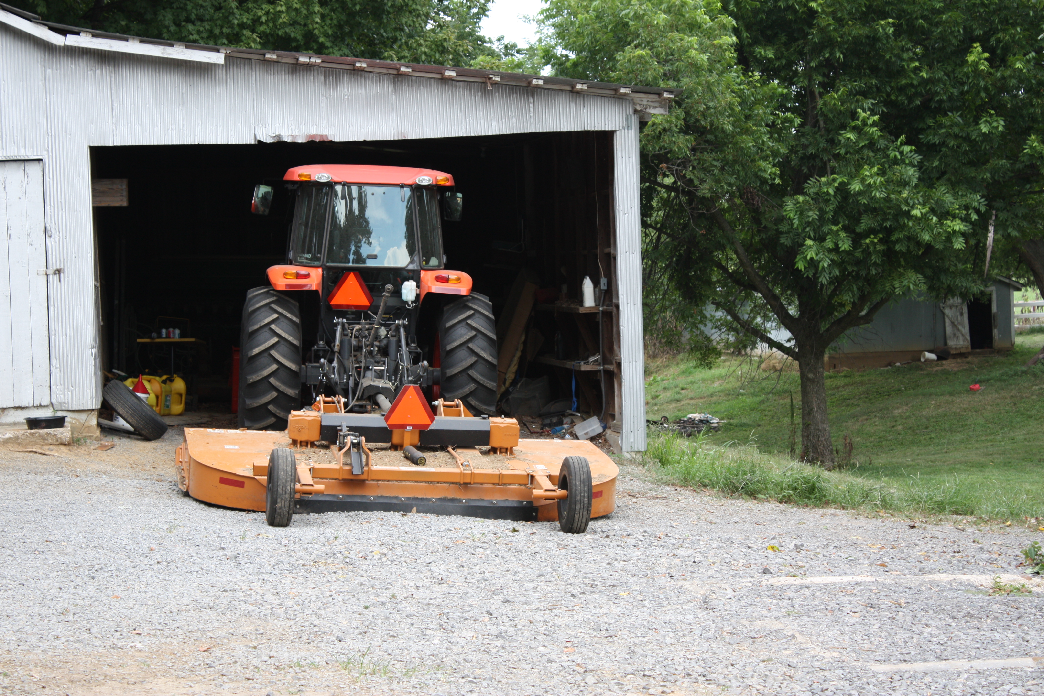

Probably won't hurt and certainly may help. We cut stuff up to 10' tall with our Woods DS 10' Woods and have no issues, but it certainly leaves residue in 3', we get a great cut and often mow a side yard with it. We use an M8540, but we don't mow as fast as you which I am sure would degrade the cut quality.
To get more mulching action, we cut with the rear of the cutter a bit lower than the front, but it take more power and goes against normal setup for rotary cutter.

Yours even still has the rubber deflector on it.
On mine.....like I said, it dont seem to be speed or HP related, rather the clippings just have no where to go. Its like you can mow for ~8-10'......then you just hear everything load up. Like 10' worth of clippings are trapped under there. Continue going, and it almost sounds like running over a dirt mound, and you look back and see a big wad of grass and clippings kinda piled up. Rinse and repeat every 10' or so. And it does it even going extremely slow.....like 1-2mph. The tractor dont run out of power until the moment right before it spews 10' worth of clippings out the back. Then it loads up and boggs just a bit as I mentioned.
I have tried cutting higher, and running the back of the deck quite a bit higher than the front....like 3-4". No difference. Just not a large enough opening to disperse clips.
Heck, most 5' cutters have more open area in the back than this one.....and an opening that goes all the way to the deck surface, and not loose that 3-4" from that angled piece that reinforces the tailwheels.
