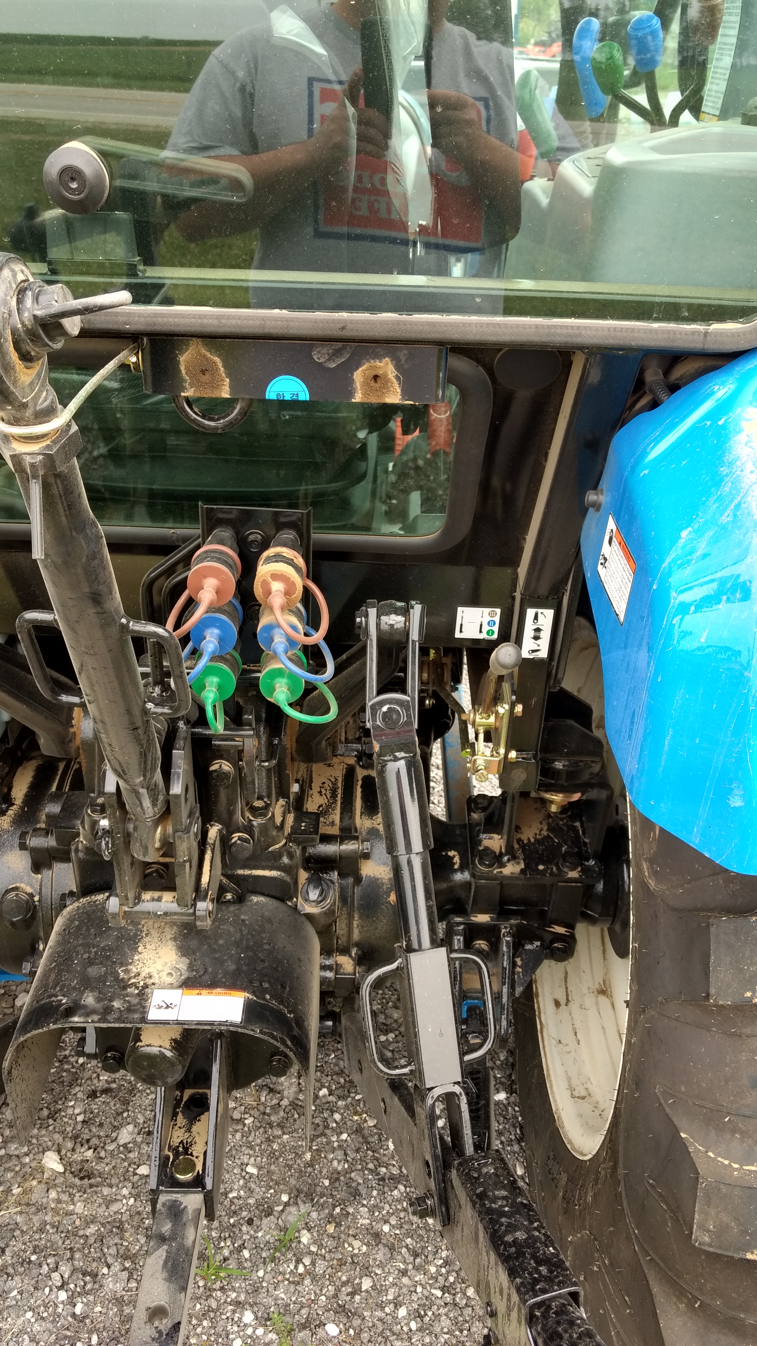

Today I was out comparing an XR4155 to a Kioti NX6010 and saw LS has added a third rear valve and rear 3 point handle to them.
Very nice.

Nice!! I already added a 3pt lever on the rear of my LS 4155HC.
I could see a use for the 3rd hydraulic on the rear tho!!
