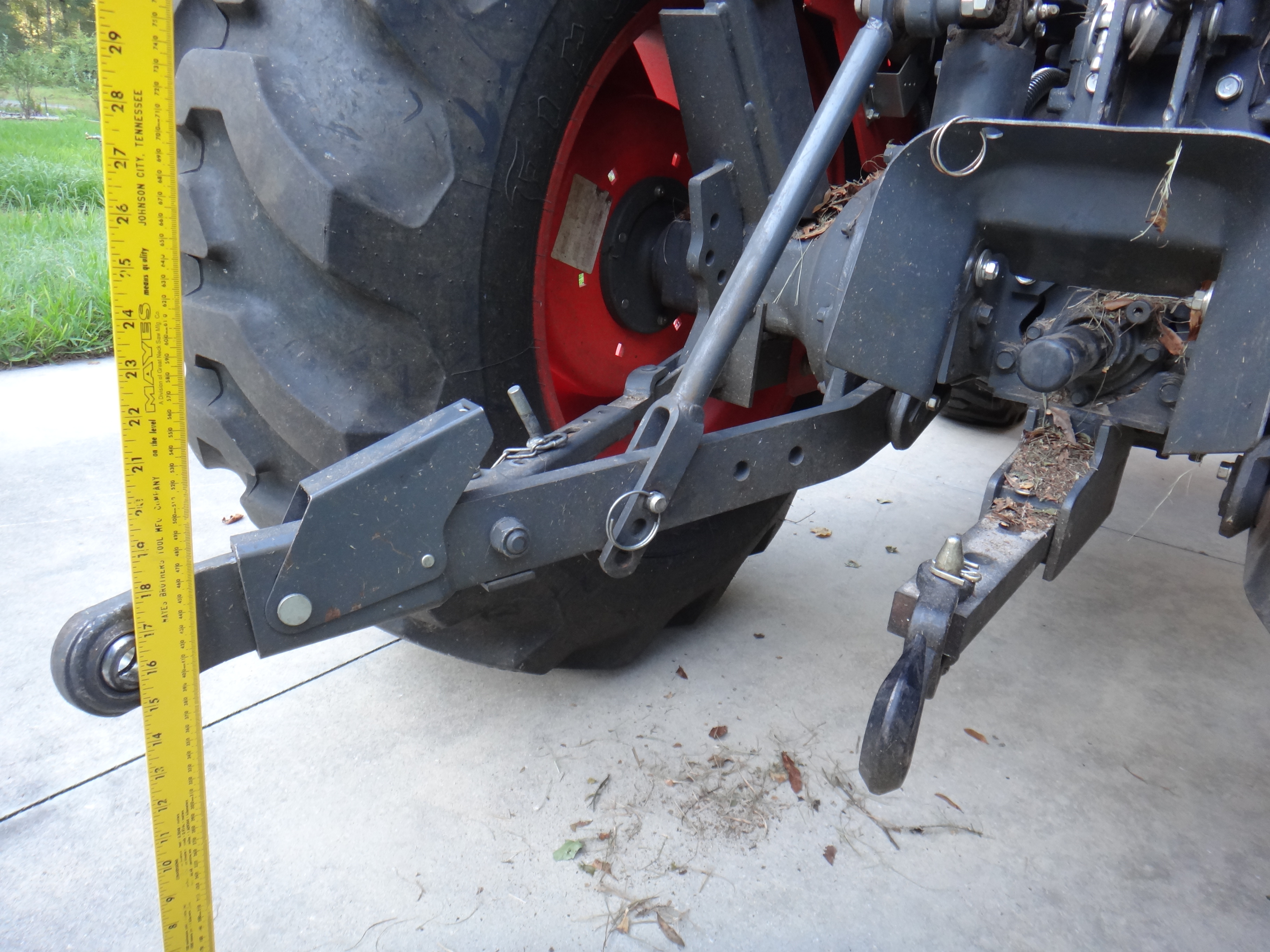

So I bought a pretty much brand new condition 2019 Yanmar 324 with 28 hours a few days ago and I realized after the fact a few things that I wanted to see if anybody could help me out with.
1. For some reason its listed as "Cat 1 (Limited)". When I measure the width of the 3 pt arms they seem to have as much travel as JD 2520 I use to have, maybe it doesnt lift as high?
2. Following up to limited Cat 1 question above, is anyone running a quick hitch on their 324? Just want to make sure nobody has run into issues with one before I pick it up.
3. I saw somewhere a guy running a 60" box blade on a 424 (same as 324 only larger wheels/tires), has anyone run a 324 with 60" box blade? I would be using it to grade a private road we have from time to time and also snow removal and around the yard when leveling is needed.
4. Yanmar has its own front loader "quick attach" system... annoying. Has anyone found a nice reasonably priced set of forks that attach this way or am I better off getting a SSQA set of forks with the Yanmar to SSQA adapter?
5. My hydrostatic drive was a little "stiff" when I first took delivery of this used unit but it seemed to feel better yesterday when I took it out on the roadway. One thing i noticed is that when you tip in a little it seems to oscillate a little before settling out at a speed. Anyone else notice this on their unit? Also when going in reverse when I lift off the pedal, once my foot lifts off the last like 1/2" of travel it almost feels like the brakes apply as it comes to very abrupt stop.
6. Were any of your brand new machines delivered with hydrostatic fluid level soo high it fills the sight window completely when off, cooled down, on level ground, with 3pt in top position? I drove by Yanmar dealer (since mine was "used" but never really used much by previous owner) and EVERY SINGLE 324/424 on their lot has 3pt arms all the way up on level ground and sight window is completely full with no air bubble present. Manual says it should be halfway up window when off.

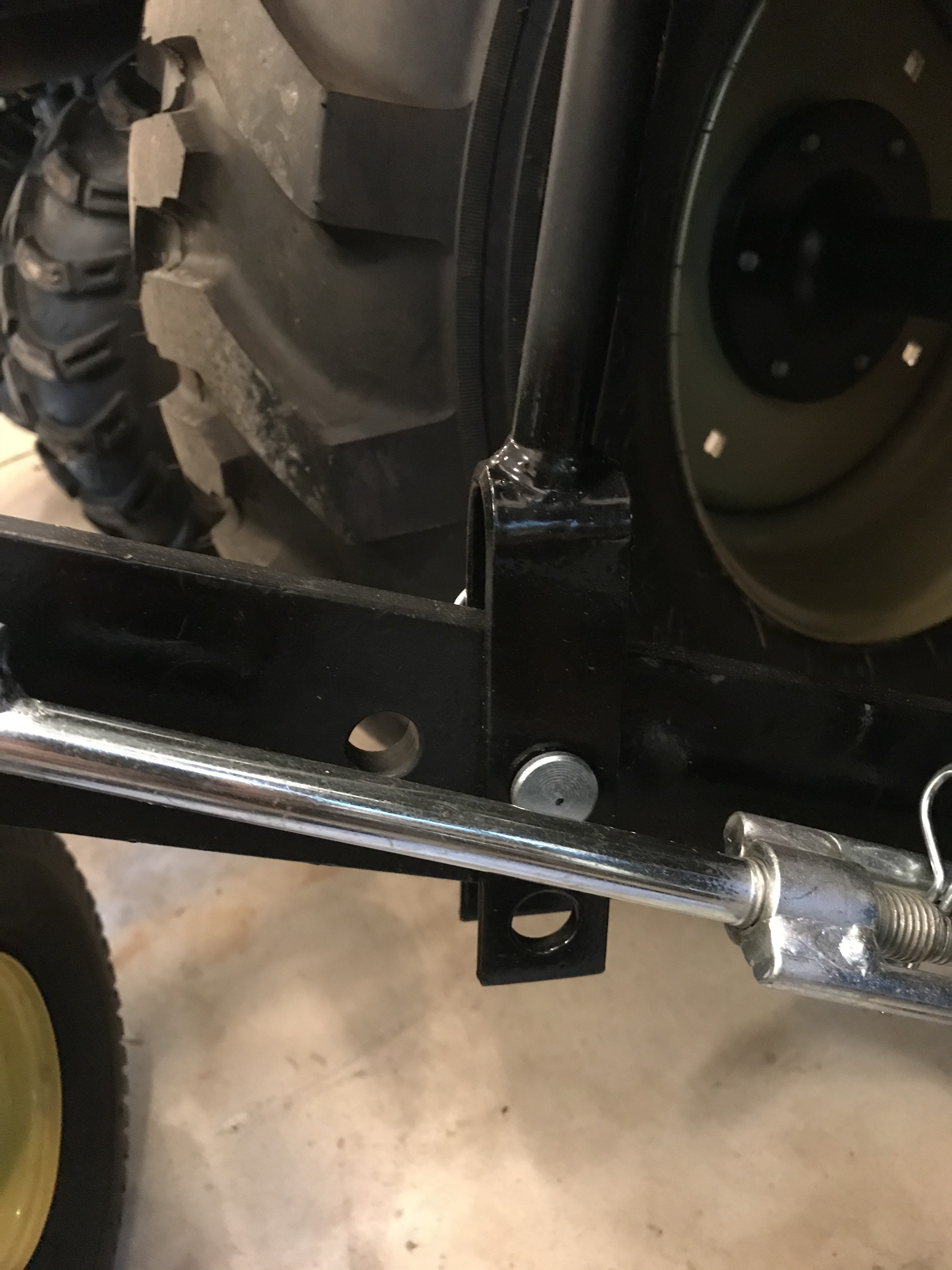

So I may have already answered my question #1 above, I went out and noticed that there are three different settings I can put the 3 pt arms at in terms of max/min height by just swapping the pins going between the 3pt hydraulic lift arms to the lower 3 pt arms. See photo below. My theory is that in the lowest setting via pins its considered limited cat 1 but if in highest setting its cat 1? Mine has sat in garage for two days with 3pt at max height (may have some hydraulic leak down by now) the height was within 1" of my old Kubota B2601 at max height and about 1" higher than a 1025R has at max height.
Follow up is me thinking out loud about these really being more of a compact tractor than a sub compact. Does Yanmar label it as sub compact for a reason? Overall its heavier in weight than a Kubota B2601 or JD2025R, has higher lift capacities in loader than Kubota B2601 or John Deere 2520 or 2025R, has higher 3pt lift capacities then John Deere 2520 or 2025R, and its overall dimensions are very similar to both machines.
Multiple pin locations on 3pt arms:

   / Yanmar 324 Questions from a New Owner #10
Anyone running a quick hitch on their 324? Just want to make sure nobody has run into issues with one before I pick it up.
The implements appropriate to lighter tractors are lighter implements. Its easy to line up a light implement to insert the three hitch pins by applying a boot or prying a bit with a crowbar. Storing implements on 6" wide (pressure treated) planks makes them easier to move with a bit of sand on the planks for lubricity, relative to ground storage.
When implements get into 600 - 1,200 pound weights a quick hitch may be appropriate, especially for "senior" operators. When 600 pound implements are stored on 6" (pressure treated) planks they slide fractional amounts fairly easily.
Research carefully if a quick hitch on a Cat 1 (limited) TPH will line up with implements properly. I have my doubts. Cat 1/limited Top Links are usually 3" - 4" shorter than standard Cat 1 Top Links. (varies)
I am a believer in keeping everything on the tractor as simple as possible. To me, a TPH quick hitch on a light tractor is an oxymoron.
I noticed that there are three different settings I can put the 3 pt arms at in terms of max/min height by just swapping the pins going between the 3pt hydraulic lift arms to the lower 3 pt arms.
Kubota uses the same adjustment method. You tilt a Box Blade or rake by having pin higher on one side than the other, then fine adjust tilt with the right Lifting Rod. In this way the right Lifting Rod is not extended too far, putting strain on just a few right Lifting Rod threads.
To a certain extent you can gross adjust the amount of bite a Box Blade has on dirt by changing holes.
LOWER HOLE = LOWER LIFT.
Top Link length effects bite in a different way. Top Link is primary bite adjustment for most operators.
The division is tractor weight and ground clearance = wheel/tire size.
Subcompact tractors have 6" to 9" ground clearance.
Compact tractors commence at 12" ground clearance for crop clearance.
No compact tractor has a Cat 1 (limited) Three Point Hitch.
A limited three point hitch reflects mainly the lift height and rated capacity for lifting these implements at the lift arms. Frequently, the spacing between the arms is reduced, which occasionally renders larger implements useless. The real reason behind a Limited Cat 1 hitch is the SCUT tractor. These tractors can attach a set point as wide as many small CUT machines, but usually have lower machine weight and smaller tires, generally 26x12x12. If I recall (I could be wrong) the max Cat 1/Limited weight is 420 vpounds 24" behind the link arms.
This would eliminate many larger implements even though they can be mounted by the hitch on dimension alone. It also assumes that those heavier implements would not be liftable to the appropriate height by a smaller tired machine, thus the limited weighting.
The short message here is the limited cat one hitch is meant to allow a small tractor to share mounting points with a larger tractor, but concedes the tractor using one cannot and should not be participating with implements greater than 420 pounds.
