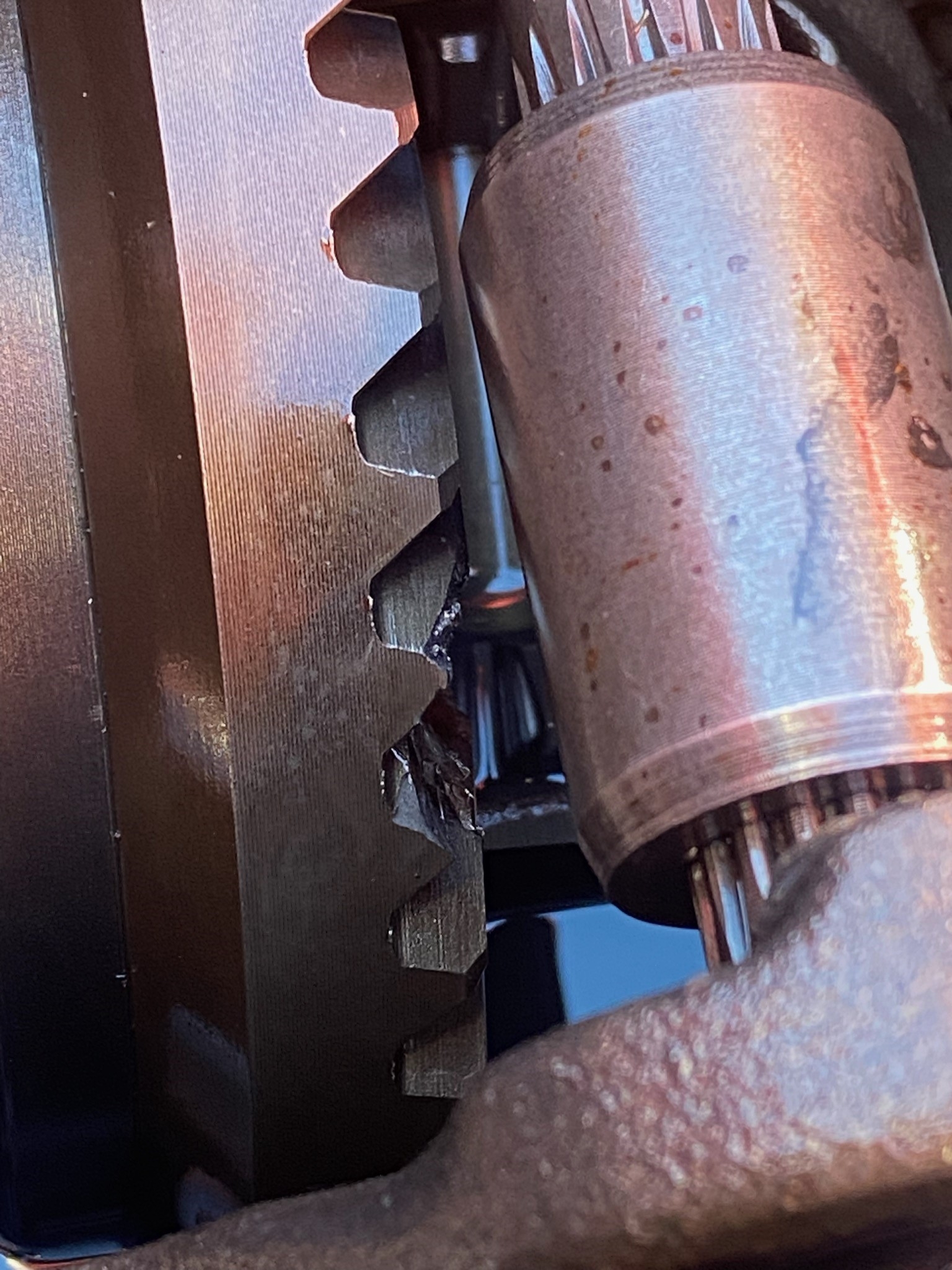

Hello everyone, New to the forum. I'm at a bit of a loss with my current project and I'm looking for some direction. My tractor is a 1983 yanmar F16d 4x4. It developed a pretty nasty noise in the transmission so I decided to take it apart. Turns out the ring and pinion are missing teeth... I have contacted every grey market parts dealer in the states and no-one has any kind of idea of where to find one. Does anyone have any experience getting these gears repaired?

A few chewed up/missing teeth might be repairable. A good machinist can cut you a new ring gear, but it will not be cheap.

Not the best picture. I didn't want to tear into it and not find a solution.

Hard to tell but it looks like your pinion is pooched too.
If it is only the crown gear, it doesn't look terribly bad. I'd be trying to repair it if a replacement is not available or too much cost, what have you got to lose.

It's unfortunate but that repair is not an easy one. I'm a retired machinist, still have my shop, and would only attempt that repair if I had to. The reasons being that the ring and pinion are heat treated, hardened, and then finished on a machine made just for hobbing and/or grinding gears. If I had to make the repair myself I would weld up the broken teeth, rough grind by hand close to the proper profile, and then very carefully grind by hand using bluing to fit the ring and pinion. This would be a very long process. If you can find a place that does gear cutting you should talk to them and see what they think. Maybe try these folks: Replacement Parts They will reverse engineer your gears.

I would be looking for a tractor wrecking yard before looking for a machine shop. You will have better luck finding a used ring gear before a machinist that would touch that
/ Yanmar Ring Gear Repair? #15
This repair would work. For a while. If the repaired teeth were ground such that they provided clearance then the pinion wouldn't bind. But there would be serious lash. If the gear set spun slowly it might last a long time. Still, if I absolutely had to do a repair on my tractor's ring and pinion the job would be similar to the one in the video. The difference being that I would not trust grinding the teeth by eye and calling it good. I would first fix the pinion gear by using the ring gear as a gauge and then fix the ring gear by using the pinion gear as a gauge.

it looks like I'll just have to keep hunting for a junk yard or tractor salvage place....I am a proficient welder but I don't think I have the patience to rebuild this thing.
