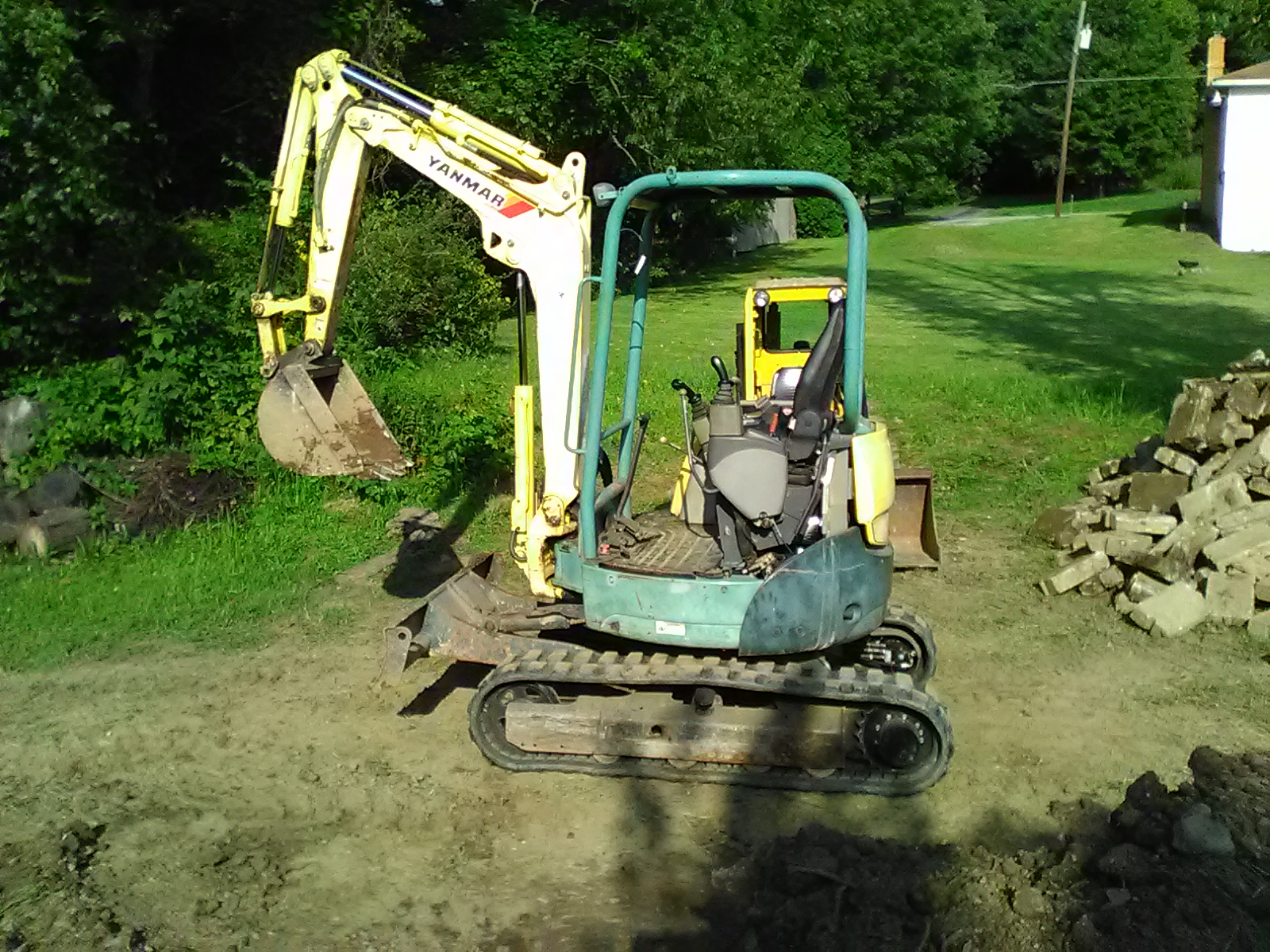

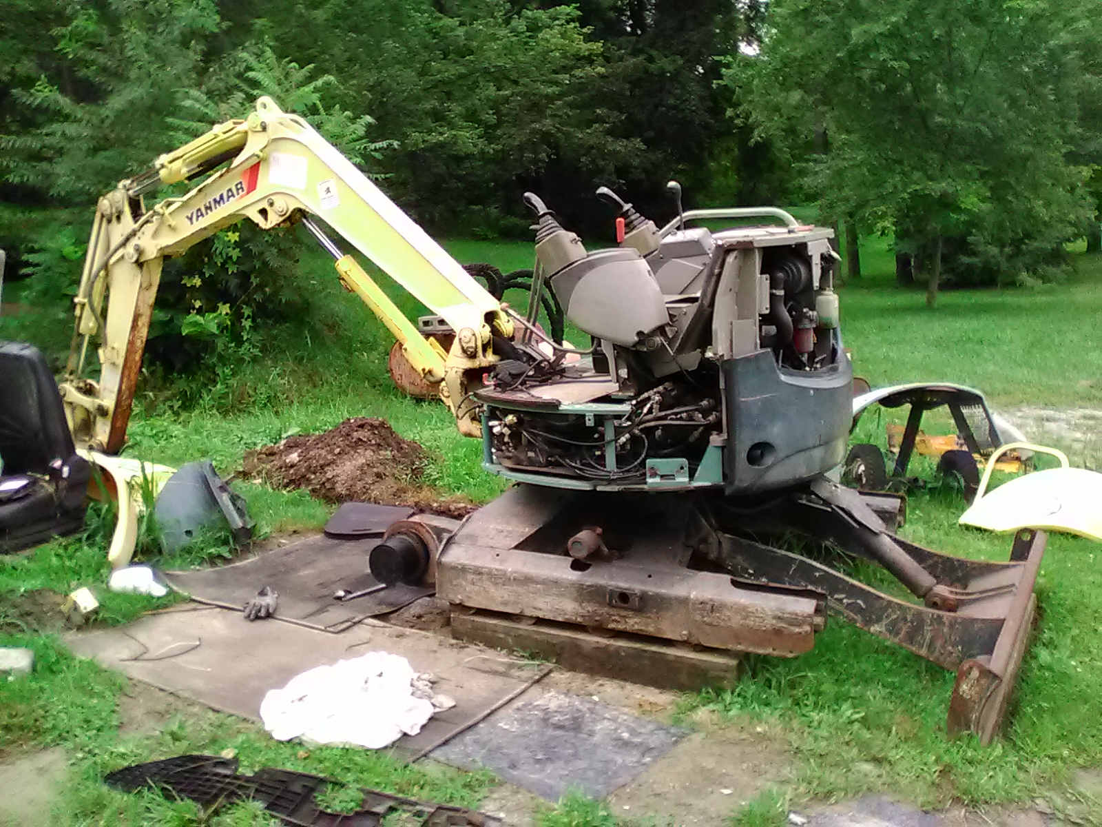

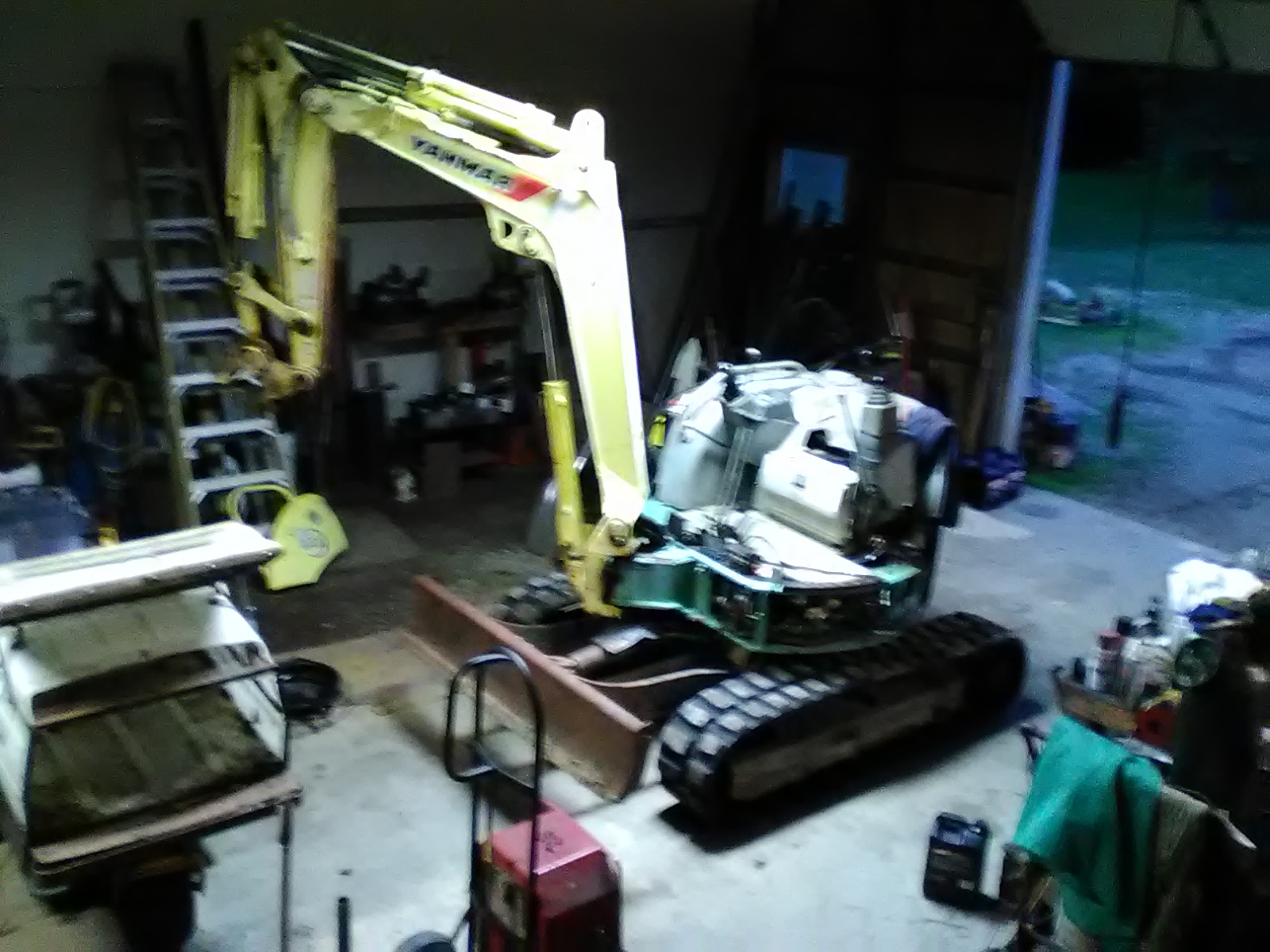

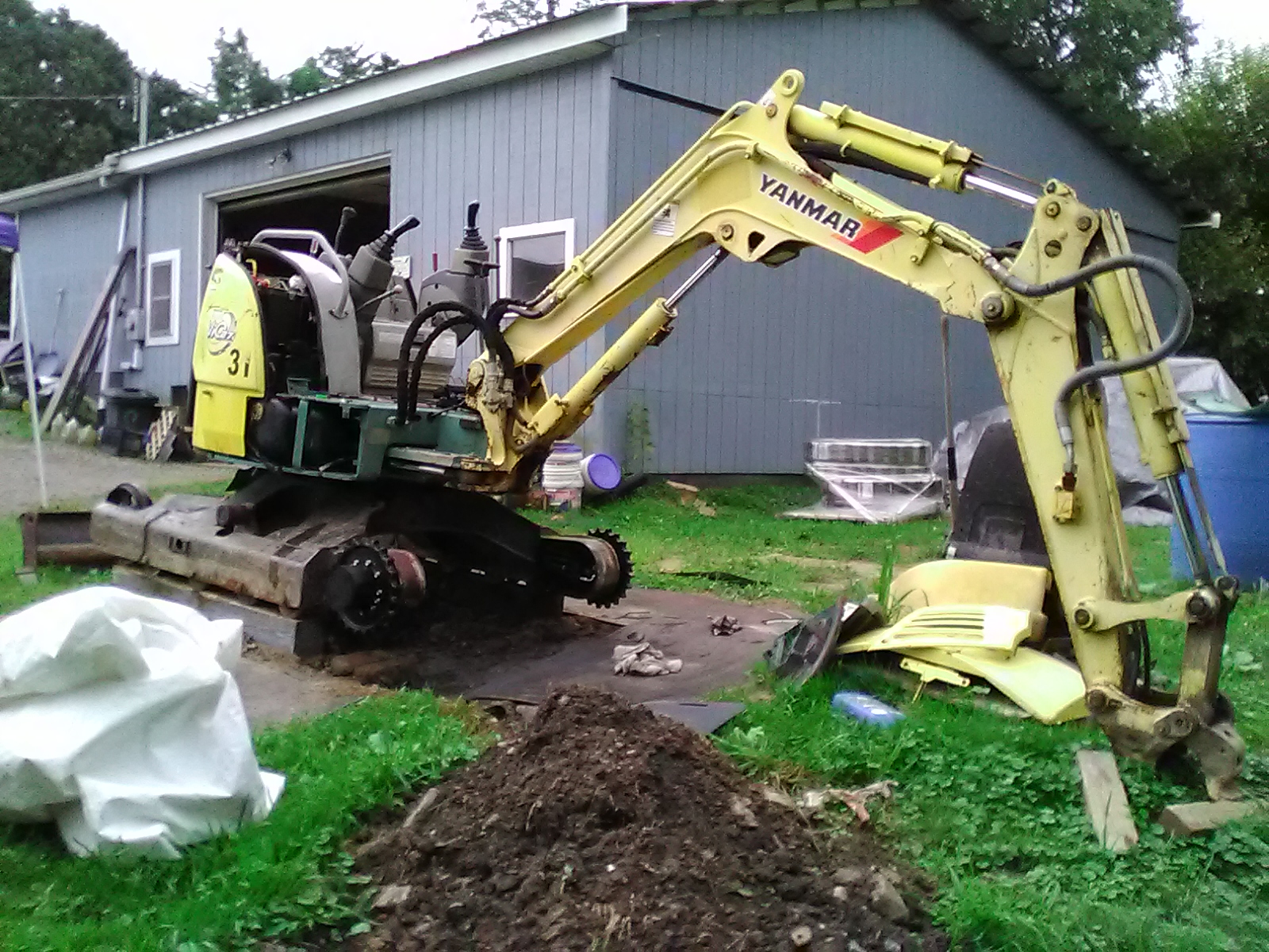

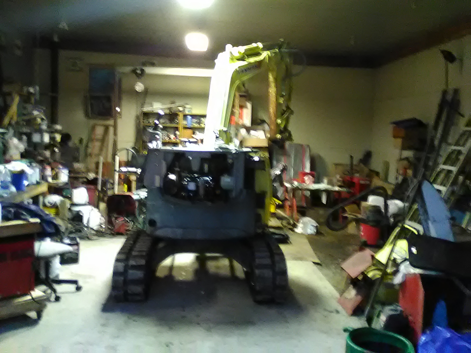

Update on this thread: I ended up purchasing the excavator and I got it running! Had to rebuild the engine, all the pistons were cracked between the compression rings. Had it bored out and new pistons and rings, rebuilt the injectors. Was missing the fuel injection pump. Bought used one off of eBay. Got the the engine running, had to adjust the pump timing. Once I got it running, I had to buy new aftermarket drive motors, tracks and one idler tensioner. Had to remove all the hoses for the drive motors, and clean them out of all dirt and contaminants. Had to get a bucket and fit it up to the boom. All in all It was a lot of work to get this running but I have been using it now for about a year and was well worth the time and effort! I have about $11000 into it.
