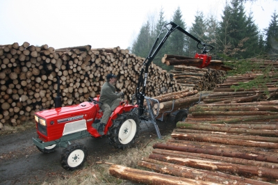

I'm a dealer from Sweden who would like to shear some thoughts about using our favorit tractors in the forest.
If you follow the link below you will find some pictures from today.
We did some testing with our new grapple loader ( is that the correct name ?)
Works like a dream!!
We have hydraulic drive system on the trailer that is activated by electric switches from the tractor.
link to pictures:
Malwa International - Minitraktorer & tillbehör
Please give me some feedback, always nice !

Nice pictures! Thanks for sharing. It's amazing how your Yanmar can do all that lifting and still get in among the trees. That's beautiful country. What area of Sweden?

Interesting unit. What would be the practical limits of the arm pictured in terms of weight lifted - is it rated for a maximum lift? When you mention the electrical switches, are the hydraulics solenoid activated? Assuming the hydraulics are driven with a PTO pump or does it utilize the tractor hydraulics? Although most British Columbia wood is a bit larger than the trees pictured, it certainly looks ideal for smaller diameter trees.

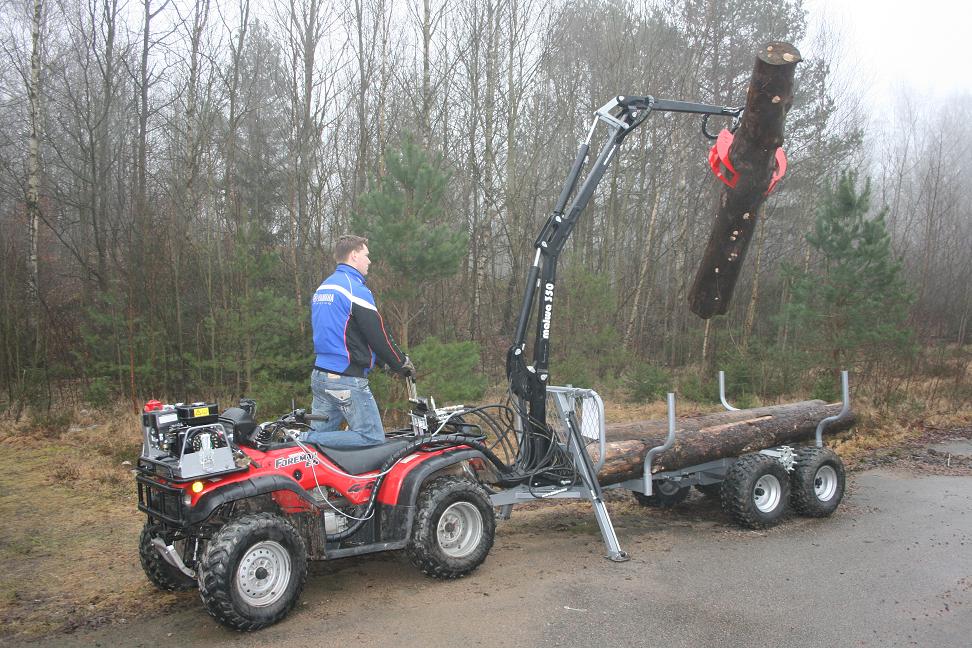

The max load is approx 350 kg at 1,7 m and 175 at 3,0 m the total length of the crane is 3,5 m.
You're correct its solenoid valves. I run it direct from the tractors hydraulic, the crane doesn't need very much flow, when we use them together with an ATV the flow is around 8 liters/min.
Below is a link for some bigger logs, maybe "British Columbian" style :)
