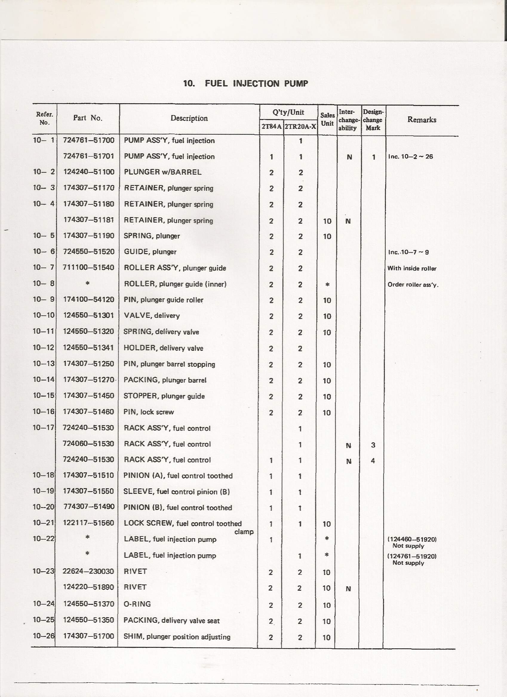

i am new to the forum and will probably get lost. i recently acquired a green YM2000 tractor that has been setting for several years. the previous owner parked it and when he went to start it it would not start. it set for several years before i bought it. cleaned the fuel tank, installed new lines, filter etc... i am getting a good supply of fuel to the injector pump but nothing out when cranking. fuel tank is full. everything i have looked at is clean in the engine. any advice would be appreciated.

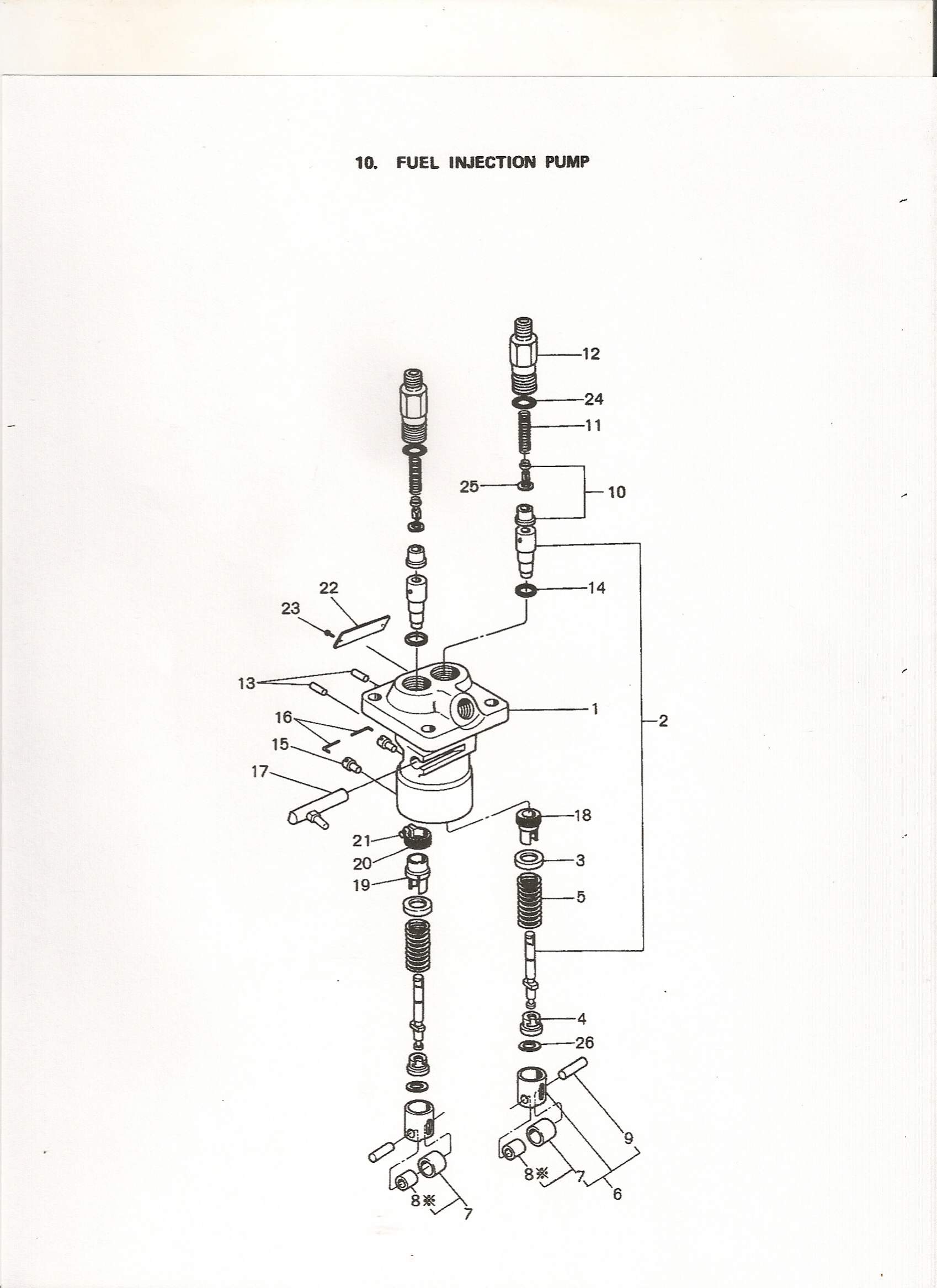

Welcome to the forum. :welcome: Wouldn't suprise me if the rack on the fuel pump is stuck or even the plungers. I would pull the inspection plate and move the throttle checking to see the rack is moving. Note refernence #21 on this parts drawing. Yanmar Tractor Parts: INJECTOR_PUMP

i have had the pump out and this part would not move, should i be able to move it by hand?
   / yanmar ym2000
It should drop of it's own weight, end-to-end just by tilting the pump.
I believe that you have identified the problem. It does not move. What could have made it stick. The inside of the pump looks new. I can take a drift punch and the handle of a screwdriver and it will move. I have sprayed id down with WD40 with no results. Any suggestions
   / yanmar ym2000 #6
Time and rust made it stick. If continued working it with lubricants applied does not work then nothing left but to take it apart. They are a bit complicated and if you don't feel confident you might want to consider and injector pump shop. You do not want to change any settings on the internals.
Here is what a new one is worth. Yanmar Tractor Parts INJECTOR PUMP - NEW! - OUT OF STOCK - WE CAN REBUILD YOURS Well, looks like they are out of stock, might want to inquire about the rebuild.
