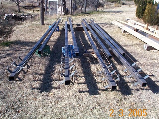

The barn I've recently started on will be 42x63. One difference in my barn from most is that I'm using 3.5 x 3.5 x 3/16" A500 tubing for the load bearing posts instead of wood. I like the idea of burying the poles to offer additional bracing to the building but was a little nervous about putting wood poles in the ground. That, plus the fact that the relatively slim 3.5" poles can be hidden in a wall that is framed with 2x4's will make the living area look a little more finished.
Here's a picture of some of the poles before they went into the ground. You can see that I built a cage at the base out of 2" x 1/4" flat and some weldable rebar. The rebar will eventually be tied into the slab. Hopefully that is only a few weeks off!

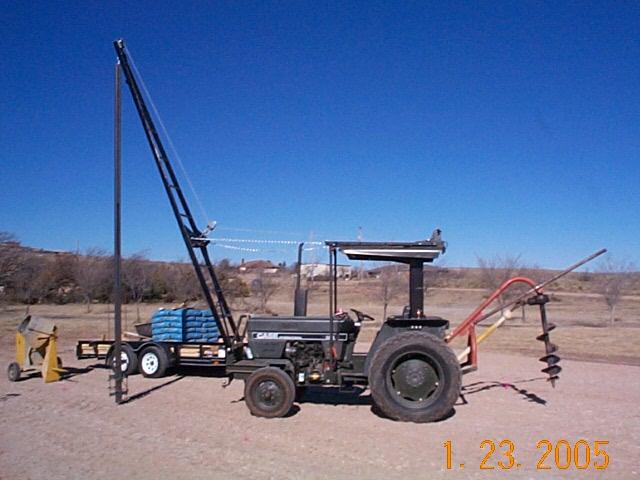

Here's a picture of one of the poles getting ready to go in the ground. I built a 19' gin pole for the front of the tractor for this very job (and eventually to use to lift the roof rafters in place).
The gin pole is lifted in place with the 9000lb winch on top of the tractor, secured with chains and then the winch cable is freed up to use to lift the poles.

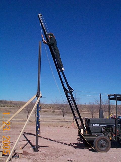

I put some "steps" on the gin pole to allow it to double as a ladder. Here my wife is removing the cable from the poles after they've been put in place and braced up. Cable attaches to a little hole at the top of the pole that I punched with a torch when I cut the pole to length (chopped down to about 18.5').

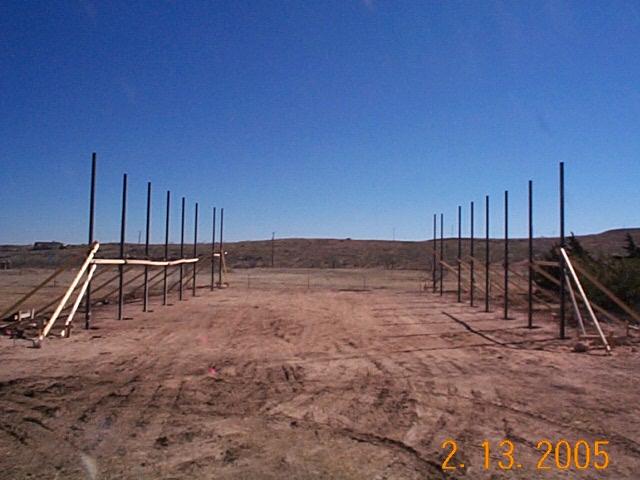

This pretty much brings you up to speed on where I am now. This last picture shows all 16 of the poles in the ground.

Those are great looking poles, and they have really peaked my curiosity. I'm planning a pole barn 74'x40'. I know NOTHING about building engineering, so excuse my ignorance in asking this question, but how does the strength of a metal pole like that compare to a 6x6 PT post set in the ground?
I have basic welding skills and equipment, and I'm wondering what the cost per pole is if you go that route? Is there any way you could provide a more detailed picture or description on how you built the cages at the bottom? Looks like with that setup, you could nearly just put the pole in the ground and pour the concrete around it, setting it plumb. With my planned barn, the poles only need to be 10' above grade, but there is an entire second floor so I have to have floor joists along the entire length of the barn. My barn will house horses, so I will have central posts in the ground to attach stall walls, stall doors, etc. and I've laid these out so that the floor joists can be nailed to these posts. If I were to use metal poles like this, is there a good way to attach the wall girts, etc. so that they just basically replace my plan for pressure treated poles? Also, did you paint or protect the portion of the post that's going into the concrete?

I've posted the only pictures of the poles that I have but can offer a few more details for you. The cage at the bottom is built out of 2" x 1/4" flat steel, cut into 4" lengths. Could adjust length to fit larger or smaller holes. With the 4" length, the cage is maybe 14" across which still allows some wiggle room in the 24" dia holes when getting everything squared up.
The steel tabs mentioned above are welded to the corners of the tubing at (approx 45 degree angle) the lowest set of tabs is about 4" from the bottom of the pole; the next two rows of tabs are set with 9" between them and the one below. So the top set of tabs is about 28" from the bottom of the hole. Once the tabs were welded to the tubing, I then welded five foot pieces of 3/8" weldable rebar to the ends of the tabs, running parallel to the tubing. These four pieces of rebar will be bent over and tied into the rebar in the slab when it is poured. Finally, three pieces of 3/8" rebar were tied into place around the circumference of the cage.

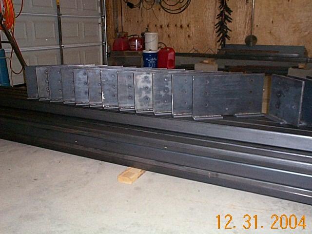

To answer your last question, securing the wood girts, etc to the steel will be a little more difficult than with wooden posts.
To connect the load bearing eave girt (the 2x12 double header that will support the roof rafters), I recently made some steel plates out of 10" x 3/8" steel plate that will support the 2x12s. These plates also have a 3" wide piece of 3/8" plate welded to the bottom to provide a bearing area for the 2x12 to sit on. So from the side, these plates look kindof like a tall, thin, upside down capital 'T'. The plates also have 1/2" holes punched in them so the 2x12's can be bolted in place also. The two 2x12's will sandwich the steel plate.
Here's a picture of the steel plates. You can see that the bottom piece of 3" steel is "notched" to allow the 10" plate to sit flush on the post and welded in place. I made the steel plates 18" long to allow for a large bearing area for the 2x12s and this also allowed the holes through the 2x12s to be moved a ways from the end as suggested in some texts I read.
For the rest of the girts, I'm going to run 2x4's horizontally along the length of the building. I will attach those to the poles with some "clips" that I made out of 2x3x3/16" angle iron, cut to 6" in length, with three holes punched to allow the 2x4's to be attached with deck screws.
It is certainly the case that the steel posts have required that I invest more time and $$$ in the building, but the $$$ wasn't too much in the big picture and the time didn't amount to much since I did all of that prefab during the dead of winter when it was too cold to be getting much done outside.
I'm looking forward to getting the plumbing rough in and concrete done so things can get moving again!
Mark
ps: The picture shows the steel plates described above. The longer ones are for "middle" poles which will have 2x12 headers on each side. The shorter ones are for the end poles which will have headers only on one side of the pole.
