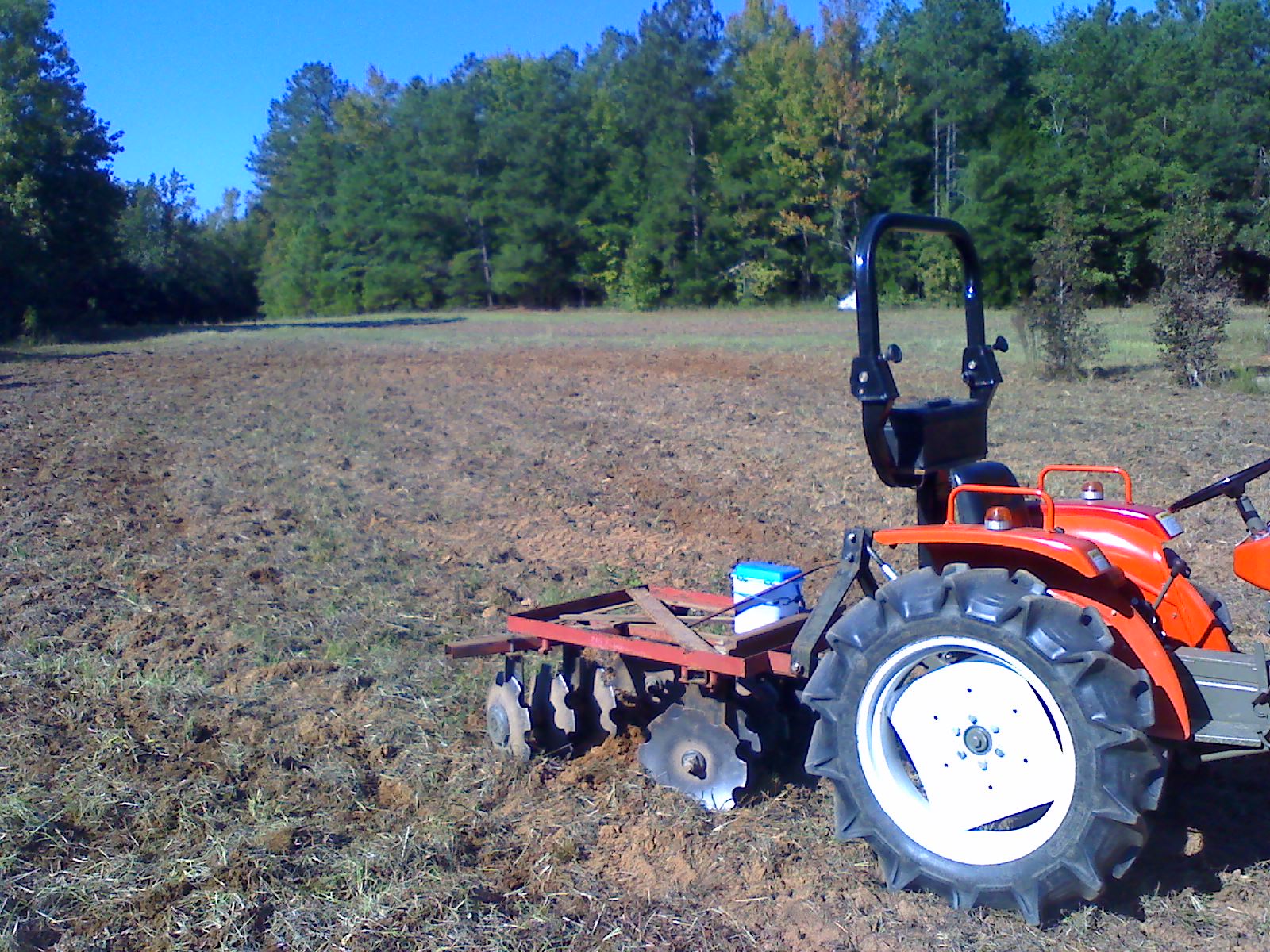

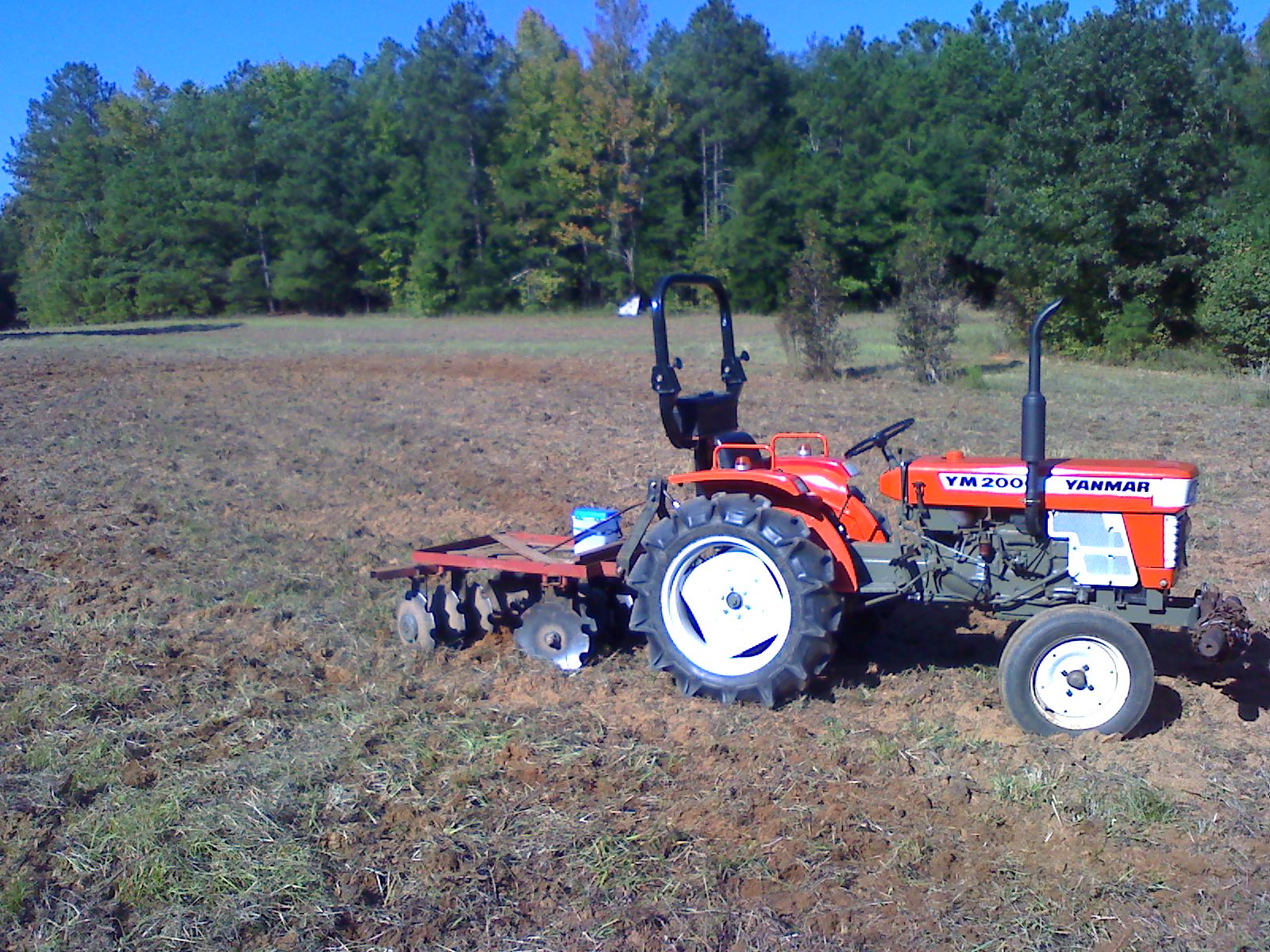

I have an LMC 12-16. Meaning it has 12, 16" disks. It is a realitively light one but not as light as a lienback cheapo. I have some pics of it some where. Im gonna try and see if i can find the pics of the field i did this last year. I think it is technically a 4.5 ft model. I have heard that you need to measure front and back and the avg to get what it really is. The front is like 4 ft and the back is closer to 5ft wide.
I have used a 5ft lienback and i could not pile enough weight on it and still pull it to make it cut deep. I pile about 200-300lb on top of mine to get it to cut well. I have modified my front bar bumper so that it now weighs about 150-170lbs to help hold the front down. The stuff i pile on it is some random 3/4" thick 4" wide random flat stock found on the family farm, a small gauge rail that is about 3 ft that is prolly from a local quarry that may be 50-100 yrs old, and a huge round cast iron thing that must be pushing 120lbs adn looks like a huge frypan? Oh and a square hunk of concrete that weights 70ish lbs.
I have added some pics. The ones with the tractor obviously show my YM2000 and the disk harrow. NOthing is on it (weights)as i was cutting in the seed here, thats what the random plastic tub was it had turnip seeds in it which nothing came up? There is still wads of grass in the areas with the tractor cause there was like 4"s of sodd and grasss to chew up. But it looks better than in the pic. The stuff in the foreground was only cut once or after the disk was lifted a bit as it was goin up hill and i really was not trying to do that spot. The pic with the deer is a spot thats been cut yearly missing only a few years for the past 8-10 yrs. It has to be offset about half a pass on the second one as it will be to the axles and stop the tractor, this spot is sandier/fine gravelier than the rest though. The last pic is the pic of the wheat and an oat that i planted, this pic was taken in april like the second week i think. I am waiting for it to drop seed before i cut and disk it. It was not fertilized or limed so its not that tall, pluss the deer grazed an eay 6-10 inches off of it.
After though: The deer pi and the grass pic are of the same spot just a different angle. The grass shot is taken to the left of the deer pic looking toward where the deer was kind of and to the top of the hill that you see in the back left of the tractor pic.

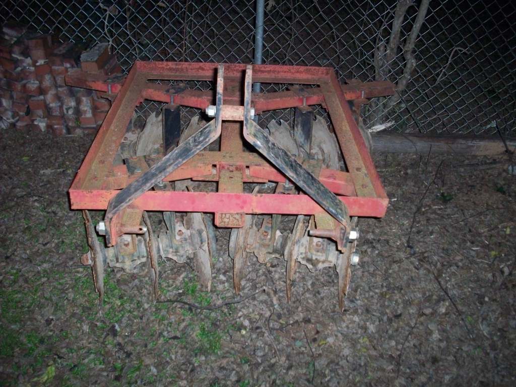

I pulled the pic out of my photo album here on TBN and saved it to repost here instead of posting the link and imbedding a pic, i hate to say as im not that savy (pretty embaressing considering im only 29).
You can see how the rear axles are wider than the fronts.
