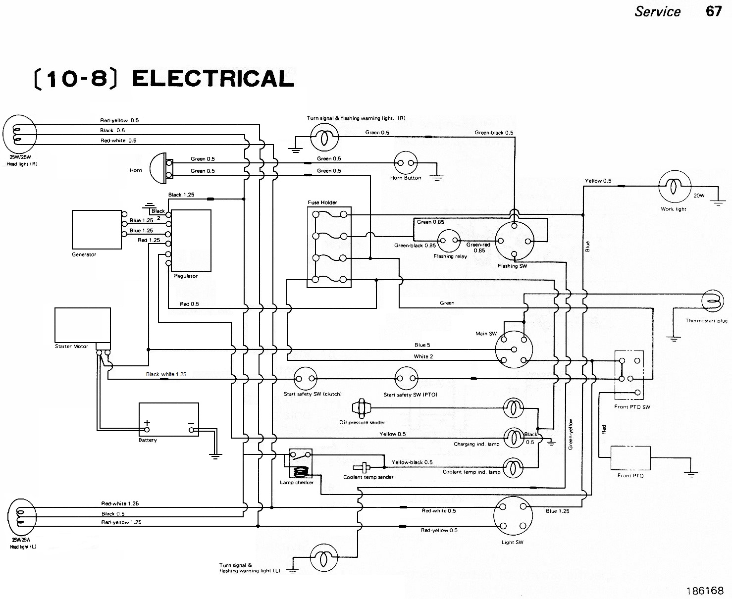

Dec 23, 2020 / YM186 Wiring Diagram - (from Service Manual) #1 California Super Star Member Joined Jan 22, 2004 Messages 14,924 Location An hour north of San Francisco Tractor Yanmar YM240 Yanmar YM186D

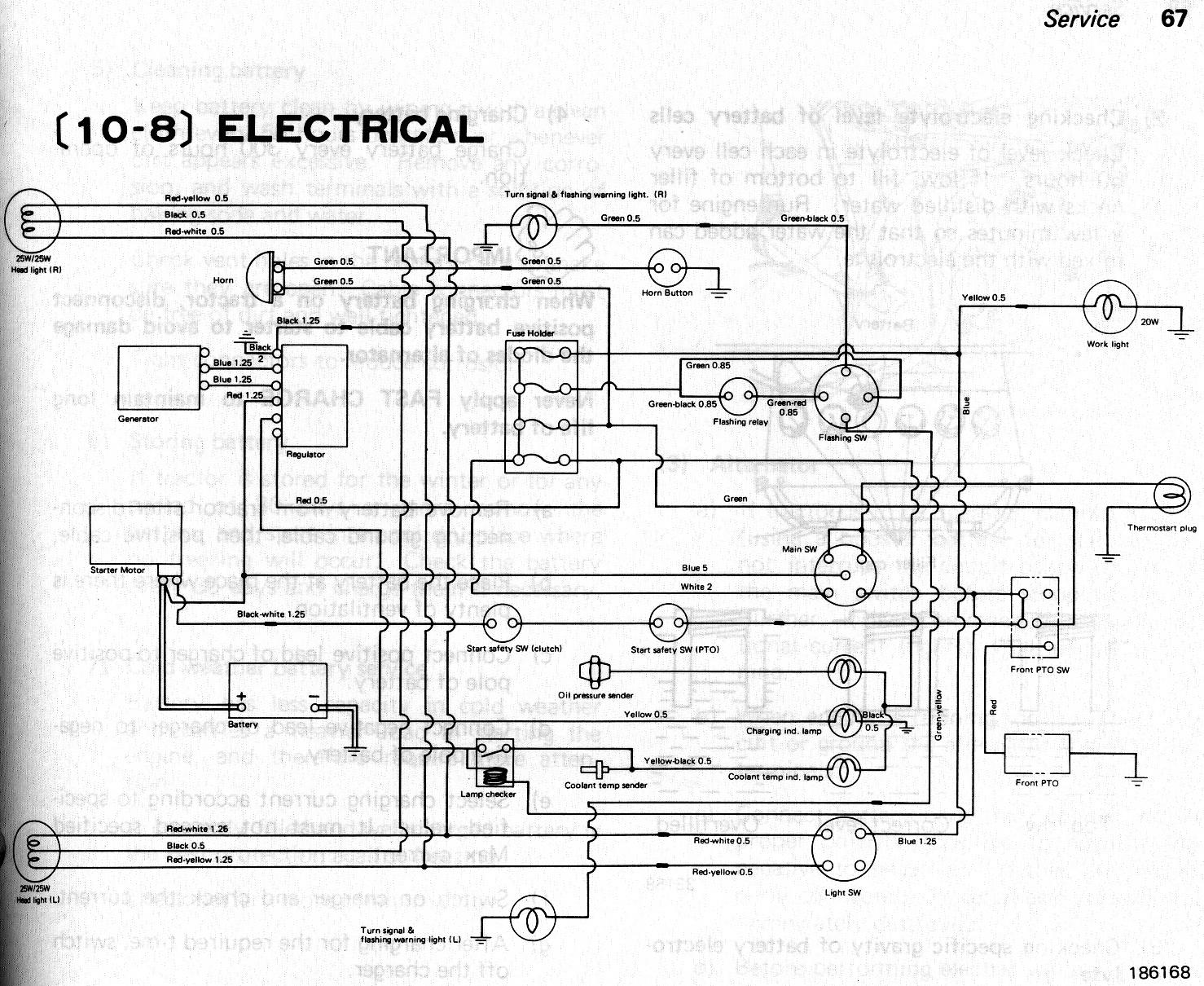

Dec 23, 2020 / YM186 Wiring Diagram - (from Service Manual) #2 bmaverick Super Member Joined Sep 17, 2013 Messages 5,697 Location Beloit-WI Tractor Yanmar YM2610 ■YANMAR GURU■ EXTRAORDINAIRE California said: View attachment 680816 Click to expand... I took it into another program to give it a tad bit more cleaning to read. Attachments YM186 Wiring Diagram.jpg 320.4 KB · Views: 170
Dec 24, 2020 / YM186 Wiring Diagram - (from Service Manual) Thread Starter #3 OP California Super Star Member Joined Jan 22, 2004 Messages 14,924 Location An hour north of San Francisco Tractor Yanmar YM240 Yanmar YM186D That does look better, thanks!
