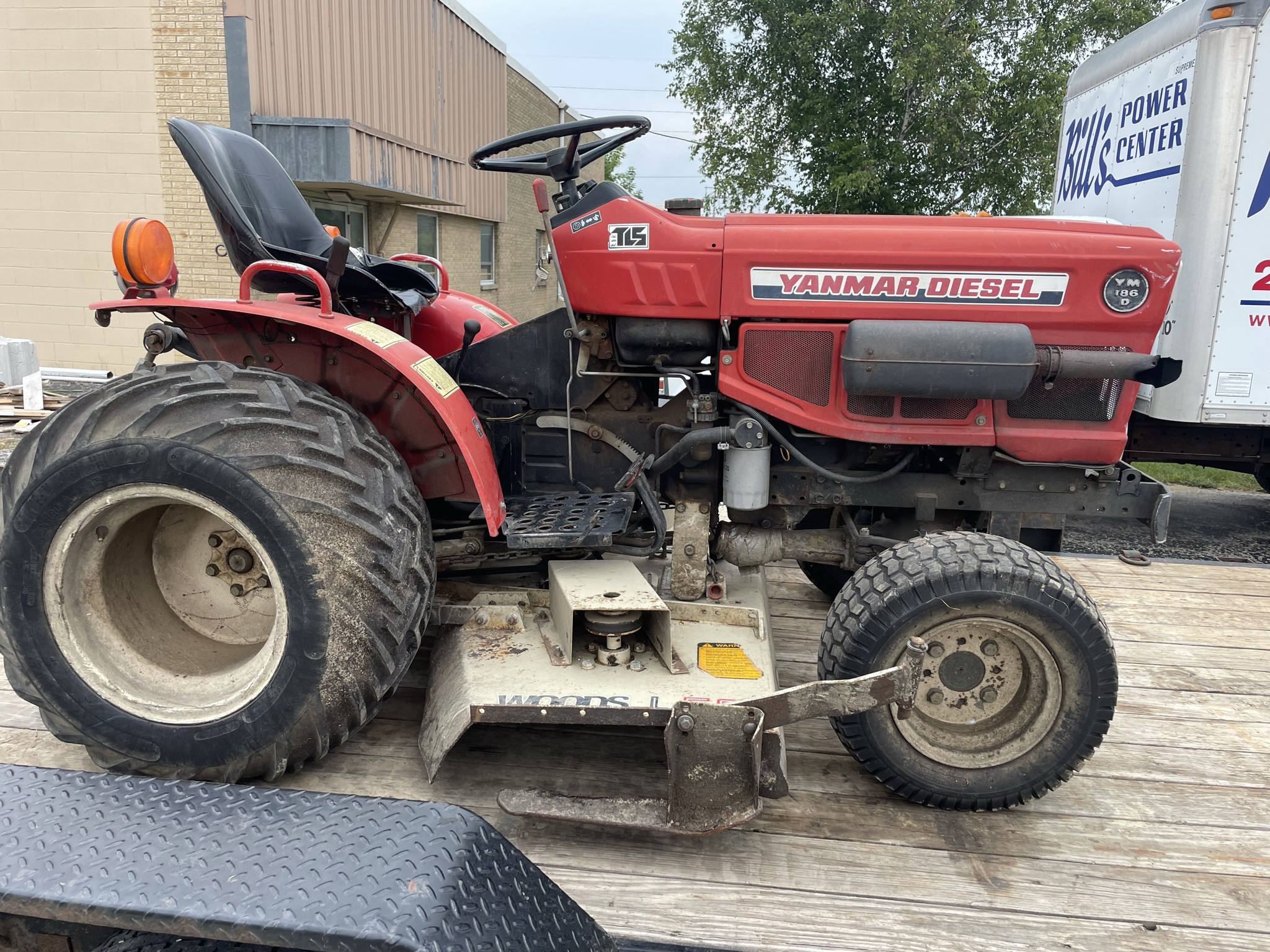

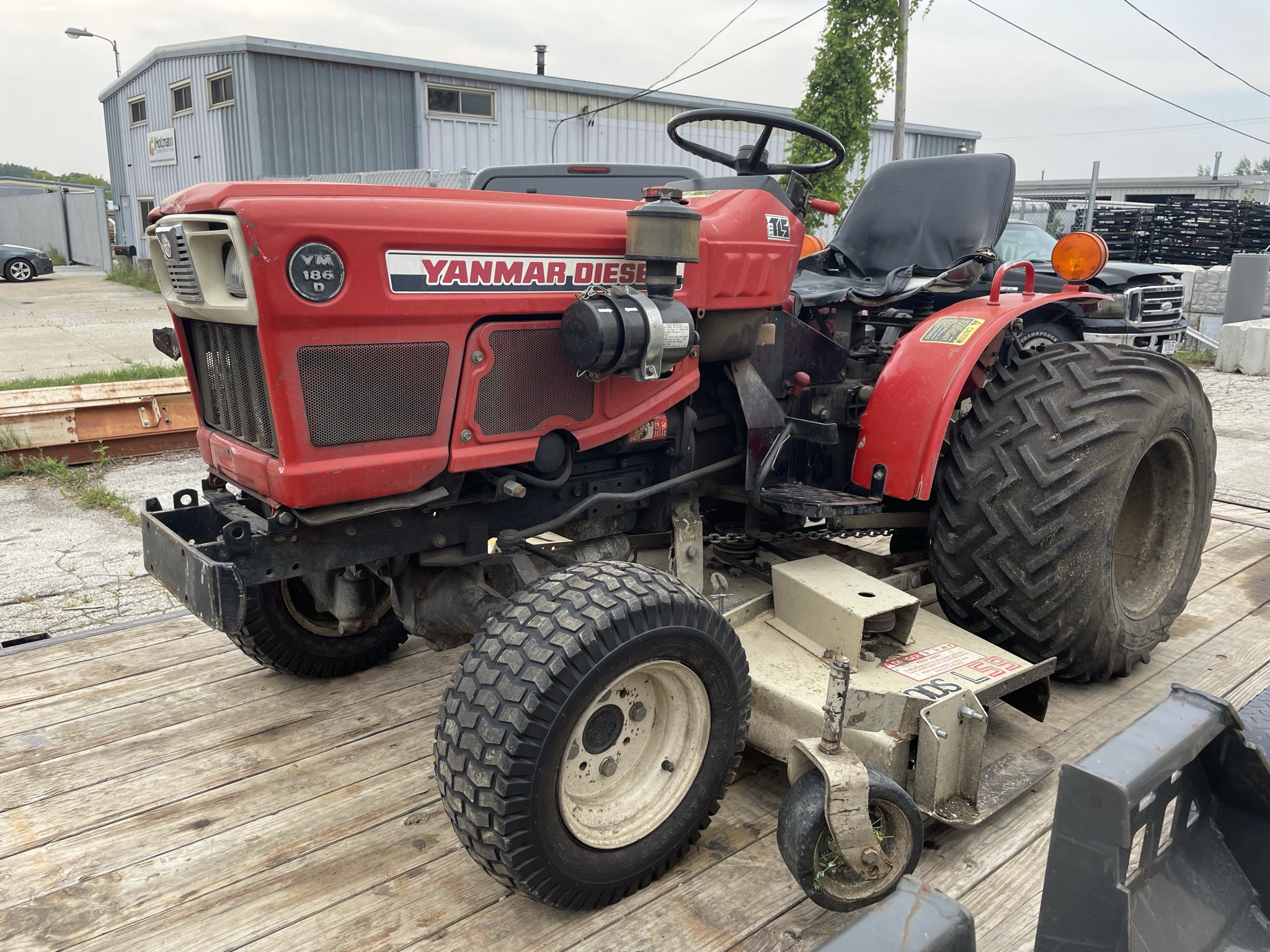

Hi Everyone,
I bought what I thought was a good deal on a Yanmar YM186D. I was so excited with the Power-Shift and 4x4, but it needed a front drive shaft. I called around to about a dozen salvage yards and no one has the shaft from the trans splined end to the pinned front axle. A couple yards do have the 186D on hand, but the front shafts are all gone. I talked to Hoye Tractor and they have some parts but they chop up the whole driveline and sell it piecemeal, and its not a complete setup for the whole shaft front to back. I also posted up on the Yanmar Facebook group, but no luck there either. I'm desperate at this point to find a front drive shaft and I'm turning here for help!
I'm really excited for this machine and to be able to use it fully! It looks a little rough now but I waxed one part of the hood and it looks like it will come back nicely. A few other little things here and there but I'm not worried.
Thank you for any help.
Respectfully,
Joel
