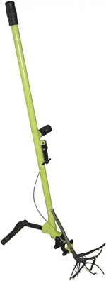

I have a Brush Grubber. As others have said, it works best with 2 people.
For "hand pulling", I have an "Extractigator". It works great on stuff up to 1.5" or so. I use it on Honeysuckle.
