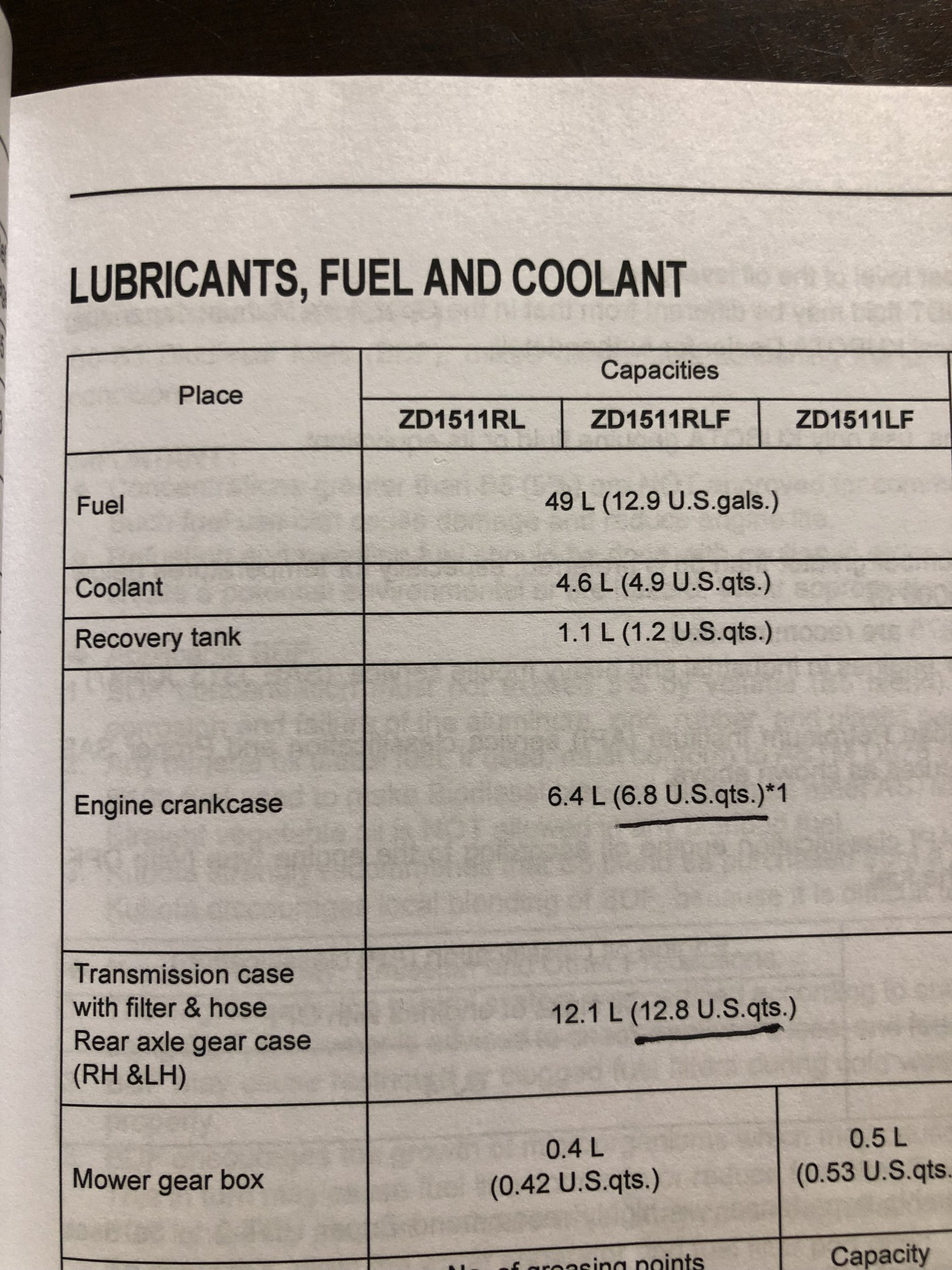

Well IF my ZD511 isn’t making oil (from DPF Tier4 BS) I DID overfill it with engine oil.
book says 6.8qts
It’s was 3/4” over the full mark although I’ve Checked it numerous times since I changed it back in the spring.
I drained both oil plugs, did not remove filter & poured 4.6qts in & it’s on full mark.
Little oil filter won’t hold 2.2qts so I’m thinking operators manual is wrong …. As my KTM 950SE AND F350 6.7L was also wrong
   / ZD1511 blowing white smoke on a hillside at times : Help
#9
strait out of my operators manual
I’m thinking no more than 4.8qts with filter change 🤷‍♂️
