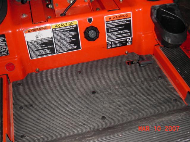

For my zd21, I took a sawzall and cut a notch out of the edge of the deck at the brake pedal. With that done, all you have to do is take a few bolts off to remove the deck. I think there are 7 bolts holding the deck down but I've only been using 3 or 4 with no rattles or other problems.
Oh yea, take the deck off before cutting :(
