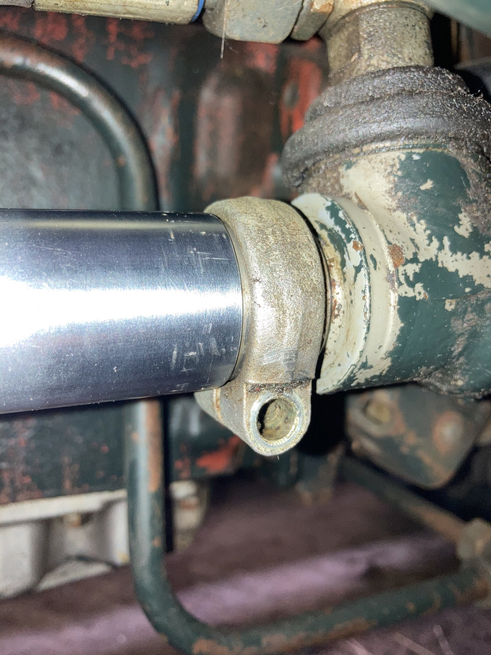

Hi, I have a 1989 Zetor 6211 for a few years now. I have done a lot of work to it over the years.
the problem I am having is when the tractor is running there is quite a dropping leak of power steering fluid from the power steering ram. It leaks from the beginning of the ram from what looks like a U shaped connection with a bolt that tightens the U clamp.
Is there seals in it or did anyone have this problem as well, I will attach phot (I have the bolt removed in pic)
Thanks

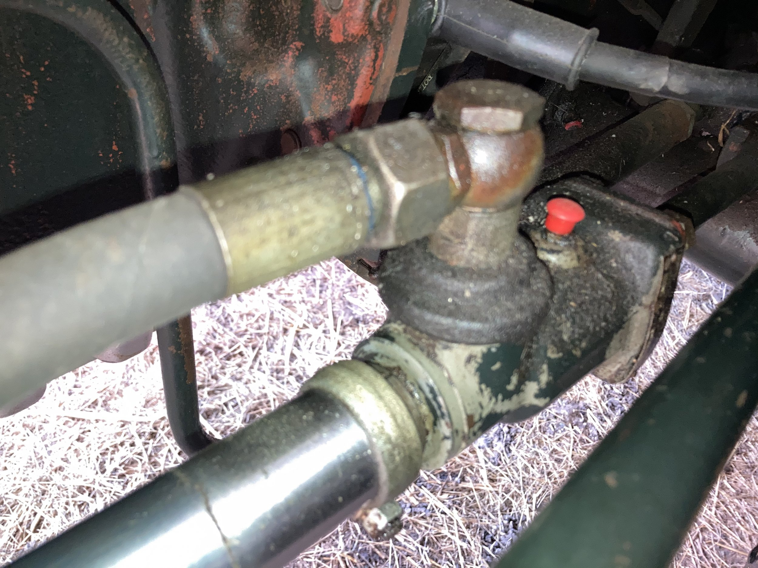

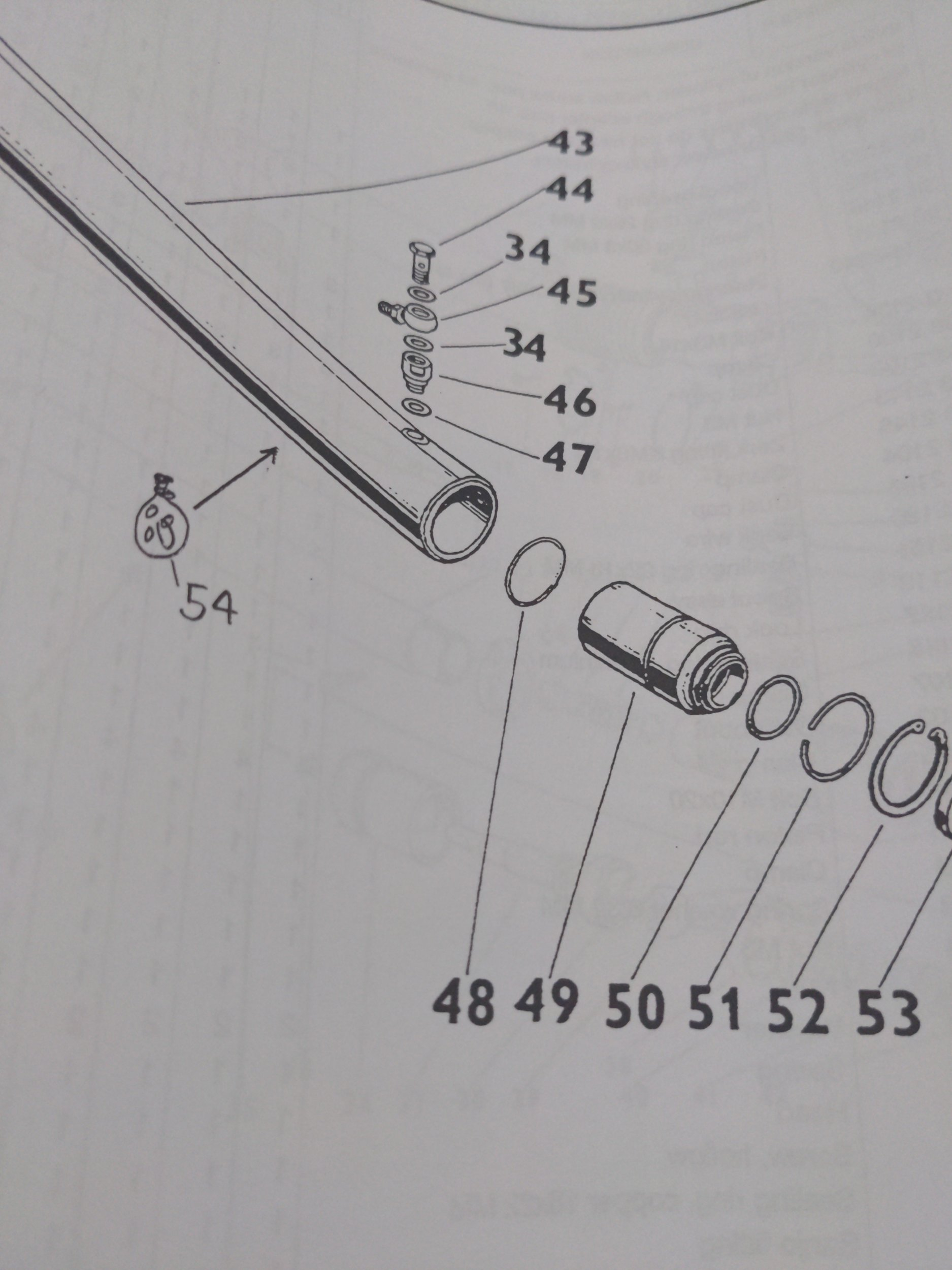

Does the hose that goes to the end of the cylinder housing screw directly to a welded bung or a screwed in fitting?
If it is the welded bung then a 938303 seal kit should cover you.
If it has the screwed in fitting then 938302 is your guy.
   / Zetor 6211 Power Assister Ram Leak #3
Screwed in fitting is 46.
Welded bung cylinder uses no fitting like below. 41 is the hose directly bolted to the cylinder

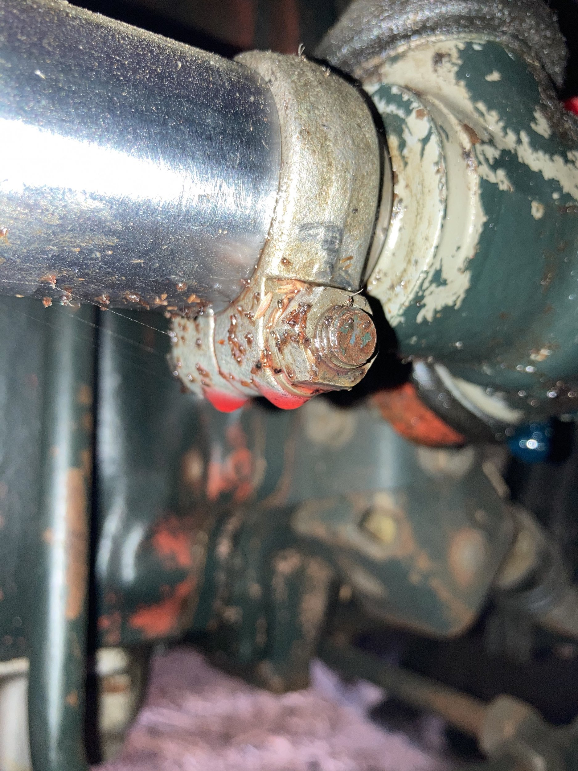

Hi thanks for the info, I’ll attach photos of the leak still.
Not sure about it as leaking from under the bolt. Thanks
