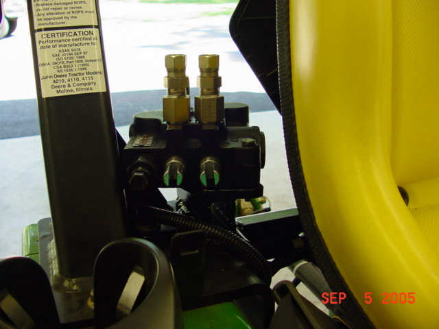

I added 2 rear remotes on my John Deere 4110 CUT, I used the Power Beyond kit from JD to access the hydraulics for the new valve.
The valve I used is a Danfoss valve purchased from the SurplusCenter
The first pic shows the mount I made and welded to ROPS x-bar. Rear View

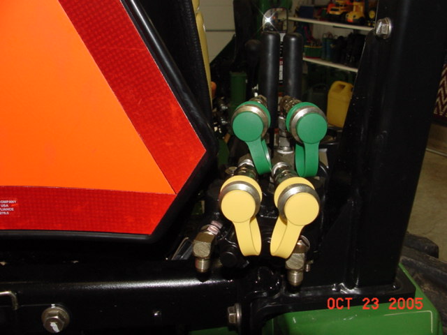

/ Rear Remotes on a JD4110
Test fit with the QD's and handles mounted, Front view.

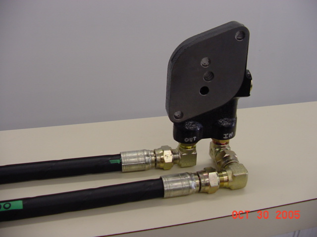

This is the PowerBeyond block ready to install.
It's all plumbed and finished, The vew valve fit perfectly in the small space between the ROPS and the seat.

/ Rear Remotes on a JD4110 #13
Very Nice! Your pics will be very helpful when I get around to doing the same thing! /forums/images/graemlins/smile.gif What did you use for handles on the valve?
#14
Thanks for asking, I had meant to include that part in the original post!
I had thought I could source the correct handles from Danfoss, Finally found a local dealer, and after 2 weeks of calling and them blowing me off, they finally replied with a cost of like $45.00 a piece! Yeah Right!
So I got some 5/8 round bar and made them myself, modeled them after the ones on the log splitters at TSC. It was a PITA to get them the same and work properly, but we all have unlimited time right?
So, after all said and done... I would have gotten this EATON-CESSNA valve from the SurplusCenter, They have replacement handles should one break, and the PB sleeve if it is needed in your application.
