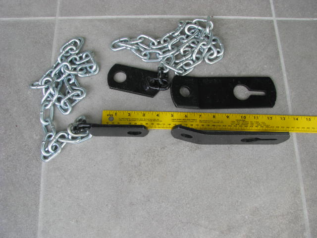

On tractors without position control, such as the B3300SU, position control is accomplished with CHECK CHAINS. This post is an attempt to suggest check chains and make rigging mower-deck check chains simple.
Photo #1 + #2 Zerco Check Chains I purchased mine from Steven's Tractor in Louisanna; fairly close to Florida. Agri Supply in Virginia also sells Zercos. $30 + shipping.

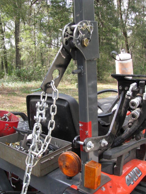

Photo #3 Directions Zerco suggests two grab-link adjusting brackets should go on cross pin holding inboard end of top link. On the B3300SU there are two cross pins and not much room. Attached to one cross pin adjusting brackets are an awkward fit and the chains lie at too shallow an angle. I needed a higher grab-link bracket position.

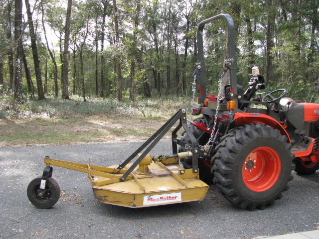

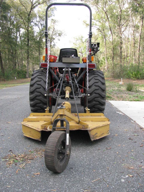

Photo #4 View 48" KK Rotary Kutter in raised/transport position. Check chains slack.
Photo #5 Closeup of Check Chains Adjusting brackets mounted to pivot bolts for ROPS; required 1/2" longer replacement bolts. Brackets stay on the tractor.
Note lighter chain extension attached with one clevis on each side. This is to give finer height adjustment. Chain "Quick Links" would not be strong enough splice in this application.
