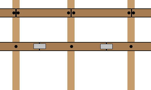

We would like to build ourselves a nice pole barn house (I love the look of barns, and the gambrel roof gives us space for bedrooms)
I'm at the research stage, I have a couple of books, I've looked at a bunch of the posts here about pole barns, and I've checked out some of the stuff on the web.
We're planning a size of 24' x 32', and this is where my question comes in.
In the book, it shows the main girts as being an unbroken length of lumber. I highly doubt I can get lumber that's 2 x 12 x 32, so obviously I'll have to splice.
I made a quick diagram of the two possible methods of splicing that come to mind. The first butts the ends together on a pole and each is held by a carriage bolt.
The second splices the boards somewhere in-between the poles, using metal connectors.
Which method is better? We're planning on using class 7 utility poles spaced at 8' intervals (20' poles on the outside and 25' on a line in the center).
Strength is very important because we are sometimes subject to high winds/microbursts from thunderstorms, small tornadoes, heavy snow loads, and even a chance of a minor earthquake. I'd like the building to have the best chance of surviving any one of those if at all possible.

16' girts with splice on pole, but alternate splices on each run. For strength, put angle bracing in a few places to resist racking. Method two with splices in between poles is ok but again, at least 16' girts there as well. Not a lot of strength with fasteners at the ends of boards.

I agree also...And I don't think carriage bolts are needed either. Good structural screws will be fine.

The carriage bolts are just for the main joist-supporting girts

OK, but still overkill. Take a look at the Picasa link in my signature for the building I had built. I didn't do it all myself because I couldn't buy the materials for what they charged me-and they did it in 5 days!

I would turn the girts so that the 6" dimension of the 2x6 is horizontal. This will keep your wall thickness down and is easier to insulate using standard 6" batts.

I recommend the 16' long 2-span girts with the frames 8' apart.
