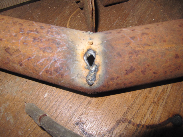

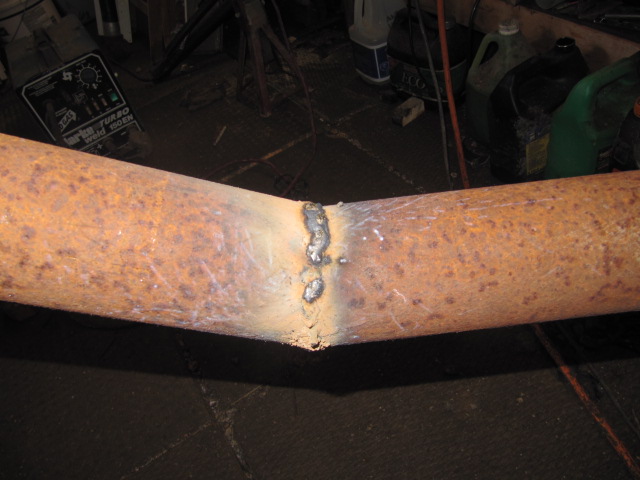

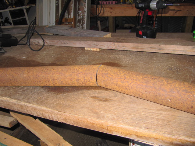

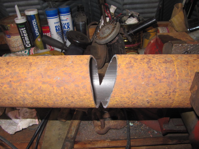

Here goes!! I'm getting started. Here are some pictures. I wanted to start the mounting platform for the pivot and control valves, etc, but since I don't have the right material yet, I'm having a go at the boom. I'm using a reciprocating saw to make the cuts and all went well for a little while - till the blade jammed in the work and broke. Kind of brings it all to a halt!
The photos:
1): First cut - free hand. 2): Closing the gap. 3): Yeah, I blew a hole in it.:eek: 1/8th" material and the welder operator is as rusty as the material, or worse!:p 4): I'll grind that down and try another layer over that. I'm not too concerned about the strength of the weld; there's heavy plate going on each side of that for the boom and dipper cylinders to mount onto. 5): The reciprocating saw before the blade busted.
What do you gentlemen think. Am I going to get the needed strength and rigidity from 3" x1/8th" tubing for the boom and dipper? I have lots of it and can go double if it is necessary. If bracing it will suffice, I can do that, too. I will lean heavily on the advice of builders with more knowledge and experience than I. If you tell me I am crazy,:D I will believe you and heed your advice (short of abandoning the project). If you tell me I am brilliant, I'll laugh just as hard at that as you will.:laughing::laughing:

Are you making a backhoe?
Excuse me if I have mis understood but I have very serious doubts on the stregnth of the 3" - 1/8" wall tube for the boom. Don't know how big you are making it, but 1/8" wall is not much more than a tail pipe. The round of the pipe will also make the attachment of the cyl. mount/plate difficult as you will only have one point of contact for welding. You say that you have a bunch of it, maybe you could horsetrade for a pc of sq/rectangle tube with at least a 1/4" wall. (4x4-4x6) Good luck.

Sorry, I should provide some more detail. Yes, I'm building a backhoe. It will be a small one, going on the back of a Craftsman GT 18. And yes, the pipe is little more than tail pipe - maybe something like driveshaft stock. The reasons I am even considering using it are: 1): I really have a lot of it, 2): I can double it if needed and that will give me more weld points, 3): I have 3" channel to use on the ends, etc.
I have had my own misgivings about how this tubing will work. That is why I have opened up the thread with the request for advice. I am looking forward to the same wise counsel I have seen others giving and receiving. Thank you in advance!

Pursuing plan B today! Scored some steel that should be stronger than I need. For the boom it is 5"x3"x1/4" and for the dipper 3" square by 1/4". For the platform for the pivot i got some 2" square tubing 1/4" wall. If I can sneak into the shop before the mosquitoes notice me I might get started on the platform.:D What is most likely to happen, however, is I'll get dragged off to help the wife get the garden in!:eek: Our weather has been so foul this Spring!! We are almost four weeks late getting into the garden because of wet conditions; try going in too soon - risk sinking in to your axles. I was finally able to get into the garden with the cultivator to open up the soil so it could breath and dry out a little. I had to do that twice before I could use the rototiller. Now if the rains just stay away for a couple more days.....:):thumbsup:
