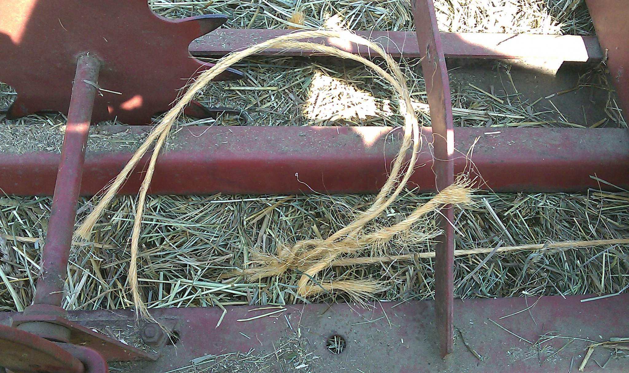

Knot in one end but not the other-last time this happened to me,it was because the twine finger wasn't catching the twine and it didn't get to the knotter when the needle brought it up.

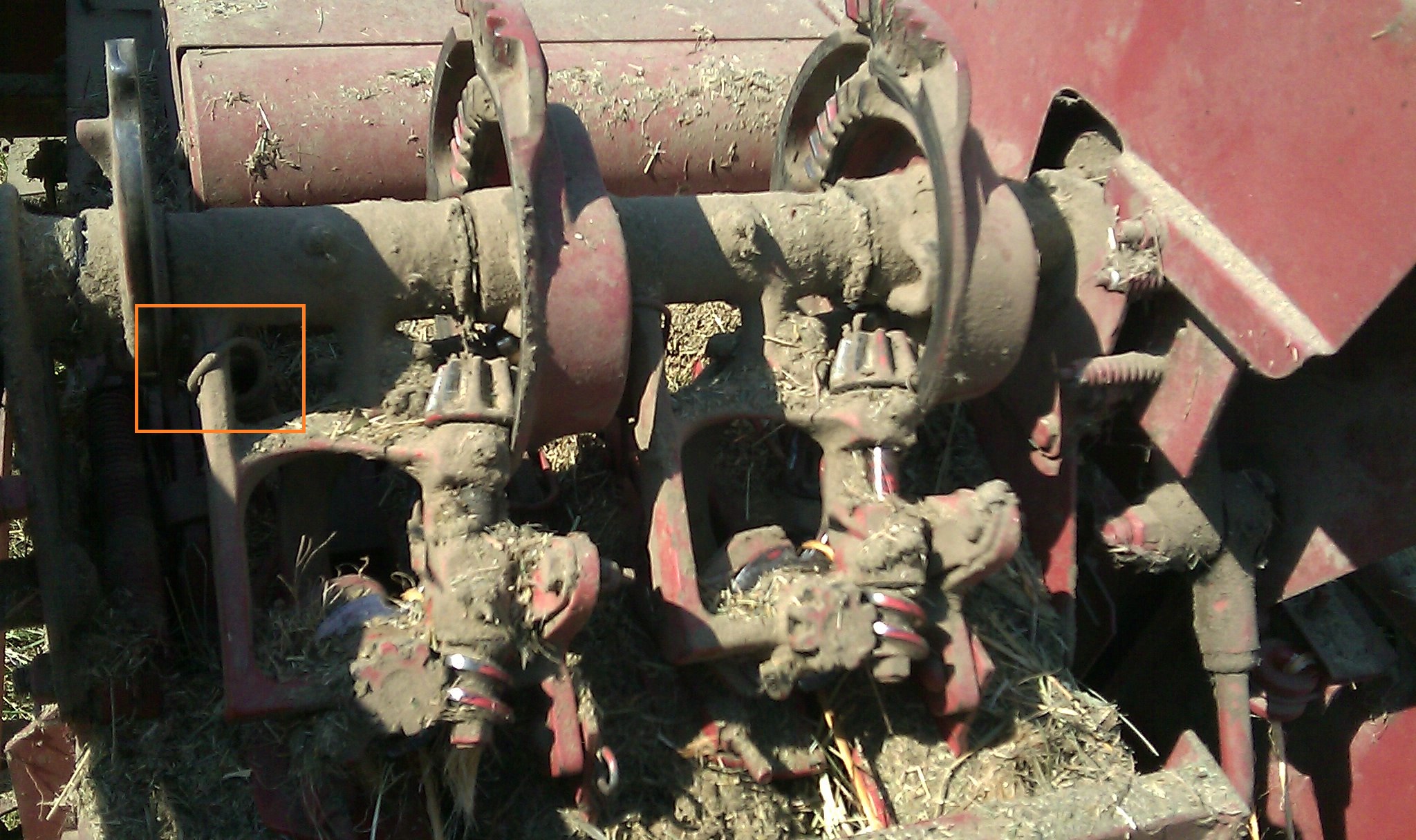

That spring sounds like the twine finger spring and that not being there could have been the problem. The guys are giving you good information. Remove the knotter lock bolts and roll the knotters back and take a look and have the knot removal half moon plate brushing the bill hook firmly. The knife arm is bendable for adjustment. bjr

I greased the knotters and after that we only had a couple of misties in ~550 bales.
Here is the knot that it was tying (2 blown bales, then this one):
Knotters:
The spring that I replaced is highlighted with an orange box in the above picture.
Talked to one of the guys at the Kubota dealership (he was unloading hay for one of our customers) and he is going to get me the number of someone who does onsite tractor work an is supposed to be very good with balers. We'll have him give this one a once over, then look at the International 440 that wont clean the knot off of the billhook on one side so that we can get it working and sell it.

   / NH 273 baler misties one side of some bales #8
Only one twine finger return spring is required. Adding a second won't improve or hurt anything except add a little wear to the twine finger cam follower bearing.
#9
That is the spring I circled in orange? There was one on each knotter and the one circled in orange broke (the "hook" snapped off of the end of the spring) and I replaced it a few hundred bales later when I stumbled across another one in the toolbox.
