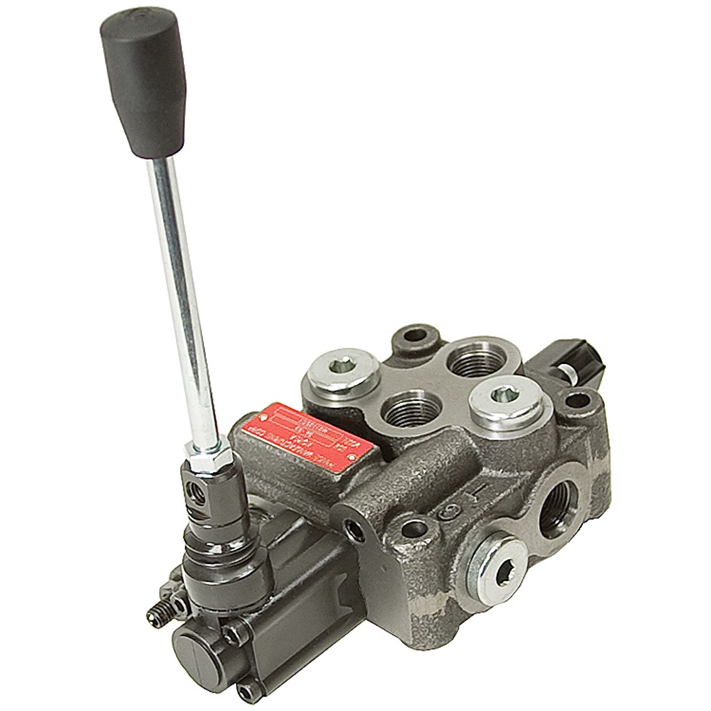

So LD1s thread has motivated me and I'm interested in setting up something similar to what he has done but with a single valve for a hydraulic top link. I have virtually the exact same tractor as he does and I am wanting some help picking the correct valve, I looked briefly but there are so many different styles I have trouble making an informed decision. The biggest thing I require is a float for mowing and working a harrow but also the adjustability would be fantastic for pulling a subsoiler or my root rake. My MX4800 has a 9.5gpm flow.
   / Single remote with float for top link
#2
Kinda looks like this here may be the ticket.
Shopping
#220125 at bailey's incase the link doesn't work.
   / Single remote with float for top link #3
Certainly looks like that valve would work.
Like I said, in a single spool you have slot more options.
Something 10-15 GPM is about perfect. Not too big and not too small. The 1/2" work ports are perfect size.
Basically you need to make sure the following...
4-way valve with 4th position float......Check
10-15 GPM.,......,................. Check
Power beyond............ Check
Tandem center............Check.
That's the short list. There are dozens of valves that fit that. Pick your price and brand of preference. Don't forget the PB cartridge which is usually sold separately with whatever you choose
