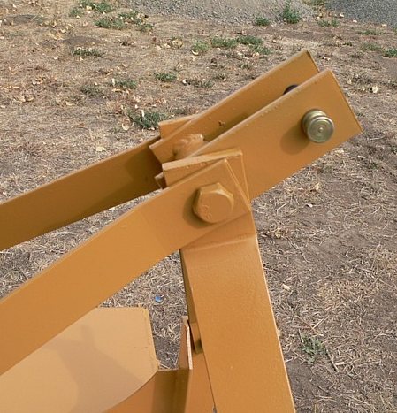

How important is the flexible top link shown in this pic? I notice some people use either a chain or this flexable link.
I've used bush hog type cutters for many years without one with no apparant problems, however I may have been in error. /forums/images/graemlins/shocked.gif If so I'd sure like to know what the reason is to use one. /forums/images/graemlins/confused.gif

If your ground is perfectly flat, no need for one. If you carry your rotary cutter, and don't set it on the wheels, then no need for one.
But otherwise, it's much easier on the cutter when uneven ground is trying to push up the rear of the cutter, and restricted by a fixed linkage through the top arm.
For me, a chain works better and with more flexibility than the short flexible link shown.
All your choice, however.

<font color="blue">....it's much easier on the cutter when uneven ground is trying to push up the rear of the cutter, and restricted by a fixed linkage through the top arm.... </font>
Roger that, makes sense. I wonder though since the side arms on the 3pt will freely move up anyways why there would be any strain. It would seem if the back wheel were to raise over a bump that the entire deck would pivot on the lower arms? /forums/images/graemlins/confused.gif
I can see where some flex would make for a better more even cut, my concern was that I may have put undue strain on the tractor housing, but from what you say probably not.

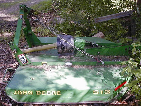

I think with no chain or loose link in the upper support system, when the rear wheel of the rotary cutter raises, it puts a lot of undue compression on the 'stiff' linkage. In fact, it will bend the support bars (strap steel) that connects the top link to the rear of the cutter deck (at least it did on my Deere RC). I replaced these 'bars' with chain.

Unless you're mowing a billiard table, it's extremely important. With that type, you have a transport position and an operating position. For transport, you shorten the toplink until it's drawn up tight - with the flexible bracket pointing towards the tractor. Once you get to where you're going to mow, you lengthen the toplink so that the flexible bracket is pointing straight up. That permits the bracket to move forward and rearward as the mower deck floats with the terrain. That way there's no undue strain on the metal straps mentioned above either. When you're done, shorten the toplink, lift the mower, head back to the barn.
FWIW, I don't think chain makes a safe permanent replacement for either the toplink or rear lift linkage. The only thing I use chain for is if/when a tractor needs lower lift arm stabilizers.

It's what cutter doesn't go over that causes front flip. Like hanging it up on hidden stump. Large cutters can be hard to load on some trailers if there isn't a flex point somewhere also. Some, like mine, have chain from A-frame to the rear for flex.
