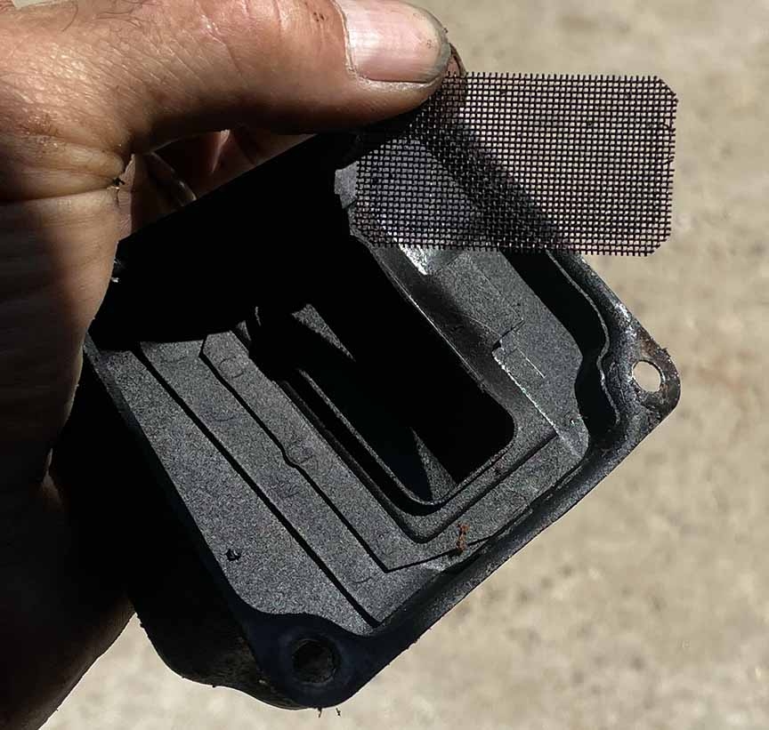

Screen is clean, dangit I was hoping for an easy win.
   / 028 AV Super spits gas out of the carburetor #4
Does that model gave an intake reed valve assembly between head and carb? If yes check to confirm that the reed valve is closing properly to prevent crank pressure from pushing out the carb.
Exhaust screen was not plugged at all.

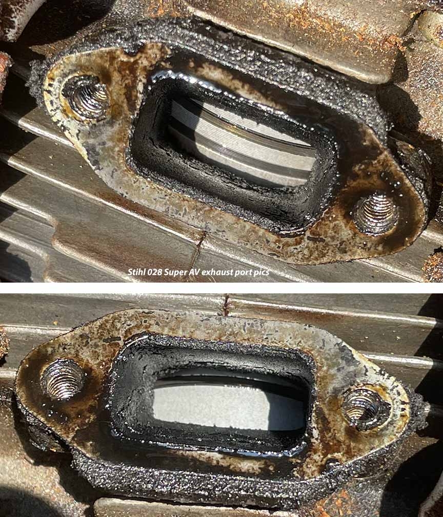

No reeds. Piston looks perfect, almost like new.
Took the carb apart and found the filter was plugged with very fine “stuff”. Almost like an algae or something. Shot starting fluid at it and it was gone instantly.
It seems to run well but haven’t put it “into the wood” yet😉. Tomorrow.
