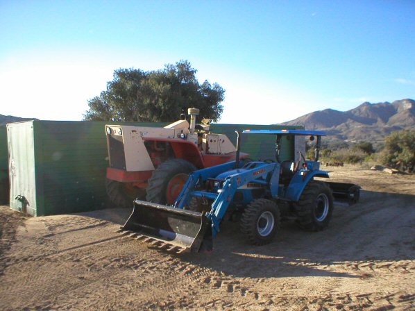

We just bought this Case 1200 for $4500. It needs tires and a seat. This is a true 4 wheel drive that is not articulated, has 4 wheel steering, turns very sharp, 120hp.:)
