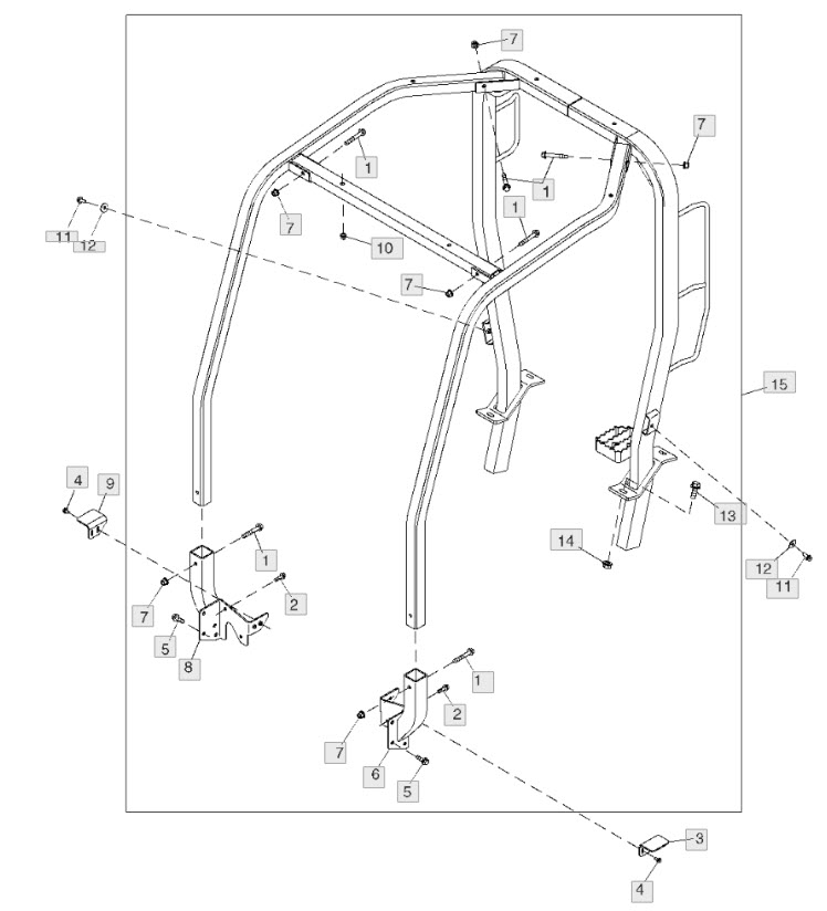

My tractor is 300 miles away. I am considering bringing it home to do repairs but winter is coming and my shop has only an eight foot high door.
Has anyone removed the ROPS? Is it possible to do in two hours or less? Is it at all possible?

Below is the parts illustration for the 110TLB ROPS structure. Does this help?

From the diagram in post #2 it certainly looks to be easily removable.
The ROPS for my Kubota L48 is quite similar, and I removed it in about an hour (needed help lifting the steel canopy off).
I have plenty of building headspace, but I keep the ROPS off because of low hanging tree branches.
   / 110 TLB ROPS Roll Bar Removal #4
Keep in mind of the electrical you'll need to deal with. Might need to make up some quick connects if it's going to be a ongoing removal
