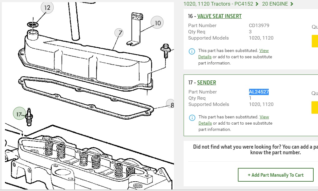

I have two questions as my manual doesn’t explain/answer them
-Where is the correct location(s) for the water temp gauge sender?
- I read that on 1020s they moved them from the head to the block. Does this apply to the 1120 as well?
   / 1120 water temp sender. #2
Looks like on the head.. per jdparts. Same for both..

   / 1120 water temp sender. #3
1020's built for sales in N America had manual temp gauge with capillary tube that fit in rear of cylinder head.

I was asking about the location because I theorized perhaps the temp probe on my new mechanical gauge was picking up some additional heat from the casting being closeish to the exhaust port when installed in the location shown in the drawing.

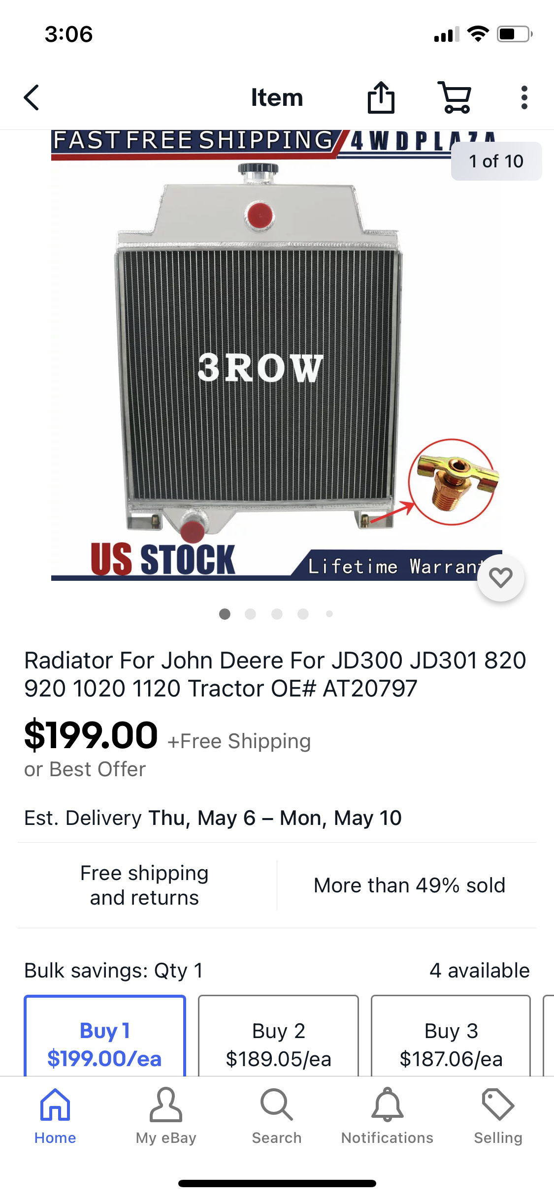

As a follow up to this issue, I’ve ordered a new aluminum radiator as my current one is leaking(damp core, no drips).
I’ll update with results.
