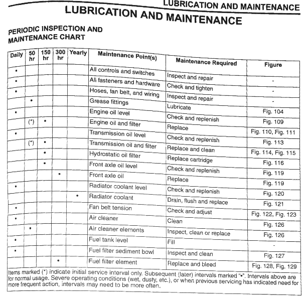

Called dealer to see when I should have the hydrostatic system serviced and he didn't think it was until around 300-350 hours, but he wasn't sure. Does anyone have an operator's guide or know the recommended service schedule for these?
I have a 1528, hydrostatic.

The 1529/1532 Manual has 50 hours for the first transmission
oil and filter change - then every 300 hours from then on.

Thanks for the reply. Thankfully I found mine last night, and I made a PDF version of it too. It states every 150 hours for transmission fluid and filter.
Just in case anyone else ever needs it. This is for 1528/1531.

I put a premium fluid in my 1540 and just change the filter and oil once a year along with all the other filters and engine oil.. if they sit to long in our great state you get a lot of moisture build up
