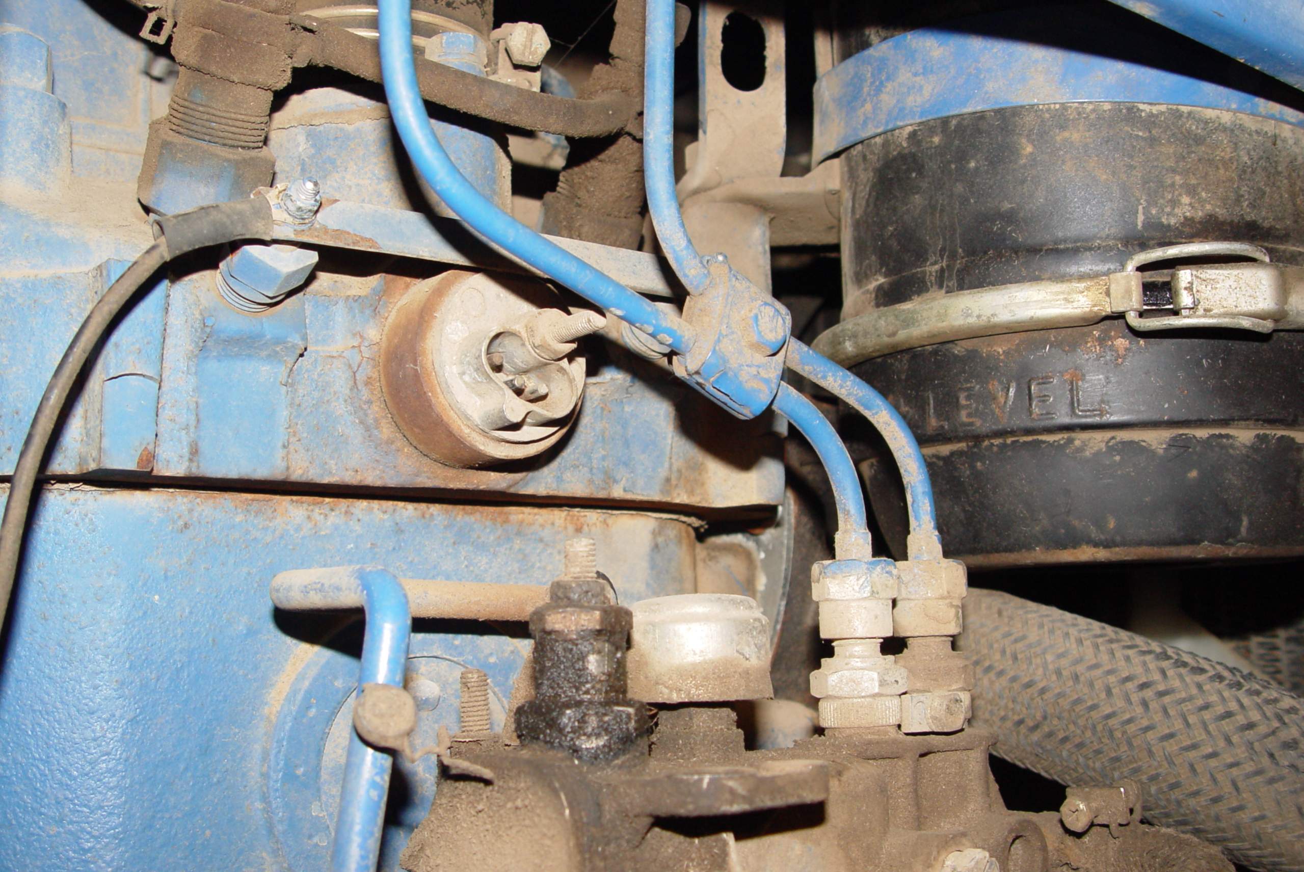

Well, the thermometer says 7 degrees right now.
Had my NH 1720 tractor for a few years, it starts well in cold temps, but if we are starting this cold this early.....
I don't seem to find any frost plug heaters for my model. A tank heater seems to be a pretty big thing to try to hang on this lettle tractor.
The magnetic heater I have doesn't seem to do very much.
What are my options? Help?

I have a block heater in a engine plug that works quite well by heating the antifreeze. I got it installed by my dealer when the tractor was new. I think they still sell them. I only plug it in for 30 minutes before I need to use the tractor. I would be very causious about using a dip stick heater. In my opinion (just my opinion) they boil the oil and ruin it. It certainly could not be left on for an extended period of time.
https://webparts.pvassociates.net/cnh/webparts/main.php
Kit, heater engine coolant, part # 86590117

I want to heat the coolant; magnetic heaters don't seem to have enough oomph for a Minnesota winter, and likelwise with the oil heaters - they tend to char the oil if they output enough BTU's to do any good.
My problem is in trying to locate a frost plug or other style of heater for this particular model of tractor. I just don't see it listed on the common charts of heaters?
I have tractors with tank heaters, and a couple with the lower radiator heaters. But the compact size & nature of this tractor lends itself much better to a block heater of some sort, if I could find one.
I'm just drawing a blank in my research.
Added: Caught your reply after I posted JC - I appreciate the idea, but this tractor starts on it's own when it is about 5 degrees out. I think that's pretty hard on it, but - it's pretty impressive. When it is that cold and colder - I've had to run at minus 15 - then a couple 100 watts just doesn't do it. You need the head warmed up in addition to the crankcase, so the air drawn in gets a little heat to get started. I've had a 100 watt magnetic heater on the belly of it for 12 hours, and can't really notice that it did any warming at all, doesn't start any better, so I think at my temps, I need a little more oomph than that.

Rambler, New Holland still sells them. I furnished the part number for you. If you go to the link I listed you will be able to look it up.
   / 1720 engine heater
D'oh. I was reading too fast, skimmed it & I think I took that as a tag line thing instead of help.
Thank you, appreciate it. What I was looking for. Your link must need to be logged in as a dealer, but the part # is all I need.
Need to slow down & enjoy life, actually pay attention I guess! :)

Pictures of my heater on 1700. The part number I gave you was for 1720. Pict #1 core plug unit. Pict #2 is for cord only. Hope it works for you, click on thumbnails to enlarge picture. Ray
