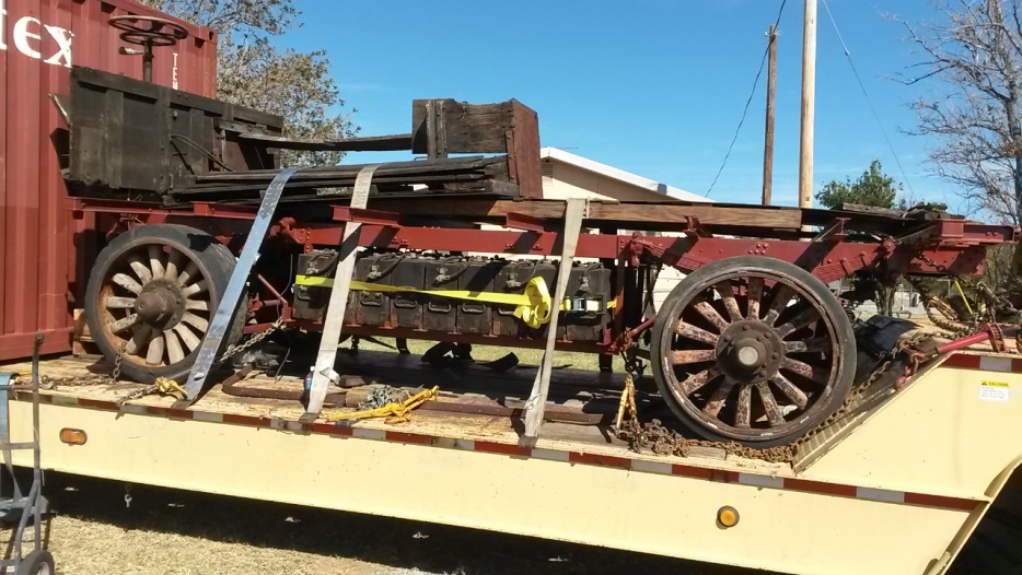

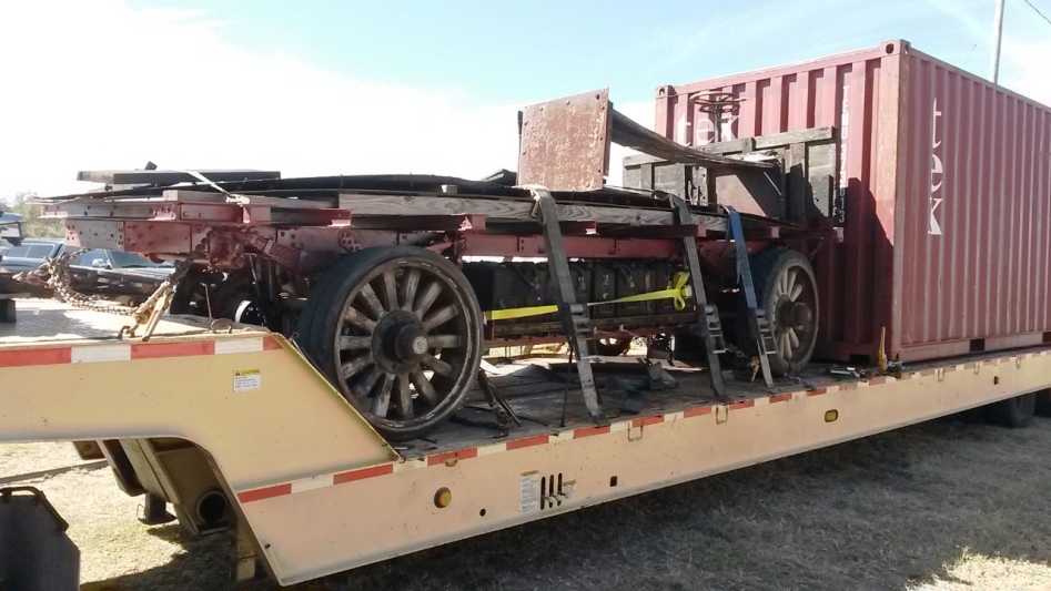

A good friend of mine sent me this to store and eventually restore for him
It is a 1916 5 ton truck made by the Commercial truck company
it was used for half a century almost to haul coal in Pittsburgh PA or that is the story I have on it

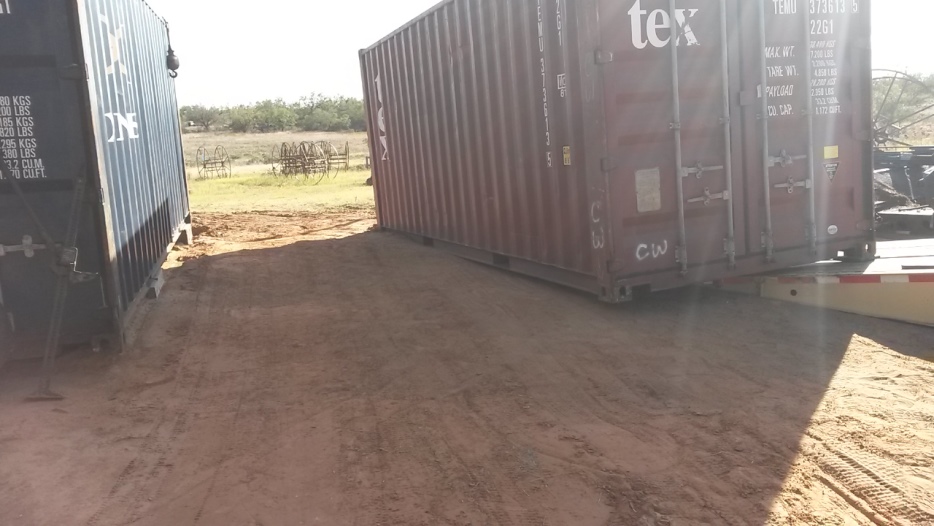

And this is where I will construct an enclosure to store it

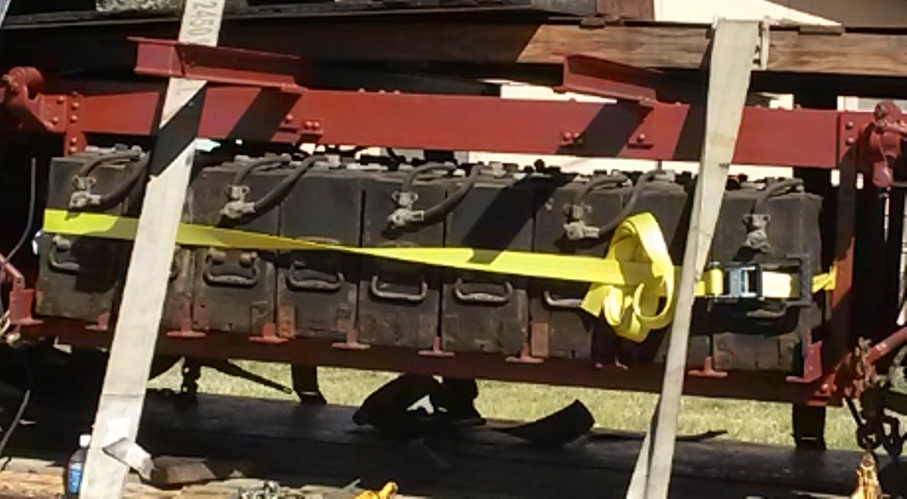

Before you get too far, get some litmus test strips and determine if them batterys are Lead/Acid or Edison battery. Edisons use iron plated and caustic and can get very nasty very fast.
Thing about Edisons is dey can retain charge for very long time. Voltage check of each cel strongly recommended.
Either way, dey probably rubber case from look of pictures so dey gonna be brittle.
Truck back den totally different thing. Other then Mack most trucks were built up at dealer from components de buyer wanted. Number of cels on dat frame indicates truck was definitely a long distance carrier.

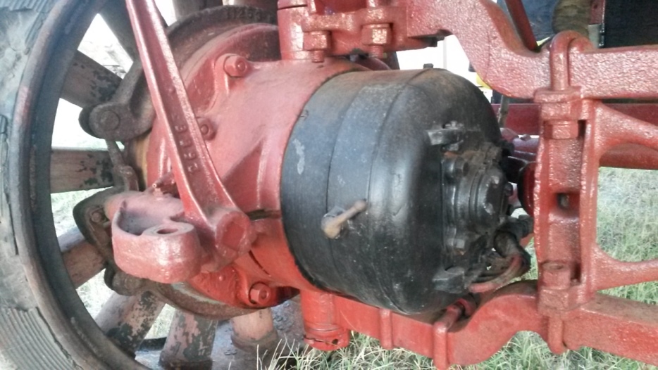

Also want to look for cast iron resistors and handle careful, Dey be like glass.

The Batteries are Nickel Iron 6 out of the 9 still took and did hold a charge for a couple of years or this is what I am told since I did not do the charging of them I have no way of knowing how the man to was working on them did it. I think other than just pouring in distilled water he had simply put one at a time on a charge using an older dumb charger. The 3 that wouldn't take a charge also leaked so the rubber bottles must be damaged.
They were made by Gould as is indicated on the cells and plaques on the boxes containing the cells
I heard but have not verified that there is a company in Connecticut that will take the batte3ries completely apart make new bottles clean and refurbish or replace the plates or tubes in the cells make new boxes refill them with the proper electrolyte of potassium hydroxide and water charge and test them then return them for around $2000.00 per battery and warrantee them.
Knowing what it takes to refurbish the individual cells of a 48volt forklift battery having helped to do some made of lead acid myself, I would consider this a bargain.

How many batteries does it have?
