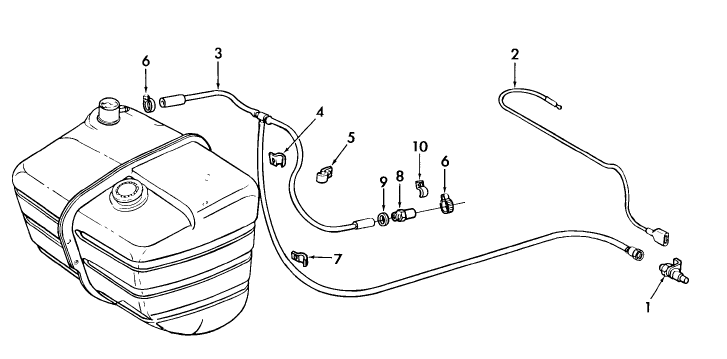

I have a 1995 Ford/New Holland 5610S. Its a hard starter in the winter. I was digging around and I have a glow plug / thermostart plug in the intake manifold. However, I do not have the system or fuel line going into the end of the thermostart to supply the fuel to the plug. My understand is it needs the fuel in order to create fire inside the intake manifold to warm it up to start easier in cold weather. The glow plug / thermostart on my tractor is functional and heats up when I hold the key just past the on position for 30-45 seconds. Am I missing anything or is this not how it works? The parts guy at the New Holland dealer didn't seem to know much about this but stated that the glow plug doesn't need a fuel line to it and it should just warm the intake manifold up and it should start even if cold. I can't seem to find the parts for the 5610S but can find something similar for the Ford 5610. I have attached a few photos. Please help!!!!
This photo is of the set up for a Ford 5010S
This phot is of a ford 5610 and supposedly not a 5610S

Sounds like he逞エ not old enough to remember how the thermostart system works, yes it needs a fuel line, after the element reaches a preset
temp, it opens a valve allowing fuel to drip in causing the fire to start. If you look at your manifold, you should see a male terminal for the wire, and a fuel line fitting for a line to screw on, is this not what痴 there?
Item #13-1 is the unit

From the link you shared, I can't tell where that line from the plug runs to the injector pump. Do you have any photos of that?

I don't know as always poorly drawn!, I would think you'd just "T" into the excess fuel return line like they've always done, the later ones even without the reservoir, my 345C only has a "T" that is up hill from the element to provide flow
