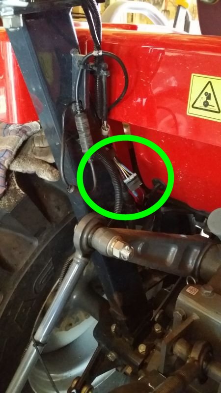

I plan on throwing some lights and a toolbox on the ROPS (without drilling or cutting). Just gotta find a good spot to wire into! Thanks!

I don't have an MF 1526 but I do have a 1529 and so I thought I would share what I found when I wanted to power some electronics on my tractor. Hopefully yours isn't that much different.
In the attached photo, you will see the multi-pin connector near the left side of the ROPS on my 1529. If your 1526 also has this plug, you should be able to use it assuming you don't draw excessive current. If you also have this plug, your owner's manual should show it on the electrical diagram and you can see what it is fused/rated for.
   / 2019 Massey 1526 #10
Hello...the 1526 also has the trailer plug on the left side along with a wire (live) on the left side and one on the right side under/near the fender. you will need to ground the light(s). Both are on their own fuse... My ROPS lights are connected to the power on the right side rear and you will need it switched as it is live power.
