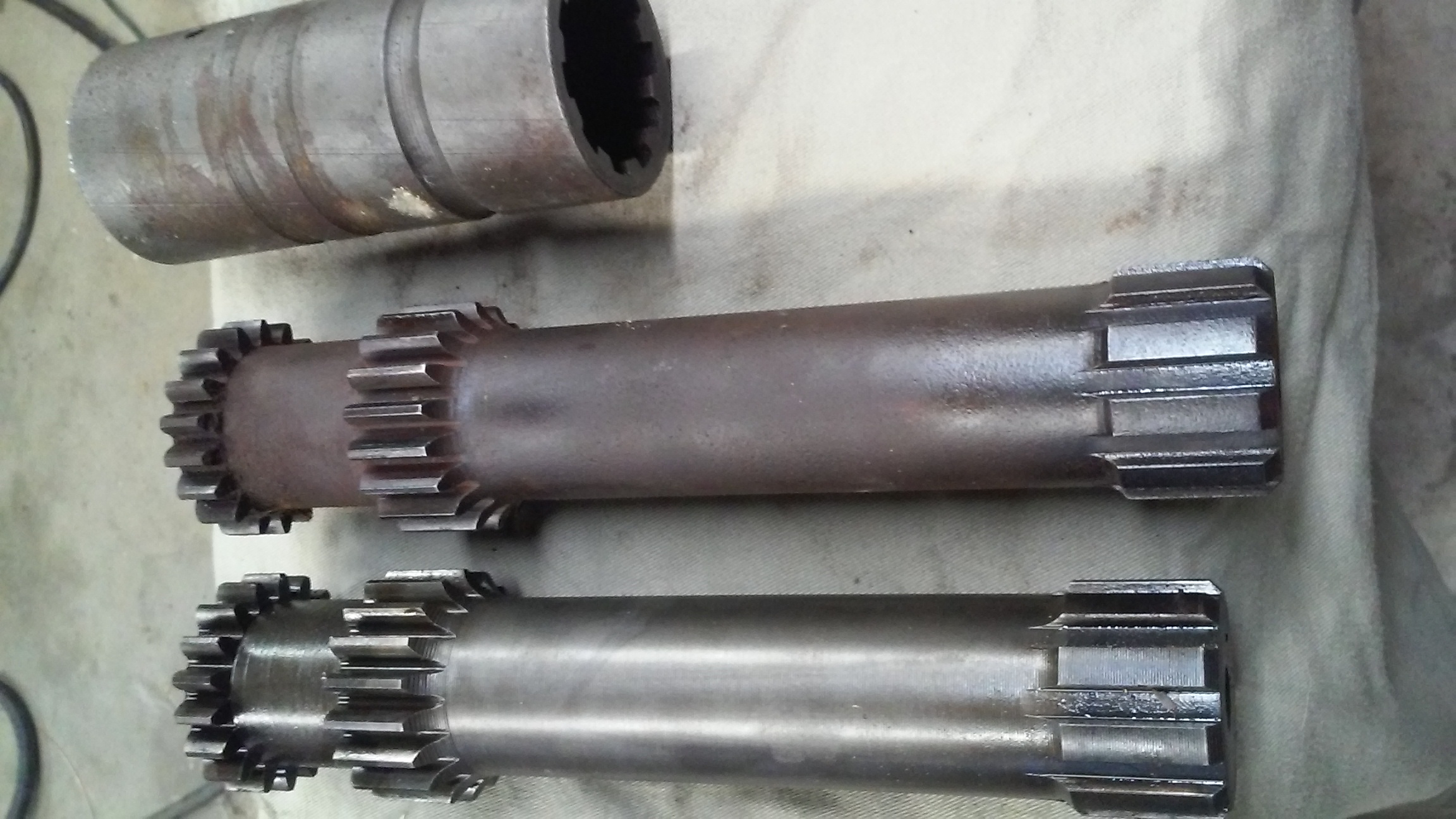

I'm hoping someone can help identify the correct style drive shaft and coupler assembly for my MF202 .The parts were lost during a move while the tractor was partially assembled so I have no samples to go by. I've tried researching this for hours going online ,forums, service manuals and parts manuals I even contacted my local MF dealer and they quoted over 300.00 to bring in a new one, they also have used at a fraction of the cost, but identifying the correct style is still an issue.
From my research there appear to be at least three different lengths one is 8 and 23/32nds inches long the other is 9 and 3/16ths inches long. One style has continuous splines at each end with the other having three sets of splines spaced apart as shown in these pictures.
