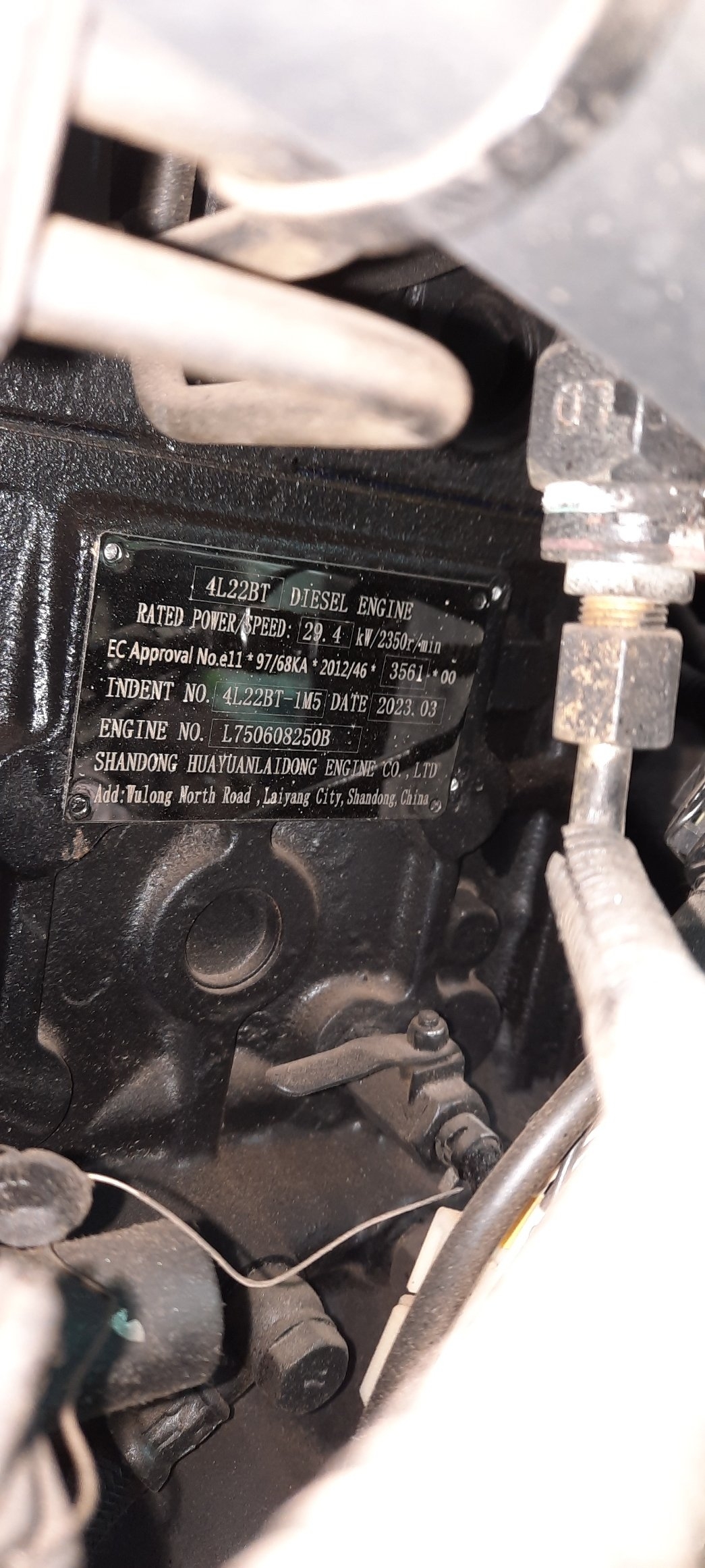

I sold Jinma tractors for several years. The higher gears are very high ratio on these tractors ie for highway. Try entering into low range high gear for better speed ie then drop to a lower gear till you find the correct one for your project. I don't have any current manuals for your tractor. Is it new? Is it 40 HP with perkins engine? I can send you what I know if it is.

Yes it´s bran new.
The engine is Chinese.
