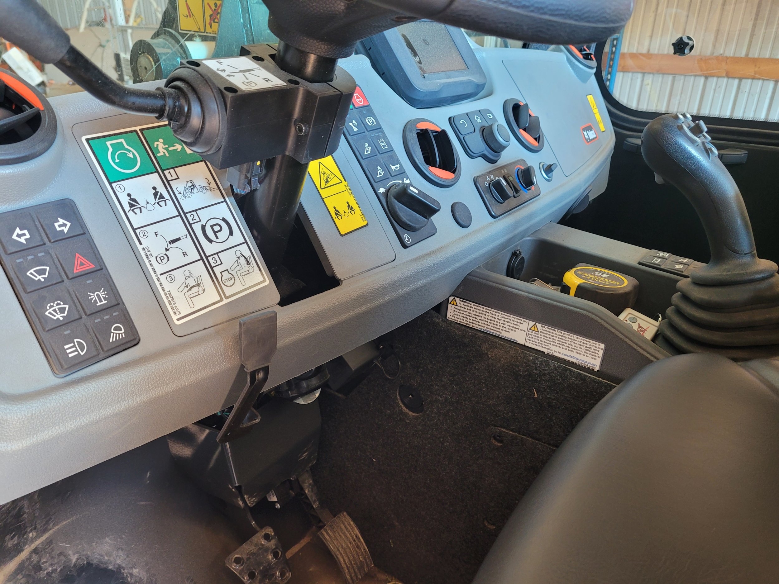

After have a 2008 Toolcat since 2009 I traded for a new 2023 in March. I just can't get used to the drivability of the 2023. There is a delay in the movement. You push the pedal and it start slow and then takes off way to fast and slows back down. Then a few time with a bucket of dirt I stop and switch from forward to reverse and the Toolcat moves forward 6 inches and then suddenly start going in reverse while only in reverse. Have others had these problems?

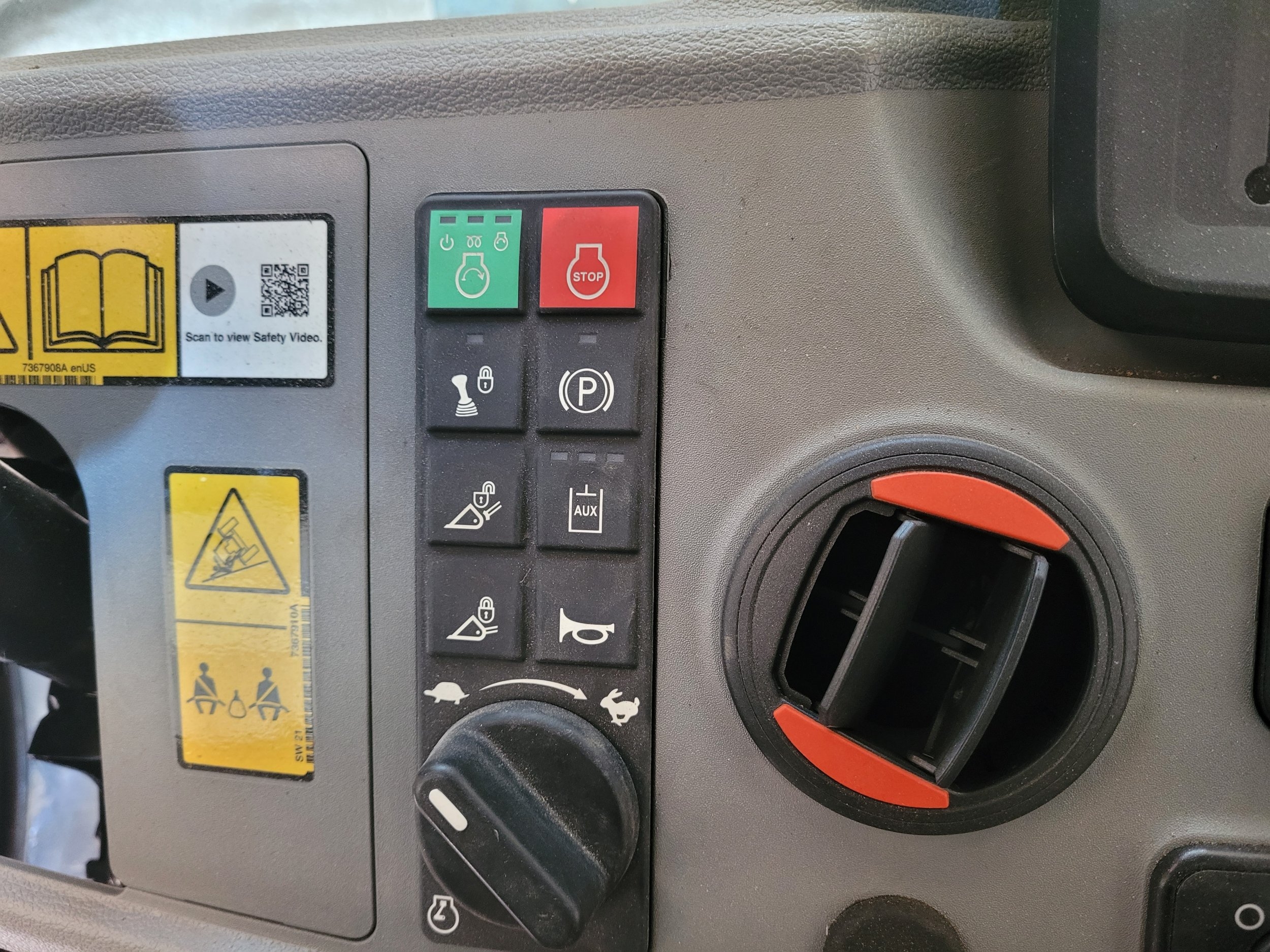

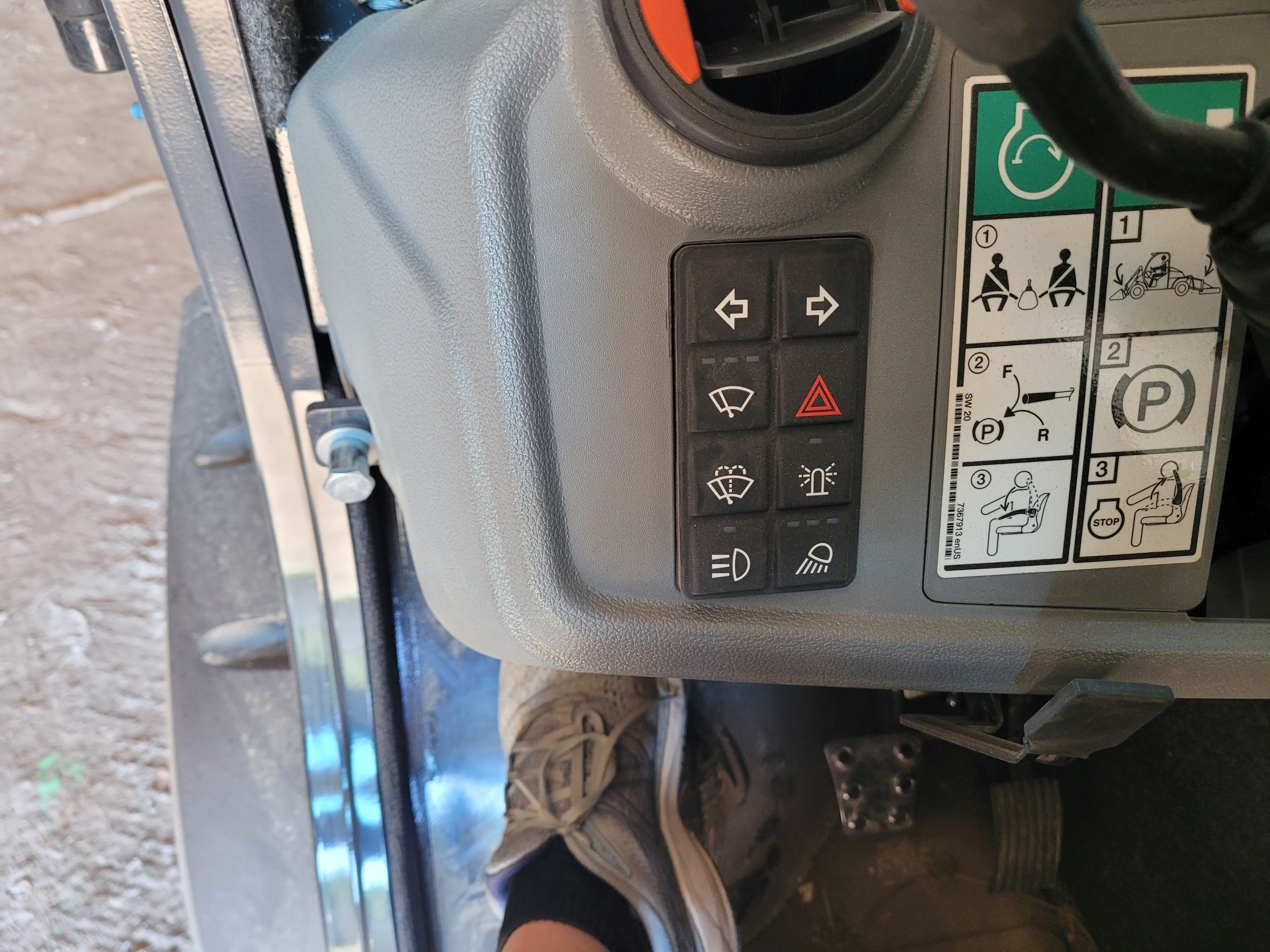

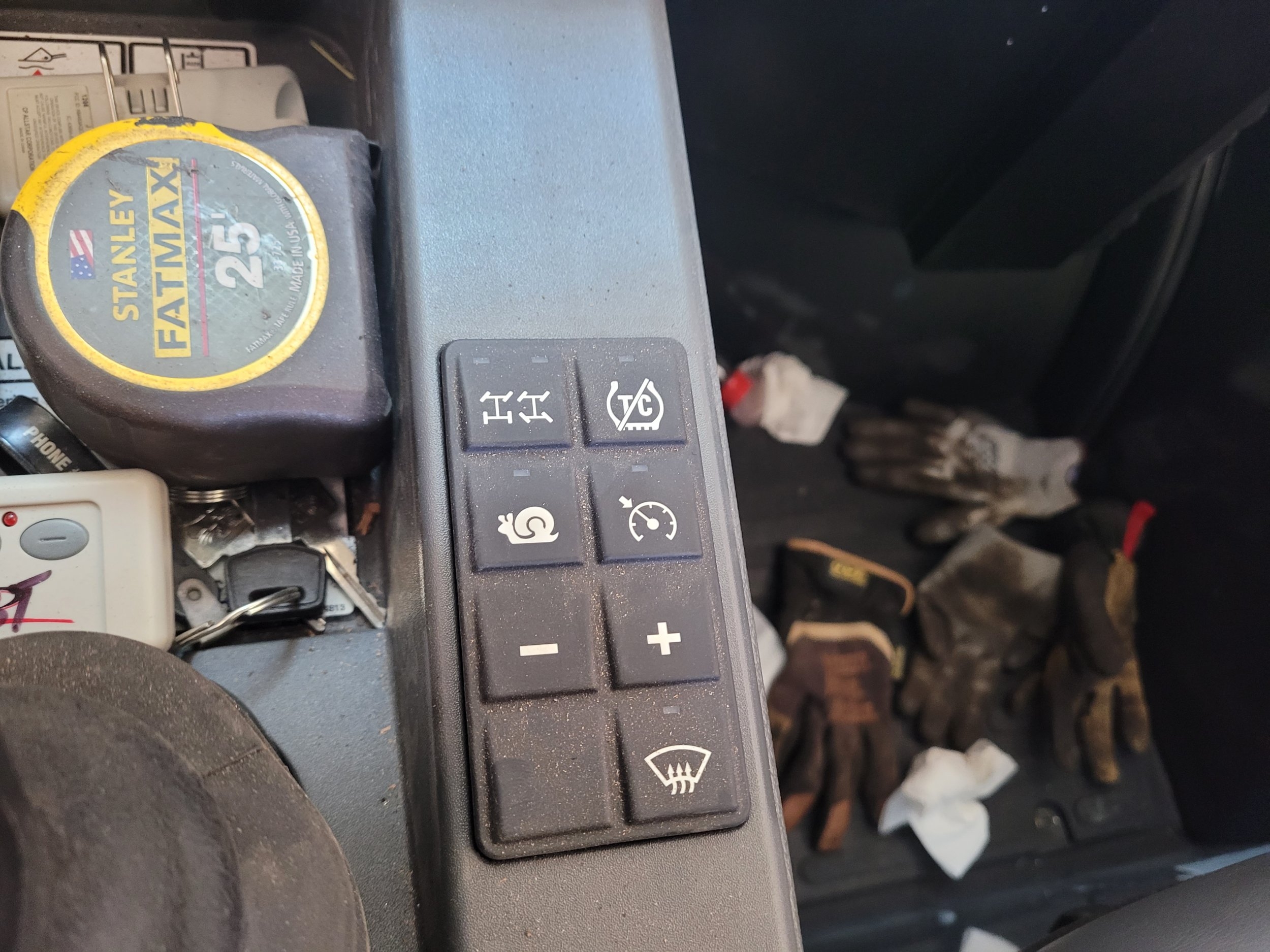

Here are pictures of the buttons. I don't see work mode. Just the snail which is variable max I do miss the turn signal level with the horn on the end of the turn signal lever.
