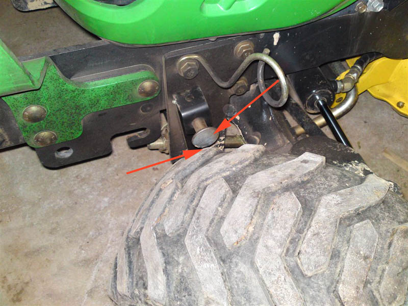

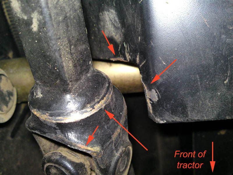

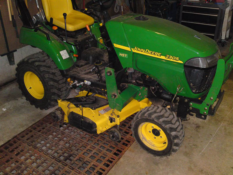

Ok, I got to the bottom of it. My PTO shaft is hitting the fan guard. Also, the front tire reaches the attaching spring pin for the front mower hanger.
The good news is that the fan blade itself isn't what is making the clicking noise, it's the PTO U-joint. When I get a chance, I'll pull the mower deck out from under and get a good look at the fan guard to see if it was somehow pulled down a little bit to cause this but it's been doing it for as long as I can remember so I don't think that will be the case.

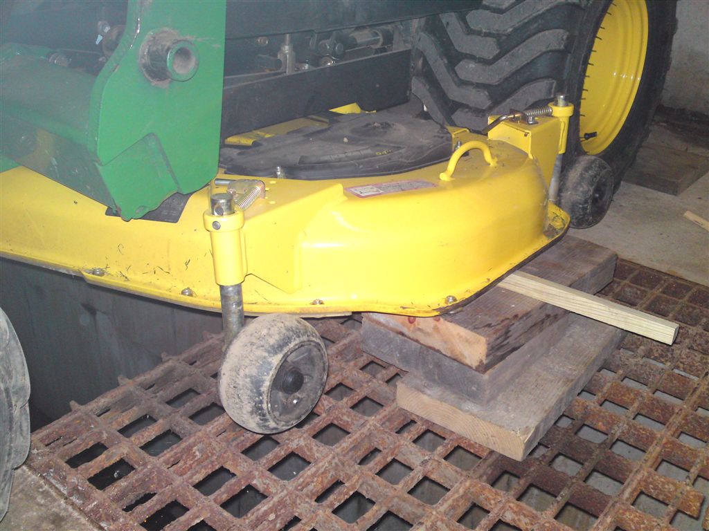

As you can see in one of the pics, I shimmed up the deck all the way on one side and then shimmed the other side as much as possible to get what was left (not shown). From below, I was able to get a real good look.
Oh, and I also checked the deck height adjustment and it was out a little, but not bad. I will be raising the gauge wheels one detent, into the 3rd hole from the top.

Your fan shroud looks just like mine. I pushed it up a little bit so it seldom hits now. You will probably find a beat up section of brake linkage just to the left a few inches. The deck can drift that far when under stress and the PTO will hit it a little.

To avoid the situation in the future, I think I'd try flipping the front tires (side to side) and getting them to a wider setting. That just may solve the contact with the front bail pin shown in the 3rd pic, and also give a wider stance to support the tractor when going through your "grade changes".
Good idea that the mower not be supporting the tractor in these situations.
