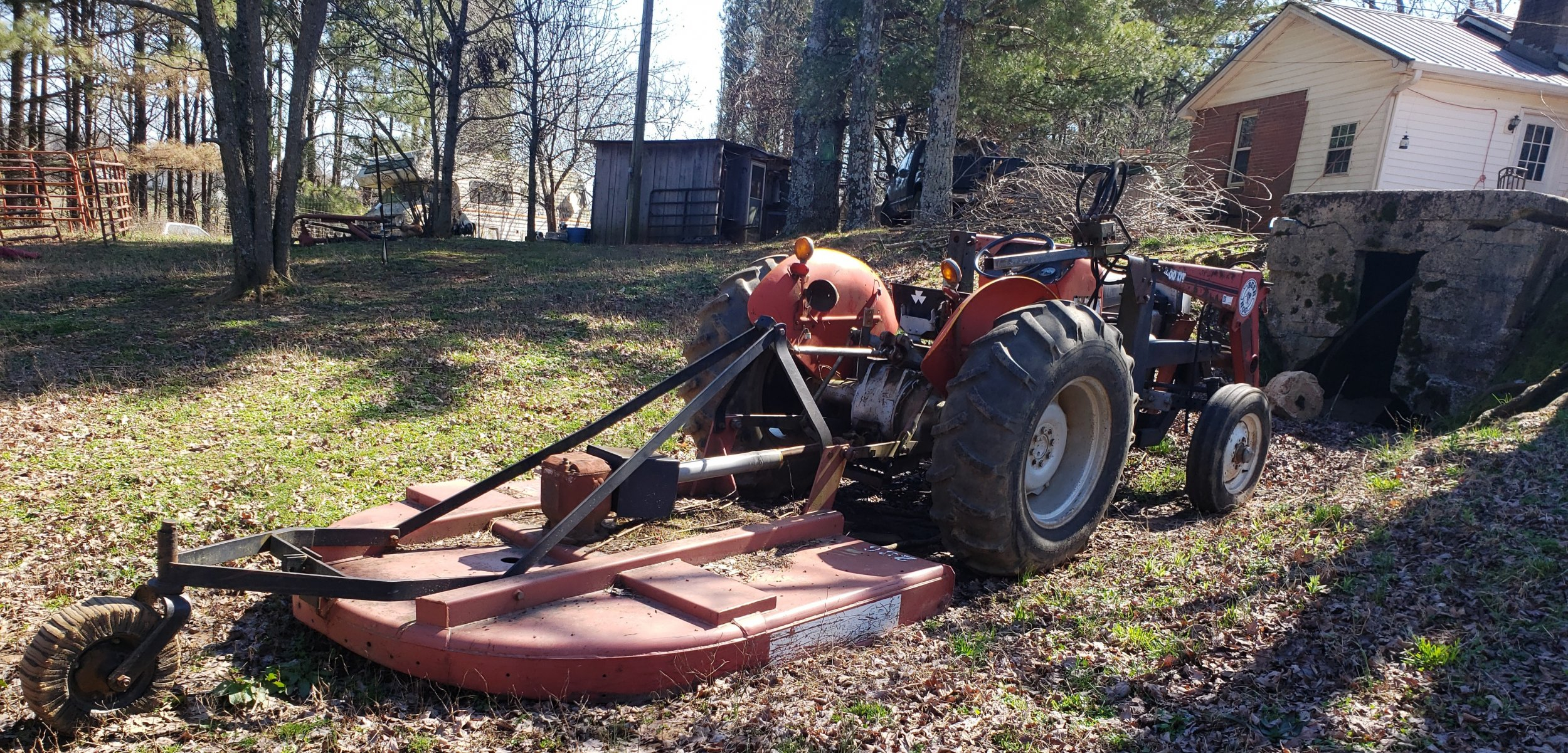

My 245 Massey Ferguson tractor suddenly has no brakes. It only had one "ify" brake all these years and now no brakes zero nada none nif. I will be repairing these brakes.
Where do I start?
