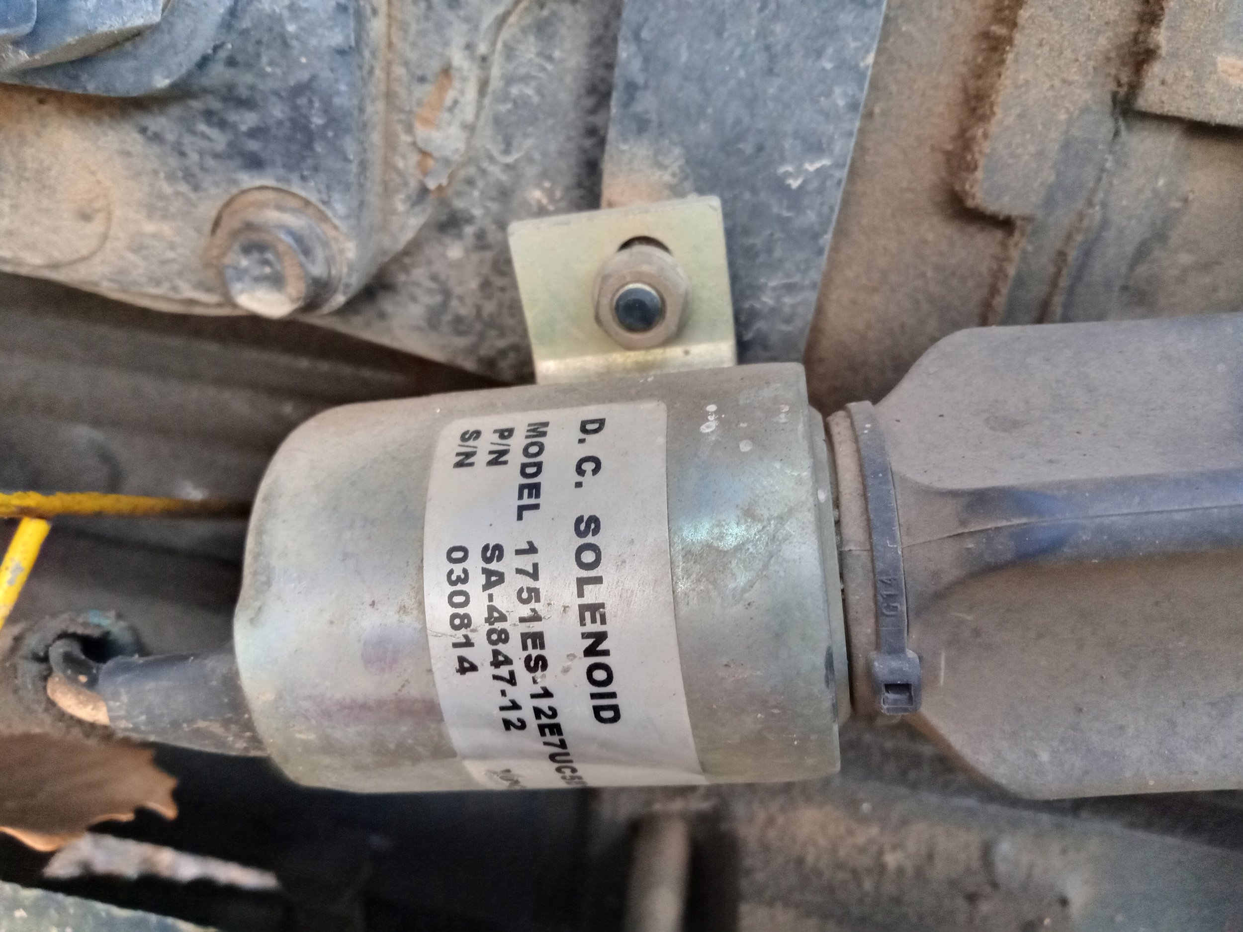

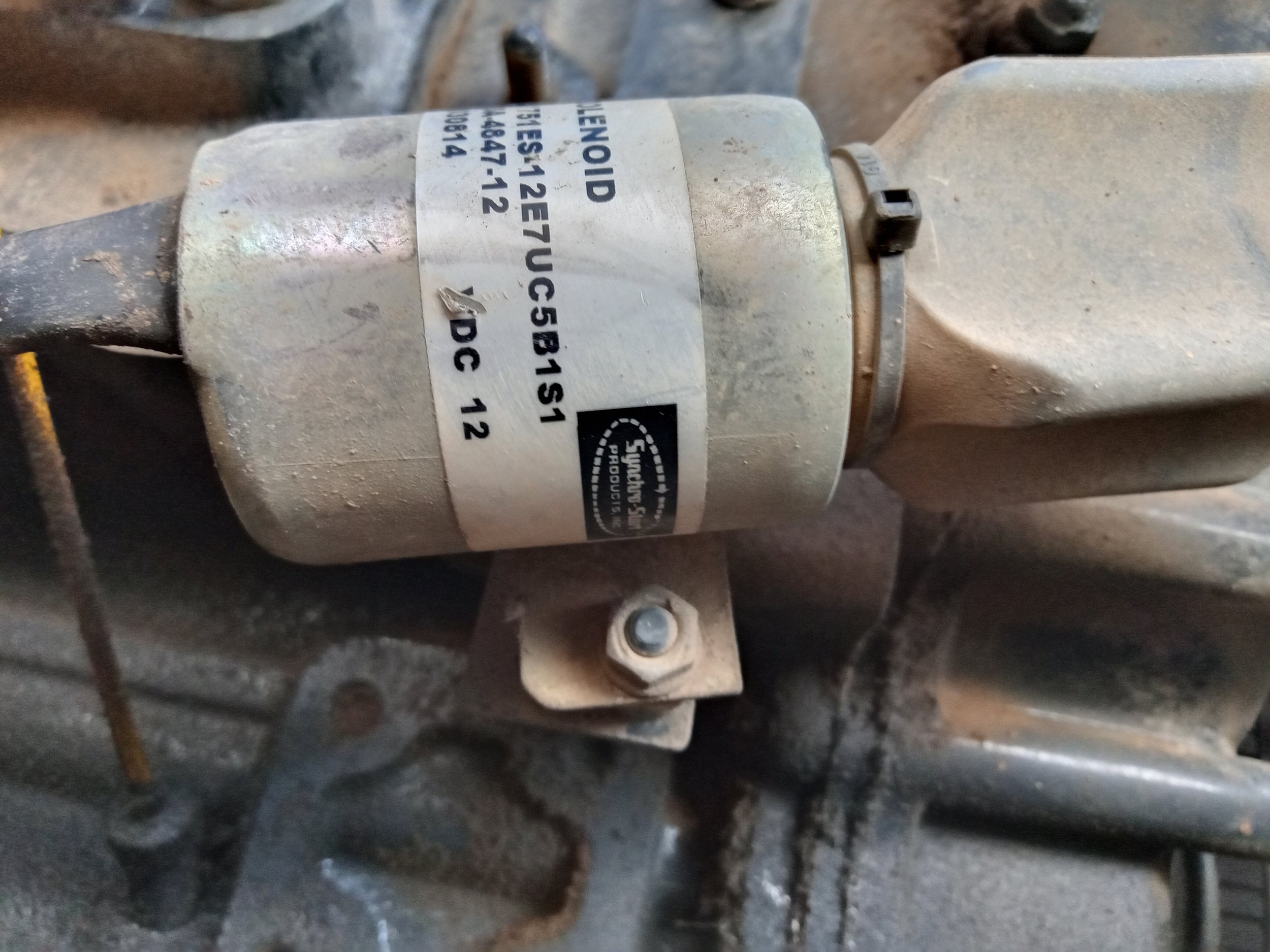

Not sure if this helps but thought I would send it. Of course a pull shut off would be an option if your up to doing that.. It would be a cheap full proof way to go..

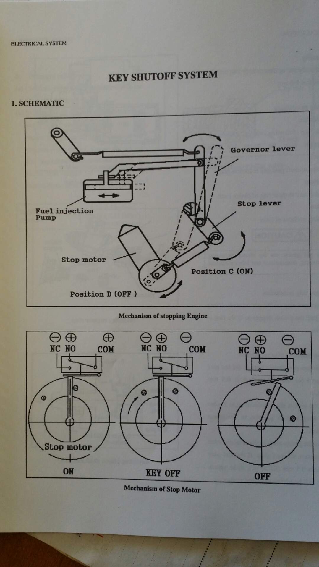

My solenoid has 3 wires, W, Blk, R
   / 2810 Fuel cutoff solenoid #10
So mine is a dual coil solenoid.
It uses two separate coil windings to allow the solenoid to be held energized for long periods of time without overheating. The first wound coil (pull coil) operates at a high current level to provide maximum pull or push. The second wound coil (hold coil) holds the plunger in place after it has completed its stroke.
[The above diagram is for general purposes. None of this information was taken from my Branson manual]
