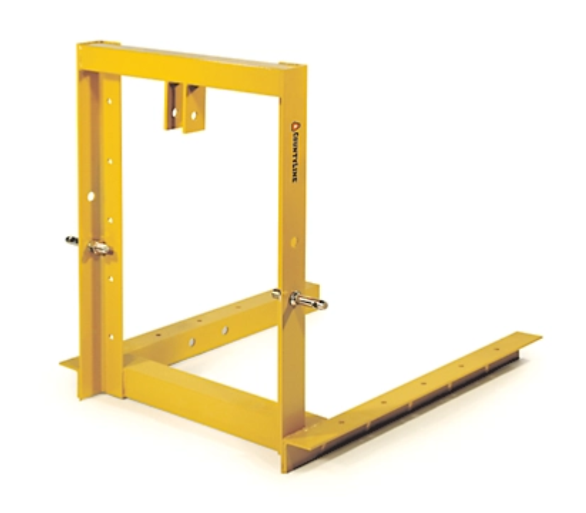

We had a new road cut and 3/4 crushed rock laid - about 500 feet and 10-15% grade. We also have another driveway (800') I maintain with my grader blade (nice crown there). Anyway, for the new road, I have used my box blade and grader to spread the crushed rock, but not ideal - doable, but I am looking for a better way. I have built pull-behind drags before (like chainlink fence gates with weight) but I don't quite get the control I like. I wired a chainlink fence gate beneath my box blade which gives me some control and it works somewhat but not a lot of visibility as I spead. I can likely get the job done, but as I have this project and other roads to tend to, I wanted a solution that gave me the following: Control (front to back, side to side tilt), and visability from the seat. So, this is what I am thinking: What if I used a carry all frame on the 3 pint hitch with, e.g., a chainlink fence gate attached beneath it. I would have the visibility I want as I drag, and also the control - pitch and side to side, and could raise and lower as necessary. I think it will work, and better than just dragging something along behind the tractor - especially when I have to turn around and reattach it for return runs. Suggestions? Issues? Alternatives?
BTW - I know that they make 3 point hitch 'drags's and am considering that, but cost is same as a carry all, and they seem less robust, and carry all has other uses.

Here is a pic of this carry all you speak.
Scootr, that is the one I am looking at. I have one already but I built it up as a true carry-all, and now call it my ranch-uber. The grandkids love it. Otherwise we use it to carry tools, chainsaws, etc. to the back country as needed. The sides and front come off but the back and bottom are bolted on so can't reall use it as my 'drag'.
