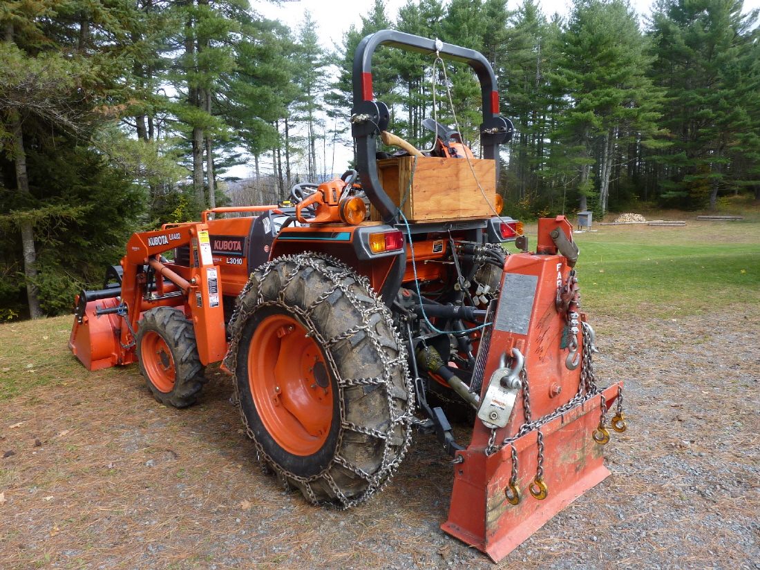

Apparently you guys are fortunate enough to be able to get right to the logs? In my hilly terrain, I can't do that so I need a winch to get the logs close. I had an old box blade that I mounted a HF winch to. It's slow, but it does retrieve the off-trail logs. I added several grab hooks on the box blade for actual pulling, and a chain box for storage. I can drop the box blade to help hold the tractor when pulling.

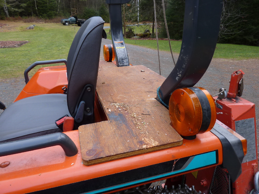

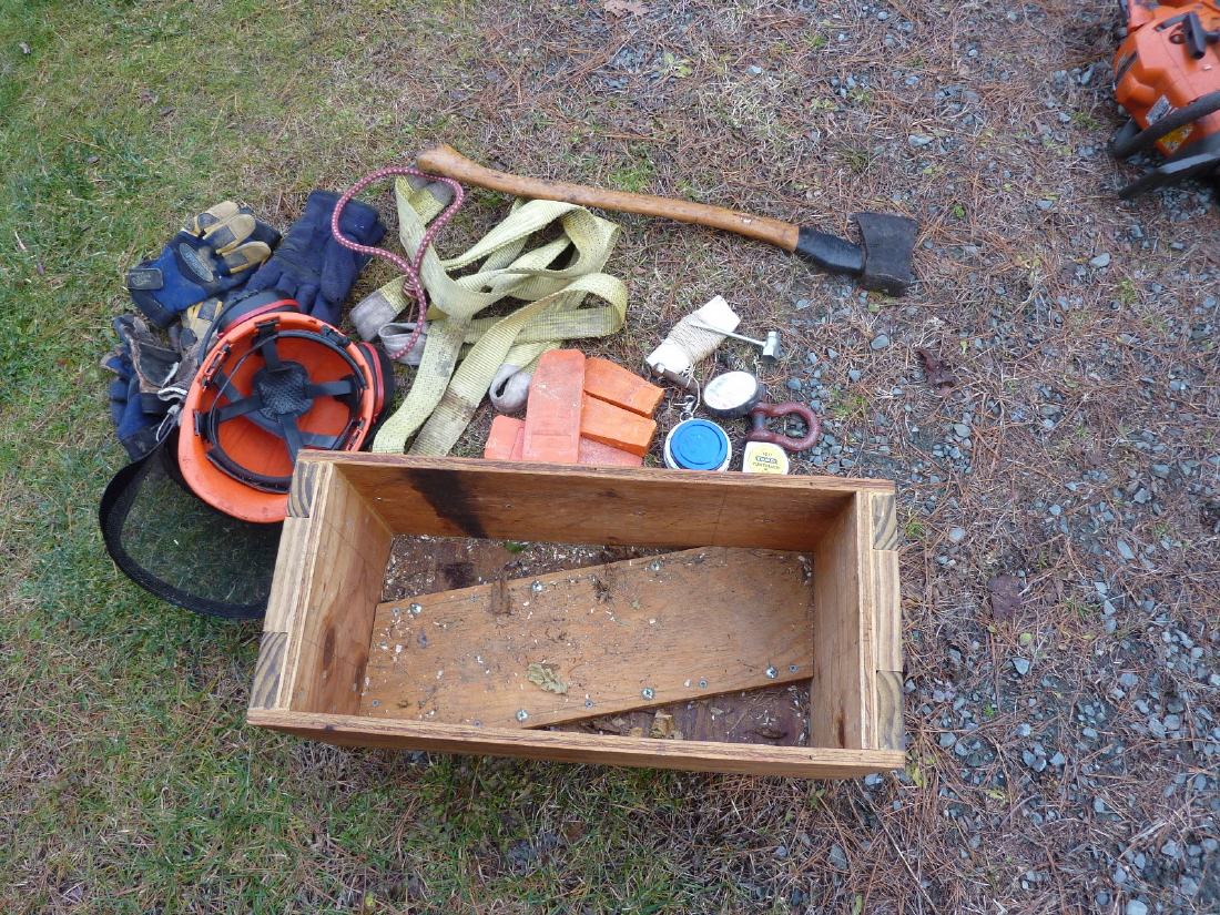

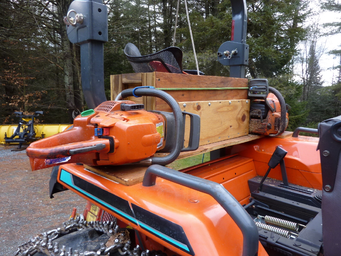

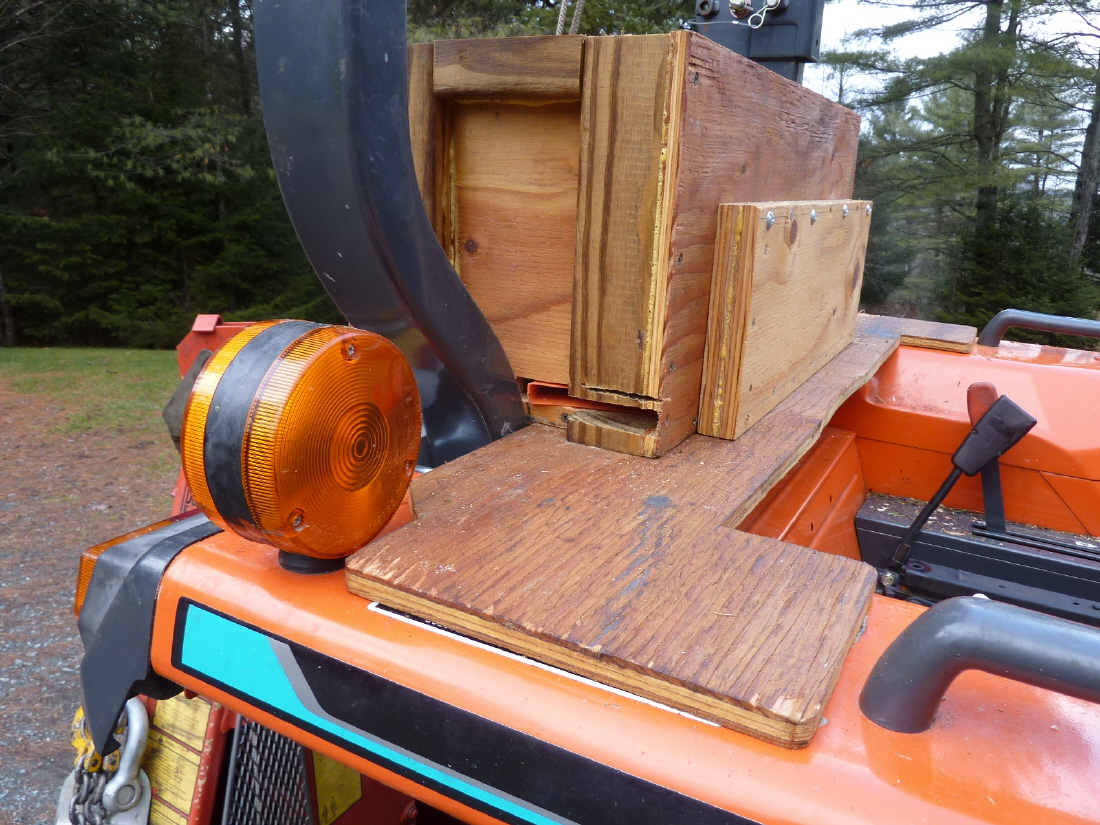

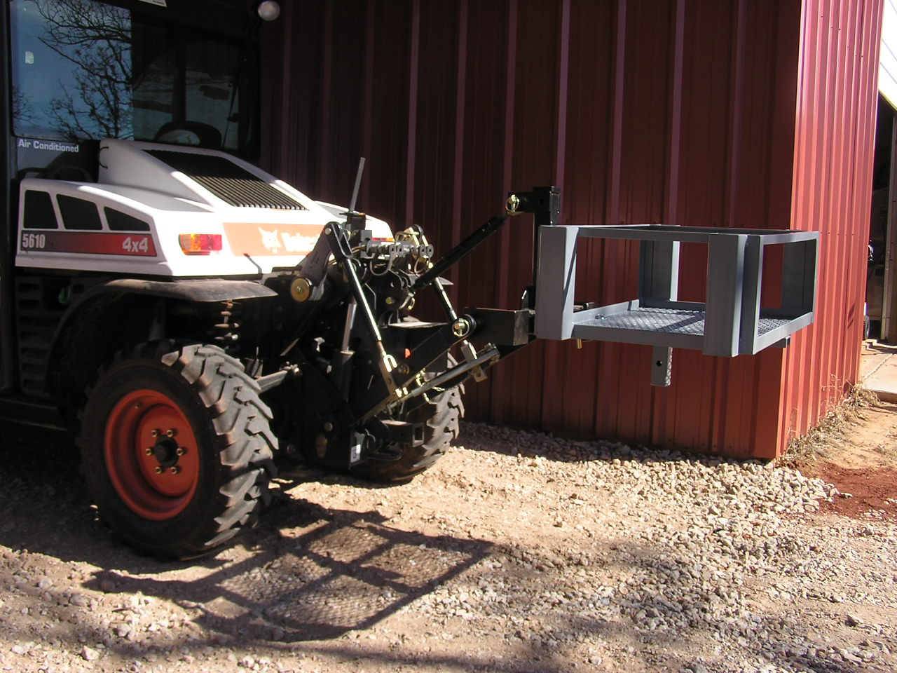

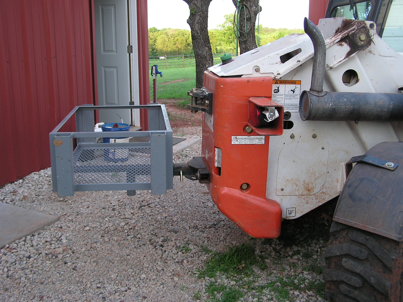

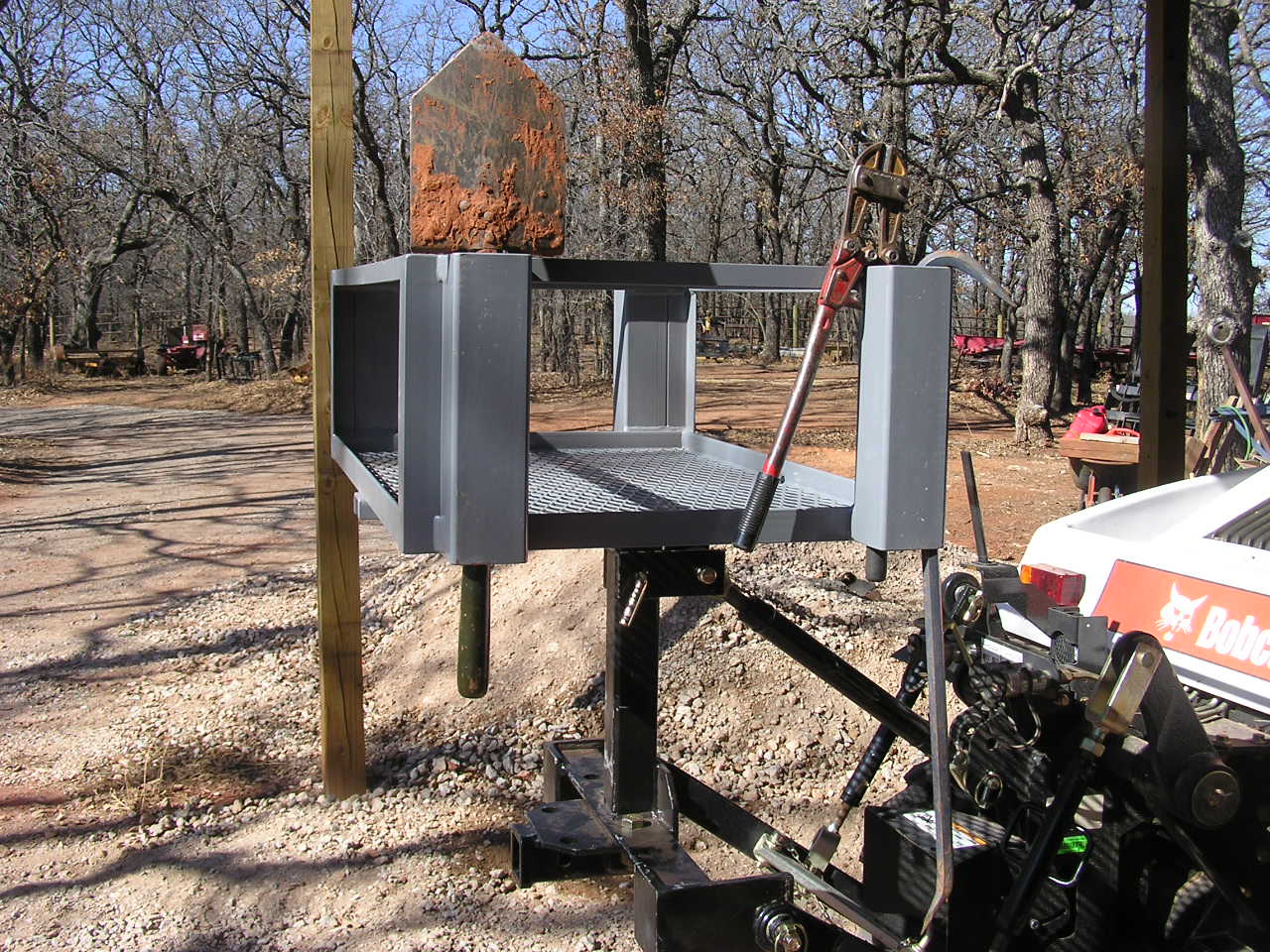

I built a box like this. All removable without using tools. I have a winch so chains go on that. You could make a slotted bar to hold chains like on the winch.

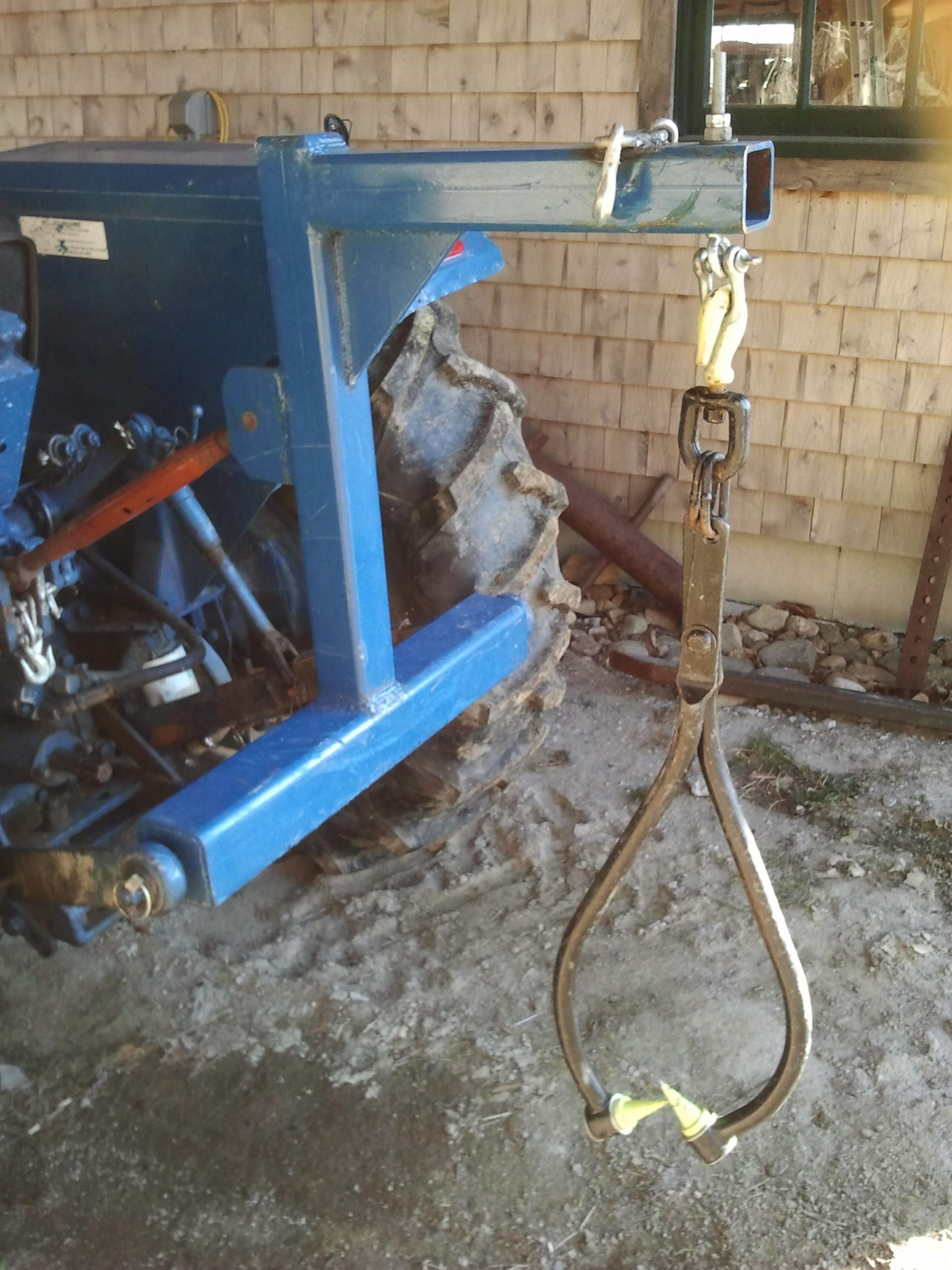

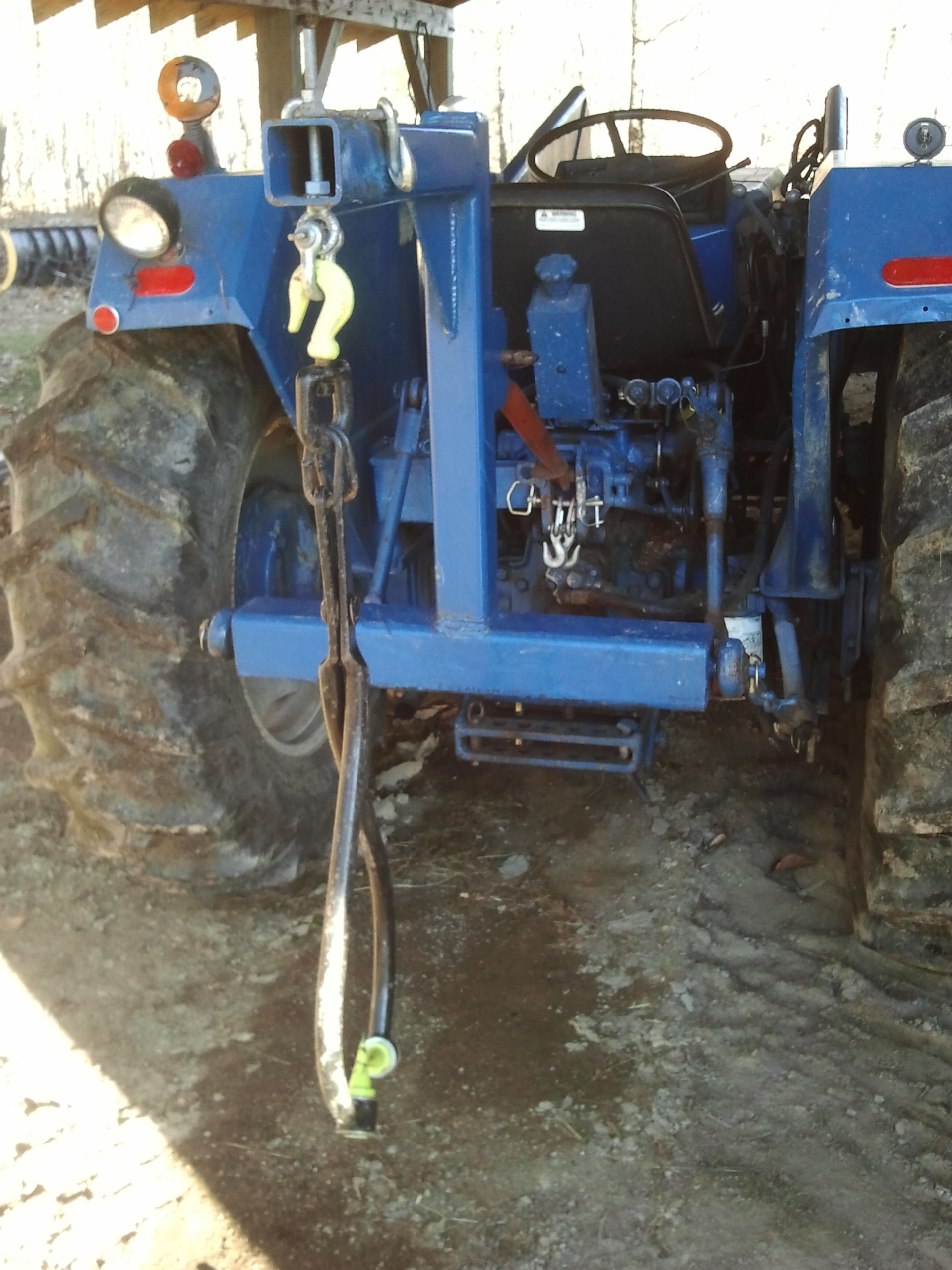

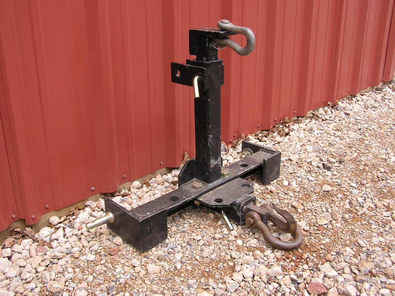

Here's one I made. very similar to the OP's design. I opted for log tongs and a couple of grab hooks for chokers, but basically the same. Works great!
   / 3 Point Log Skidder #29

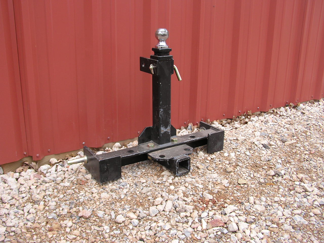

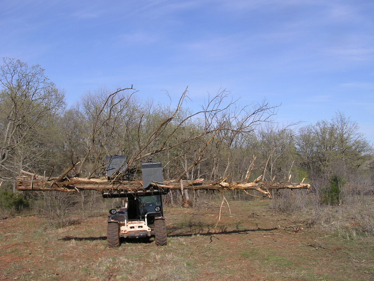

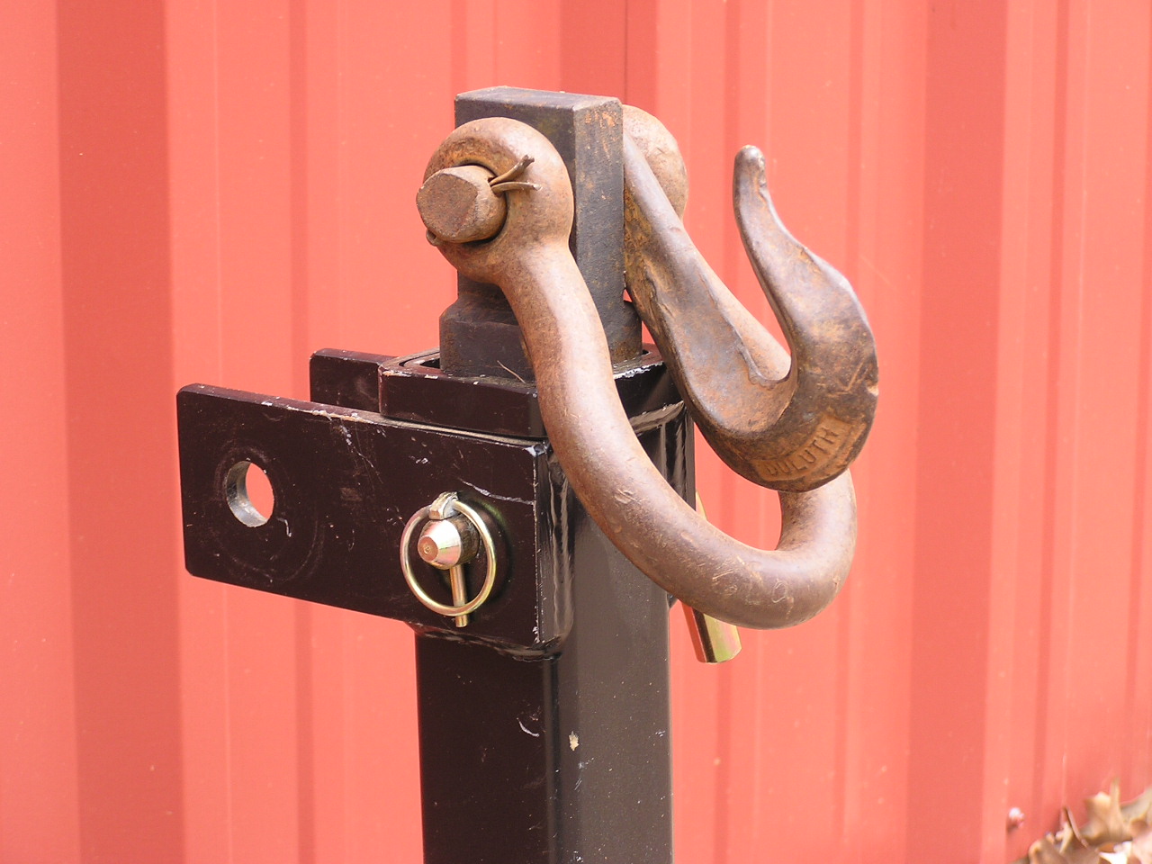

Here is a combination receiver hitch/short boom poll that I have used to skid logs with...
I use it for a multi purpose tool platform....
I lift the log with the 3pt, short boom.... But pull with a second chain on the draw bar...
To pull from 3pt is too high compared to the center height of the rear axle....
Keep safe...

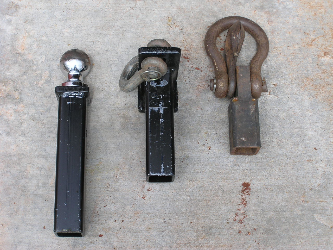

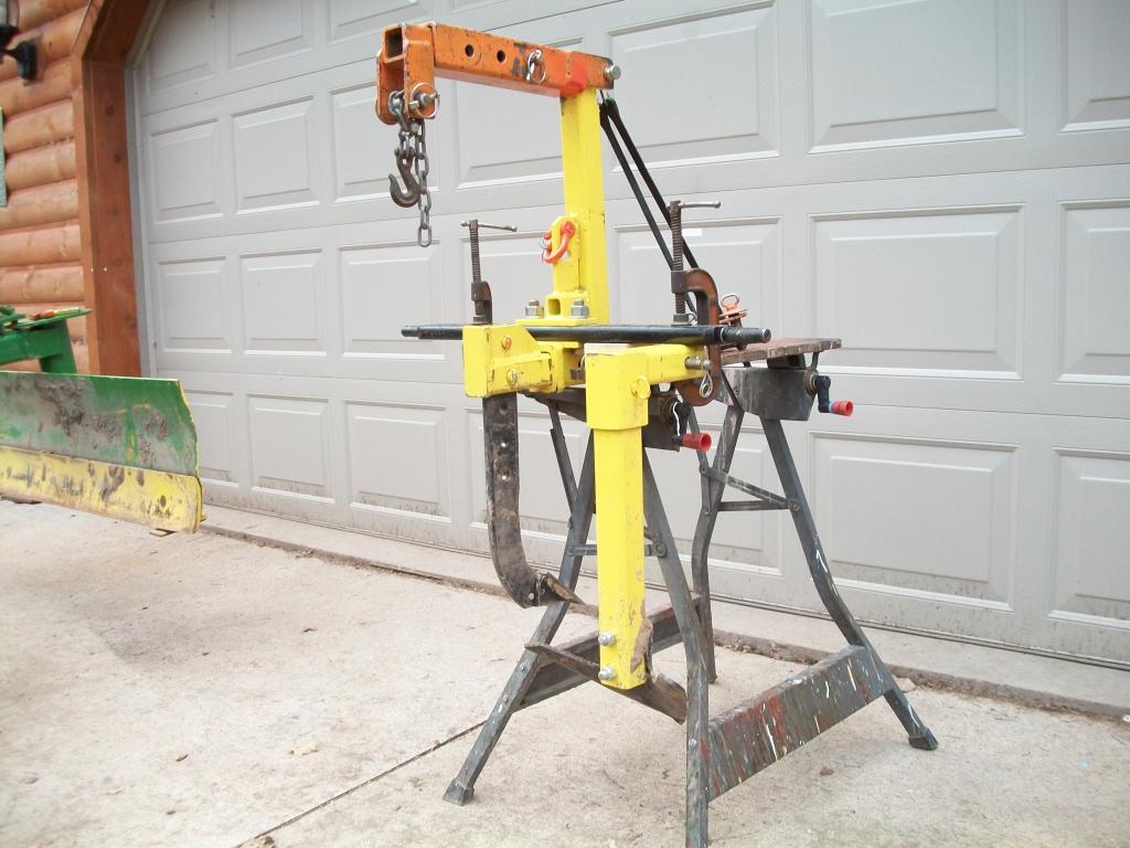

I got a large portion of my project done today using some shop-floor materials and my original spacer-bar n pins. I didn't have any 2X2 tubing for the mast that will most likely have a short boom. Looking at welding the mast on top of the spacer-bar and running it up under the horizontal tab below the connecting link; then gusset a boom outwards.
I bought the hitch receiver in town for $11.
I found some nice 3 point hitches on-line for $70-$300, but I wanted to make this myself.
I'm always looking for ways to stay upright when working so being able to detach the chokers at waist-level would be great.
View attachment 355503View attachment 355502
The last bit of decision-making is to use a 36" floating boom that attaches to the draw-bar, floats on the spacer-bar, and passes through the base of the mast; we shall see if I can find a 3" "I" beam or rectangle.
