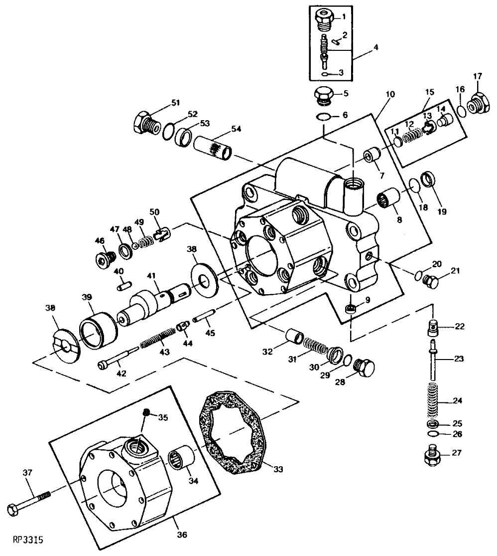

Just purchased a 300 backhoe. 3cyl gas. When starting the tractor,it will crank over fine then it acts like the hydraulic pressure builds, then the engine cranks very slow.The only way I can (sometimes) get it to start is to move the steering wheel left to right while cranking. If it does get started the steering column gets hot in a short amount of time. Could anyone recommend what I need to look for. Thank you for your help.
   / 300 (1020) backhoe hydraulic problem Please help. #2
Hot hyd function indicates high pressure internal leak. Leak needs repaired as heat destroys hyd components including but not limited to seals/o-rings. Pull out LH frt screen in frt of radiator and see if your tractor has a hyd destroking screw(parts key #4)? Destroking screw is designed to be turned down to shut pump from pumping oil while starting engine. Then after engine starts turn screw CCW so pump can pump oil.
